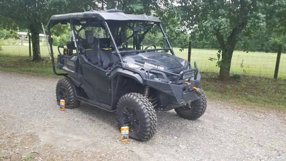

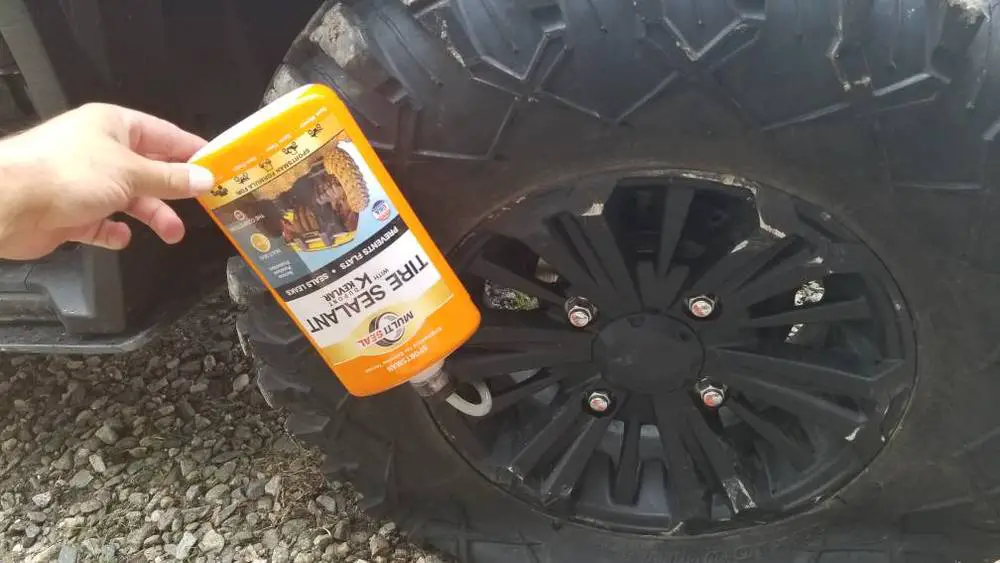

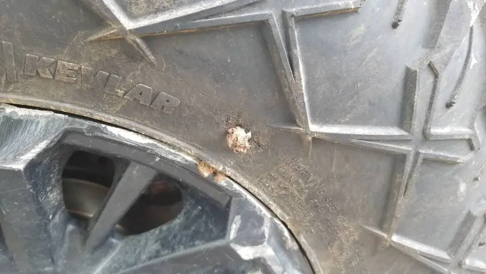

Test #1.
Takes about a week to leak down to the level shown.
I put 3/4 of a bottle in all 4 tires. Then did about 1 mile of ride time.

Test #1.
View attachment 135033View attachment 135034View attachment 135035View attachment 135036
You might need to pull the wheel and lay it on it's face overnight for the sealant to work it's way around the repair. If you are feeling lazy, park the machine with the plug at the lowest point, then when it loses air, the plug will sit in the puddle of sealant hopefully sealing it.
If this works for you, I might try to save the Terrabites on mine with this stuff.
