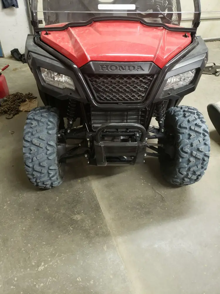

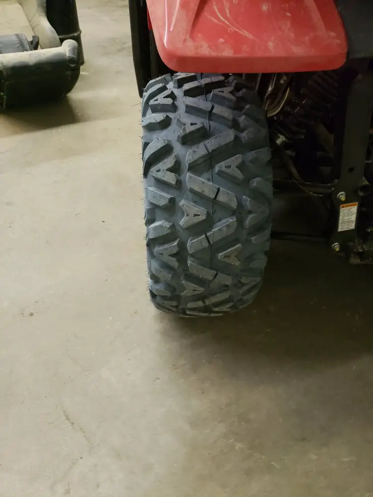

Here's the sad truth. Here's pics of my tires. Somehow had it in my head they were ripsaw clones. Actually, they are bighorn clones. Will probably just wear them out and get some Bear claws. Got them on my Grizzly and they're awesome!

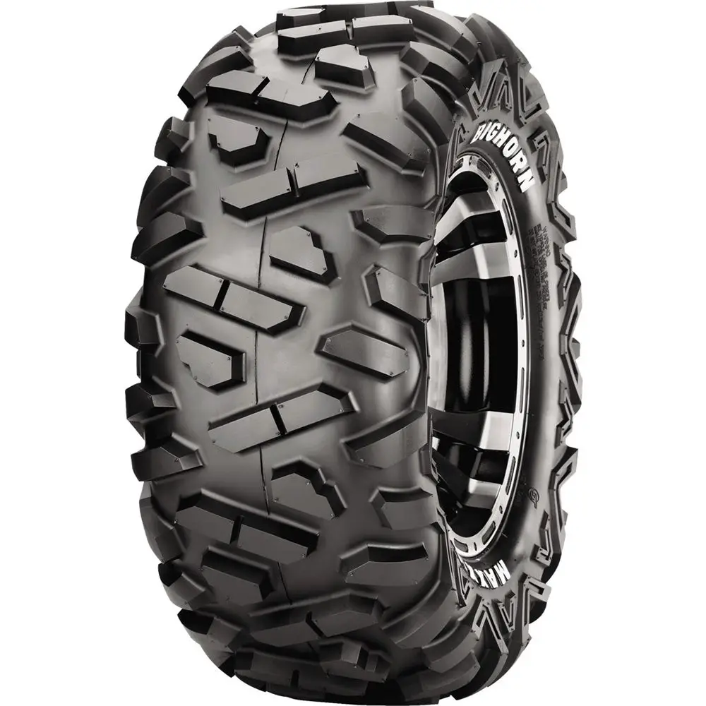

This is the original Big Horn...
