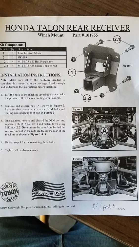

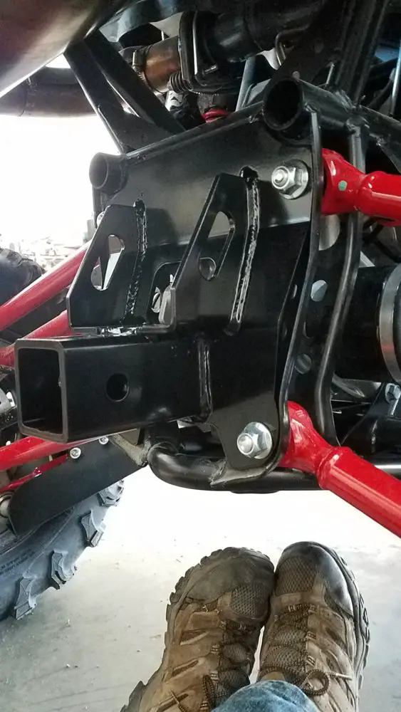

Mounted in fifteen minutes. 70 bucks included new bolts and nuts.
That looks like the ticket! Unfortunately, I've already got the Honda accessory steel rear bumper mounted back there. By all appearances, it looks like the hitch would not accommodate the bumper. However, I believe with a bit of metal removal, thereby allowing the lower support arms of the bumper to pass through the hitch plate, it might be possible. Don't know how much it would compromise the strength of the receiver hitch though. Think I'll give them a call tomorrow and chat it up with them.

Hey thanks man, this really helped me out. I put my name on the list. They are currently out of them but hope to have them in and shipped in June. Also, the website has been updated. The Part # is 101755

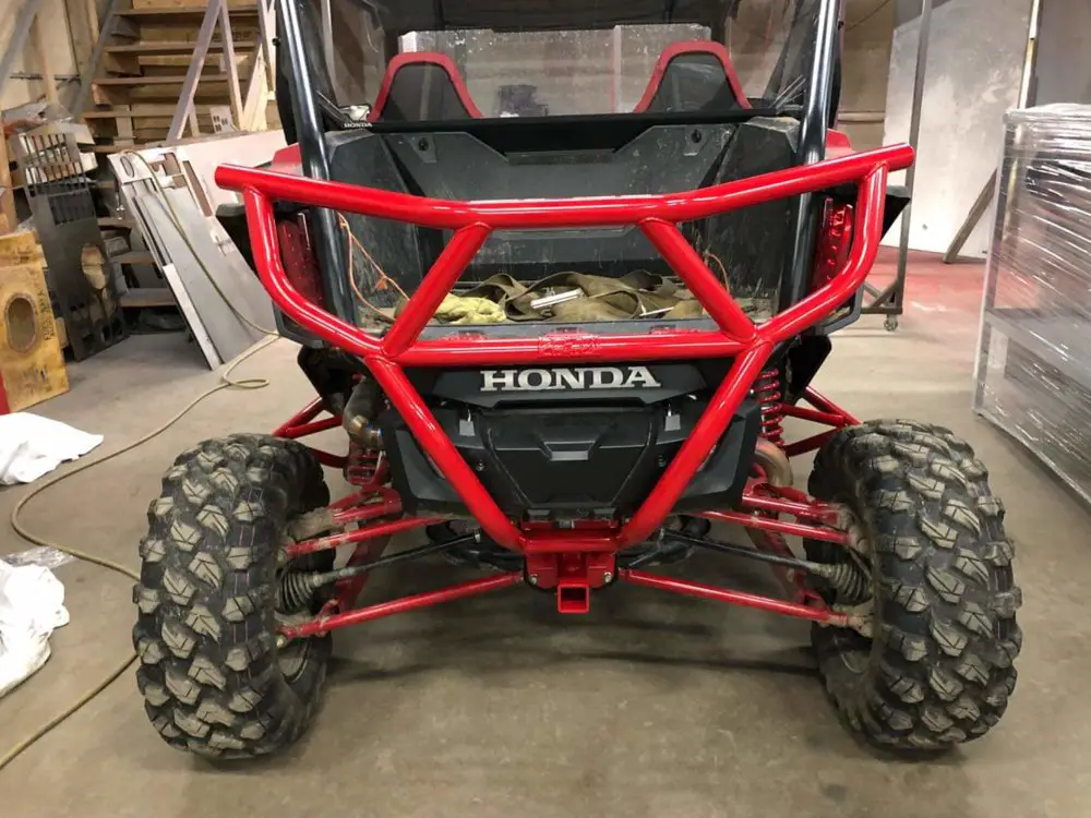

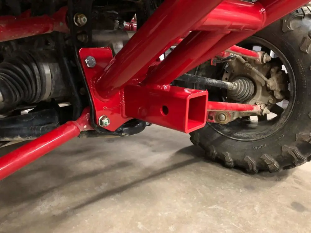

Right from their website. Not the clearest pics but you can see the hitch looks like it is placed first, then the bumper. BUT only their bumper looks like it will work with their hitch...

That part does it all! Bumper, cargo corral, and receiver, sweet!
