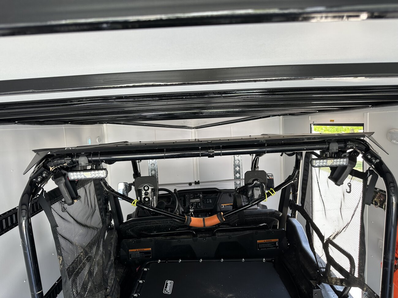

I think my machine height measurement with the Honda plastic roof was 76”-ish (easy enough to measure yours as it sits). But if you add bigger tires you might need more so going to 79-80” should prevent you from having issues down the road with changes.
Agreed. If i were in the market for a new trailer it would be 84"
Had to let air out of the stock tires to load a P1k-6 in a trailer that measures 77" floor to ceiling. It was really tight when going up the ramp. No chance of it fitting with the Honda roof and 28" tires that are now on it.
edit to add...it had to be tied down by the frame to keep it from bouncing around. Using tire straps with that tight of a clearance would be risky.

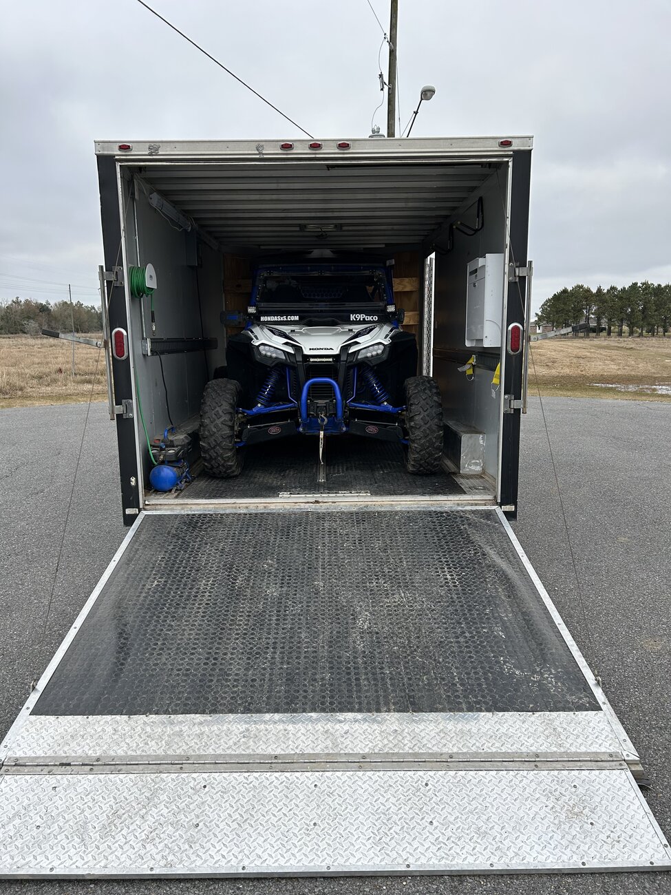

20 foot Pace Outback - Tandem
8'- 6' wide 81" rear door
Fortunately, I have a public scale nearby where I spent a couple hours figuring out tongue weight, sweet spots. 1 machine and cargo tie down, then 2 machines with cargo. I tow with a 98 Cummins 1 ton, which takes a lot of front trailer weight for the 10 to 15% rule.
I also added an equalizer hitch with dual sway control.
Pulls great!
