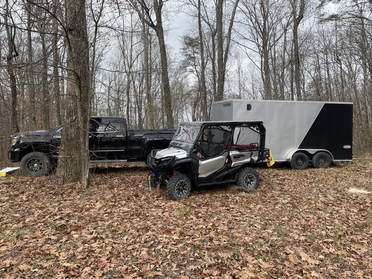

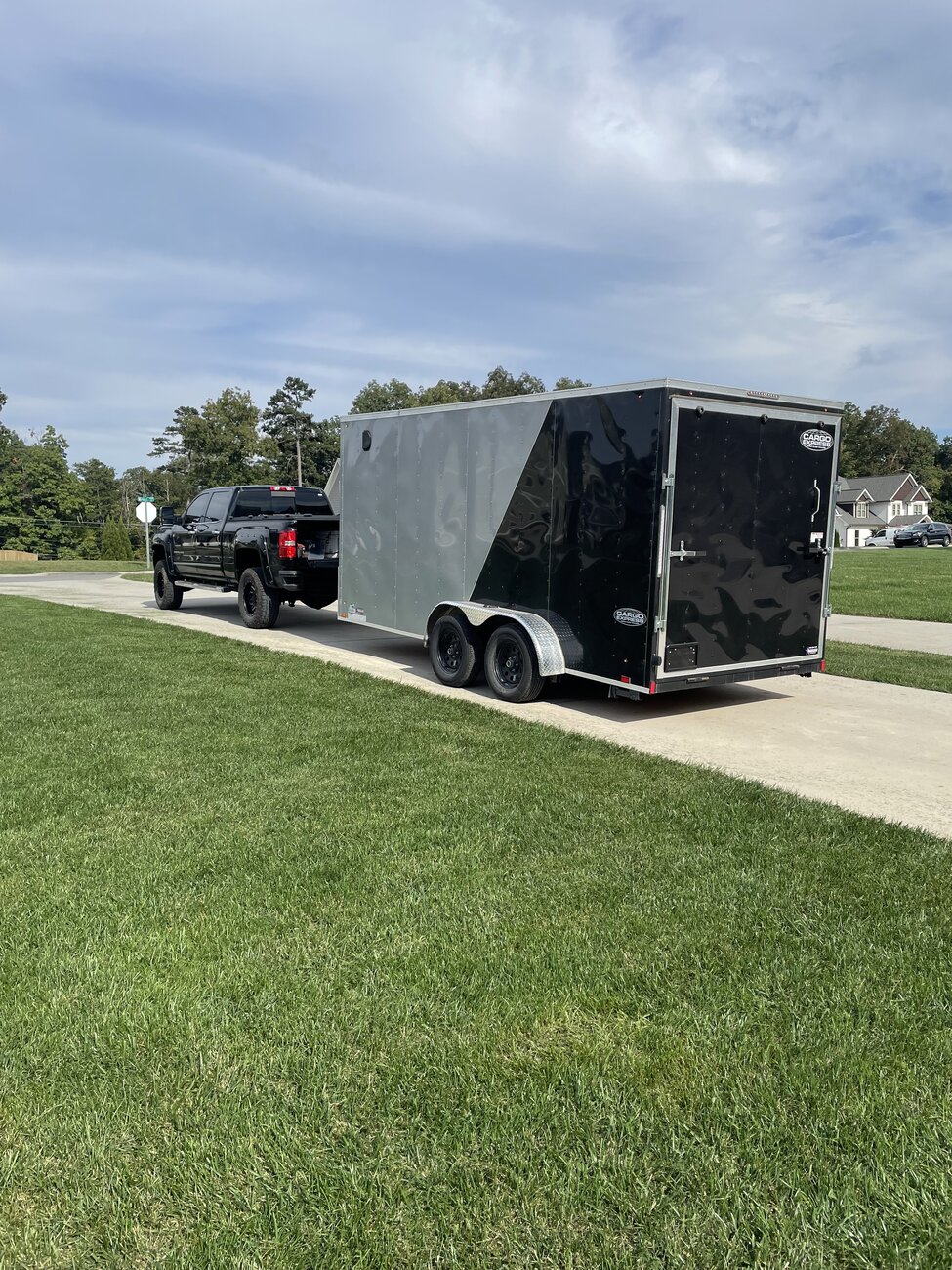

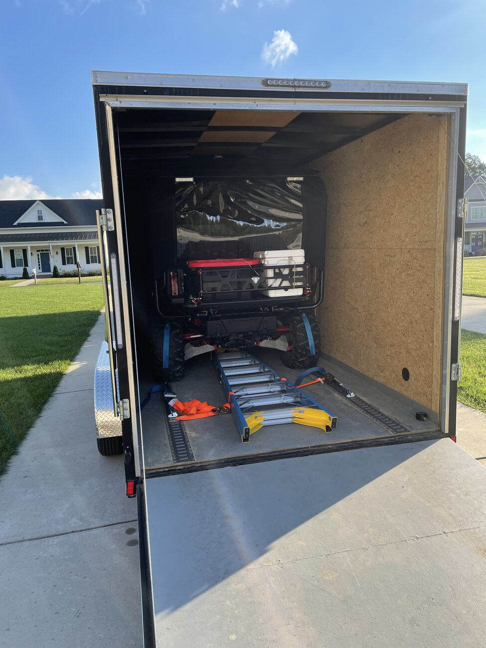

@Jason W I’m probably going to end up selling my enclosed that I used to haul around my P1K5…. as the new Talon doesn’t fit. I’ll get specs and pictures if you are interested
@Jason W As many details as I could find..
2021 7x16 v-nose tandem spring 3500lb axles (gvwr is 7000). It’s a Cargo Express and has e-tracks installed. Painted floor. RV door with latch

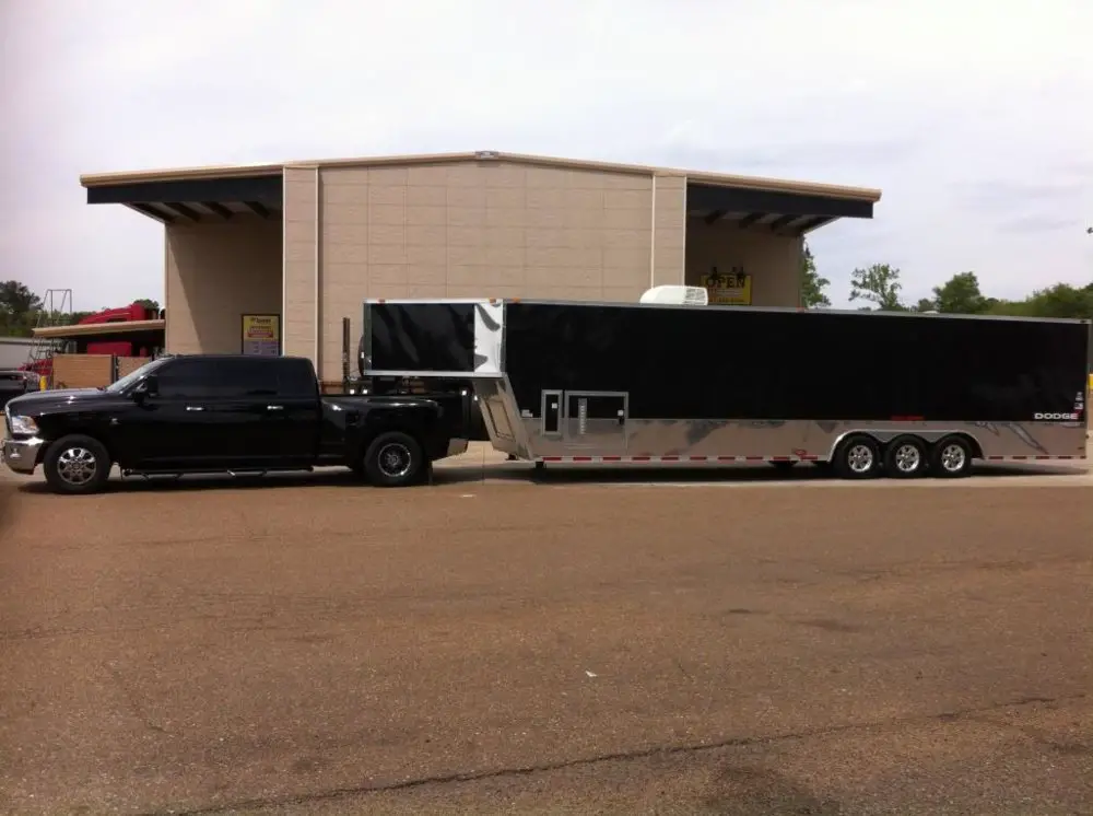

Is there a particular brand of rv rooftop that is better, or ones to avoid, are they all 220 or 120v
I had 1 ,110V,15,000 BTU Coleman on this trailer and in the hot, hot summer it would barely keep up. However it was all black and 36’X 102” wide and 84” tall. On a trailer around 24’ long it would be plenty.
