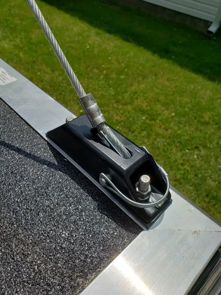

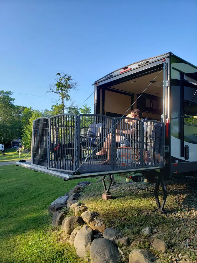

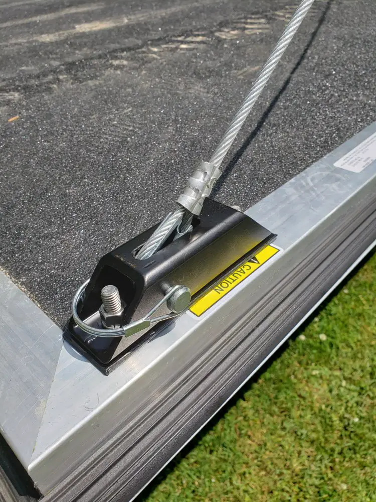

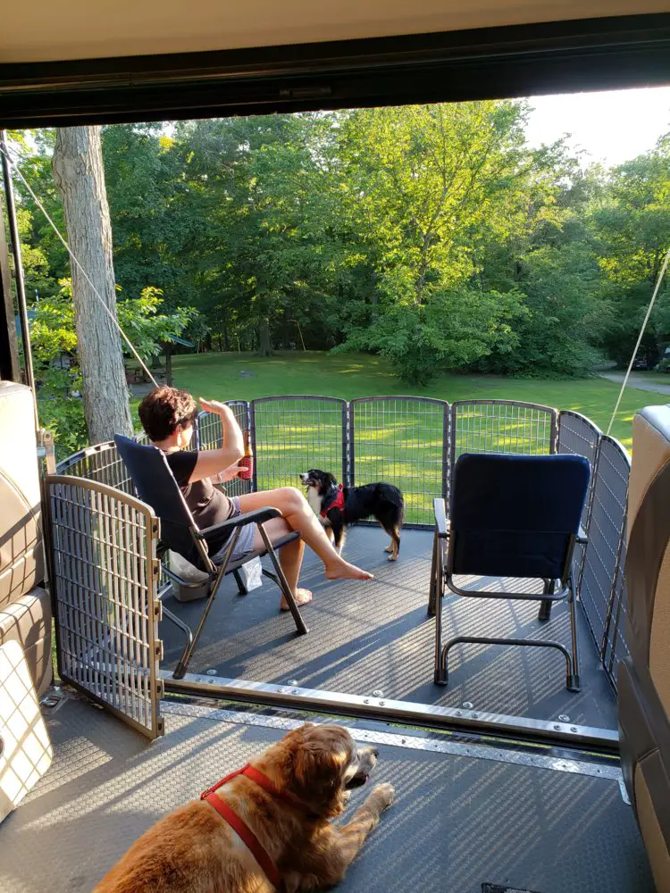

Finally finished installing the cables for the doggy patio on the toyhauler. Back in post 228 I was asking about a cable kit , well I purchased it and as @Neohio mentioned, the brackets and screws are junk.
I made up some brackets of my own and used SS bolts along with a SS backing plate on the outside. I sandwiched a piece of plastic (from my old OEM skid plates) between the aluminum and SS plate to keep the aluminum from corroding (aluminum and SS don't get along).
I ended up not using the turnbuckles, it made the cables to long!
