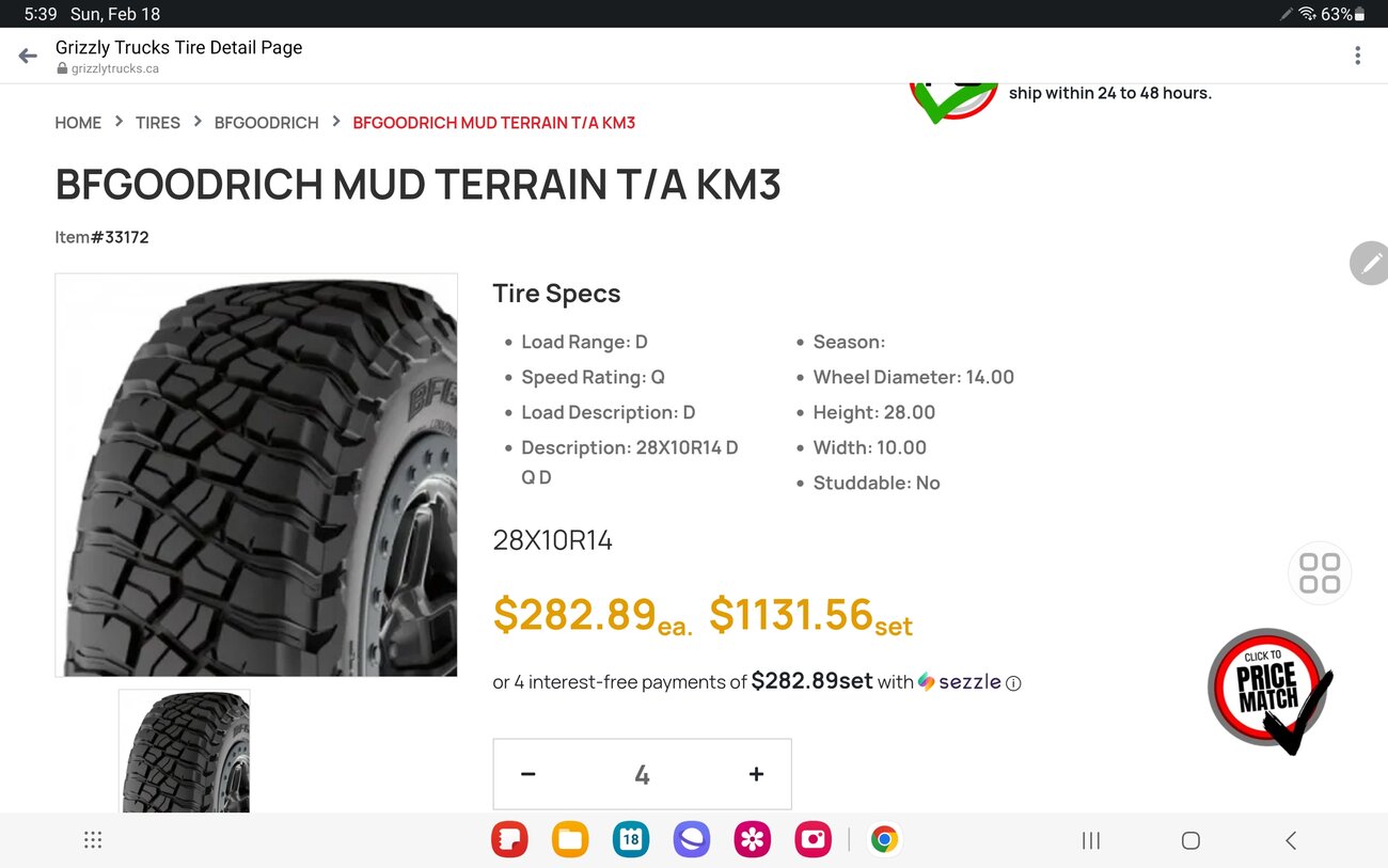

Hey
Anyone every use 14" truck tires on sxs . Was thinking about trying bf goodrich truck tires

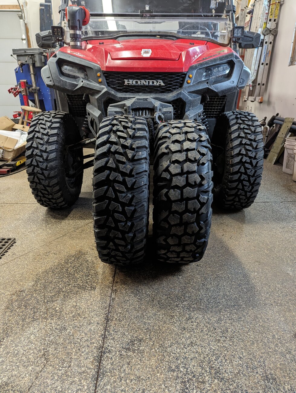

I went with the GBC Parallax because they have an all terrain tread and a 10 ply sidewall with a UTV weight rating. At 10 PSI they look good and drive nice. I'm looking forward to getting them in the dirt. They are a 31x10x15 so they might be a bit big for most but they start at a 29" which would likely fit a stock machine or machine with offset front arms. Shown below are the new 31s vs my old 30s. I was really searching for a lighter tire and these came out to be about 8lbs lighter than my previous setup at 55lbs per corner

What lift and arms do you use and how well does it clear the 31?

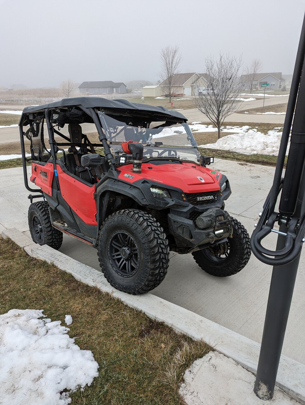

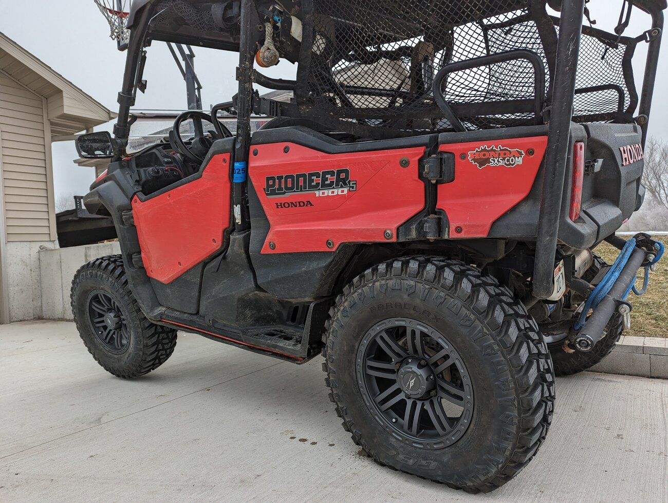

Superatv arms front and rear with Stage 4 Elkas. The front should be fine with the grill trimmed under the headlights. The rear will likely still rub the rear cage support and under the doors. With 2 guys up front I did alright with 30s. And I'm only a little bigger now. The lighter and softer sidewall 31s seem like a good compromise. Old tires were 30x9.5r14 EFX motovators. New are 31x10.5r15 GBC parallax. I'm pretty much coil bound and into to bumper on the front shocks as shown. In the rear I have about 1/2" before the bumper. I've been alright with the rear rub the las few years. The soft ride with worth a little scrub vs a stiffer spring and taller jounce bumper

Awesome. It looks great!

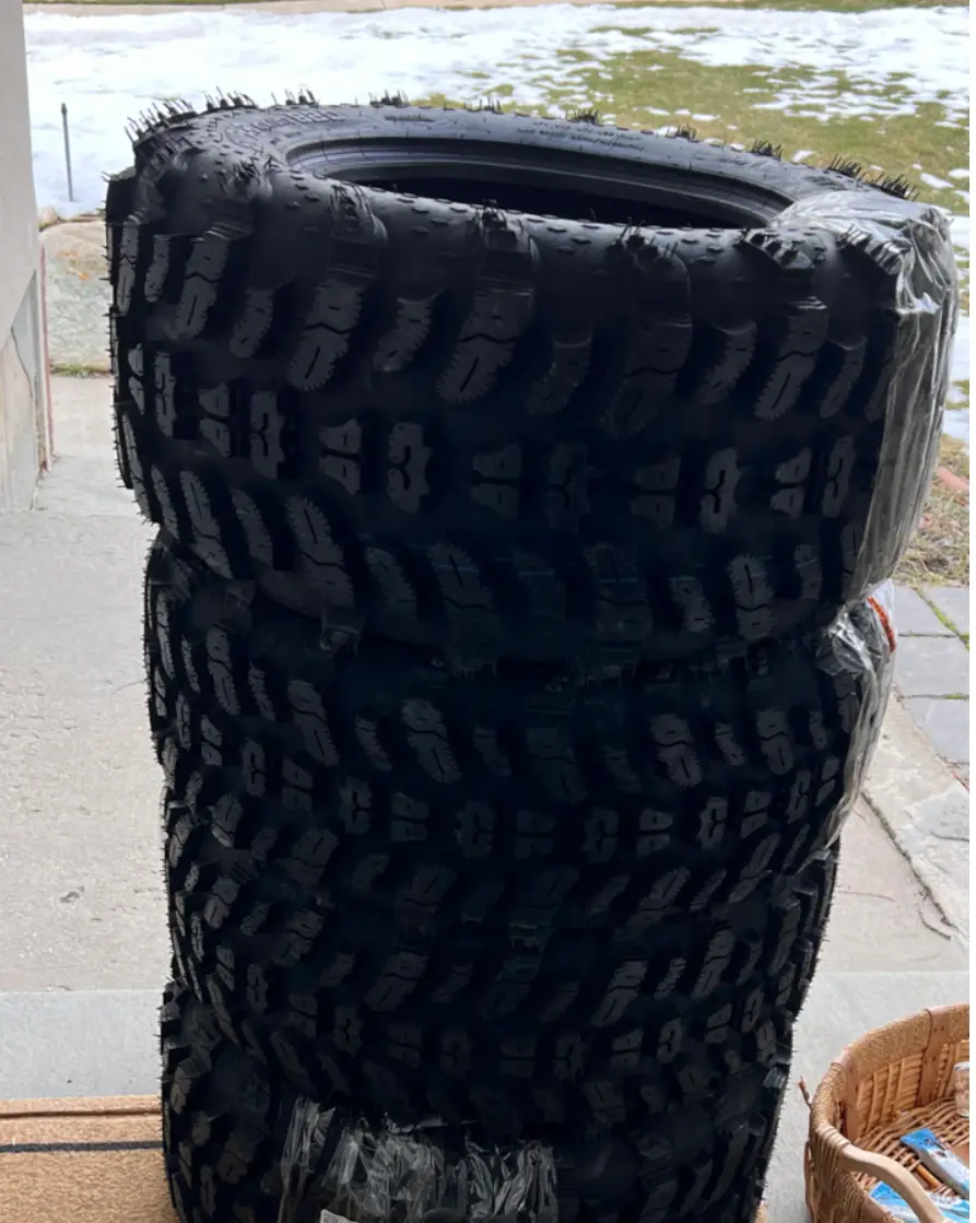

St. Nick can go pound salt. St. Paddy rocks - he left me something on the porch.
1709928515642
27x9-14, 27x11-14 Sniper 920's.
Going to be a bit before I get them on my rig, but I'll try to follow up.
Will be swapping the OEM Bighorns for these. Cannot go to a bigger tire w/o chopping the ROPS to get into a low garage.
