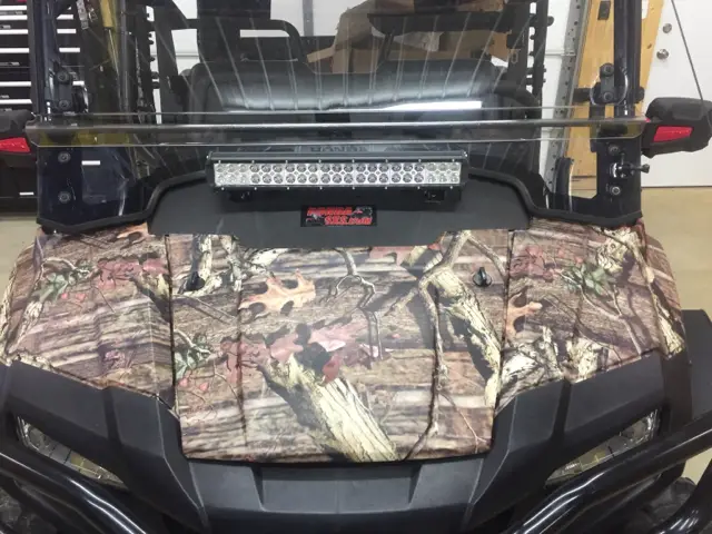

How do you like the Koplin mirriors? The rubber pieces on the edge of my windshield kept falling off, so I just left them off.

Koplin mirrors are fine, yes you have to reach over and move it back out after some tight trail riding (as you would with any mirror),but for the money there great.. I took that rubber off (the other side is long gone) after the picture was taken, don't need them this time of year anyway. Next winter I'm going to put self adhesive weather strip on the windshield to replace the rubber.

That was directed at Tramguage1. Sorry. Anyway, what is your light bar mounted to??
A1c9b51825034a65f9b106f35aaa9630C3099341ac2d6ad045542c174493245d158a5e94f94be85bb7dd2d4f5007e60e
I used 2 9" bars and used bottom mounting screw in the two piece windshield. They worked great,no problems on the [HASHTAG]#pioneertakeover[/HASHTAG].

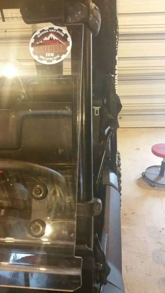

Can y'all help me with my 2 piece windshield? It was installed when I got the 700-4 and the windshield won't stay open. I believe the knob is actually trying to screw into the pillar. It's like it us too long. Also where are the clamps supposed to be positioned? They were not tight and had slid down the pillar.

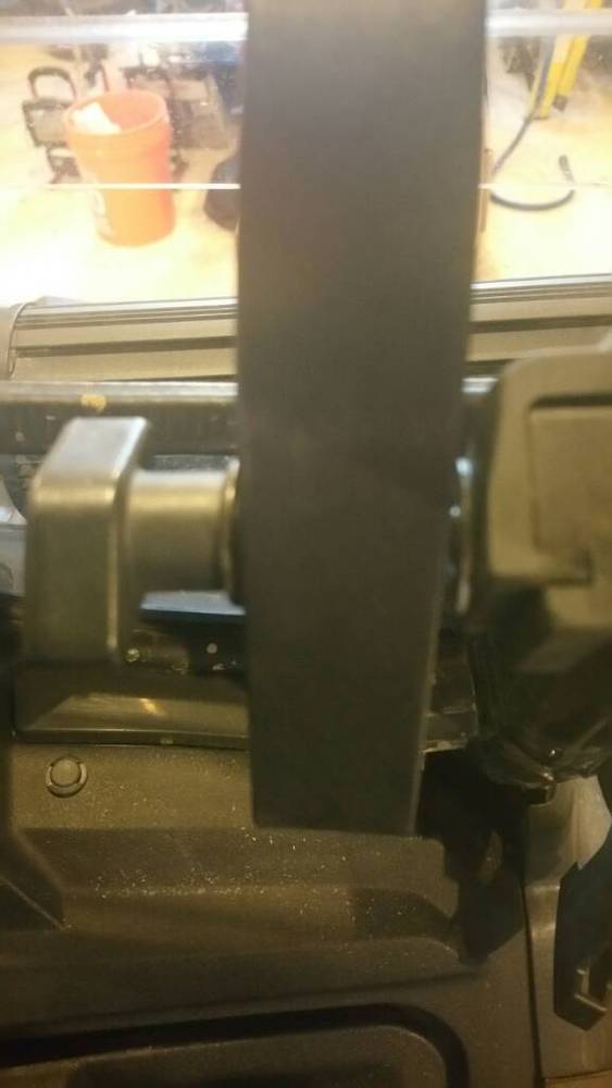

This is where I moved them up to. Is this right? Still the knobs won't tighten down.

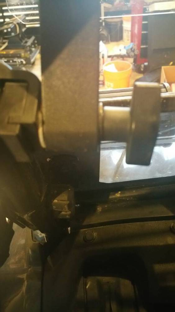

Make sure the top clamps are up high enough. I close the windshield and align the bottom with the stationary peice. Then move the lower clamps to where the sliders are down and parallel with the windshield. Also there should be a flat washer on both sides of the slider.
Sent from my SAMSUNG-SM-N910A using Tapatalk
Tramguage1
Tramguage1
Texan
Jul 2, 2015
7,139
27,144
Somereset, Texas
After you get it where you want it I tighten the clamps until there is almost no gap.
