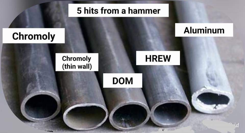

That’s what I remember, 3 different thicknesses.
Here’s one cross section
