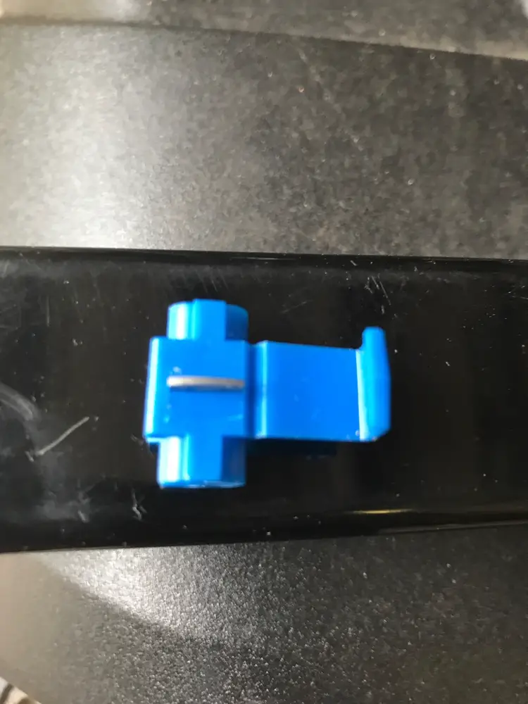

Installing the Warn winch today. I have two blue splices in the parts bag. I have located the red pigtail accessory switch on the wiring harness. If I am reading this correctly this is where the rocker switches should connect. Will splicing in with the included blue splices be the best way to connect the rocker switches? I can't find the most commom way to do this for the Warn vantage winch on the pioneer 500.

I have that part, it's the key on power part that is I am asking question about, I am not sure if I should tap in with the blue splice parts that were included.

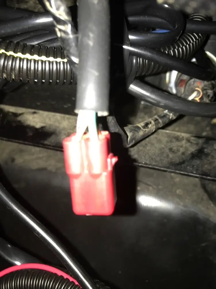

This what you mean?

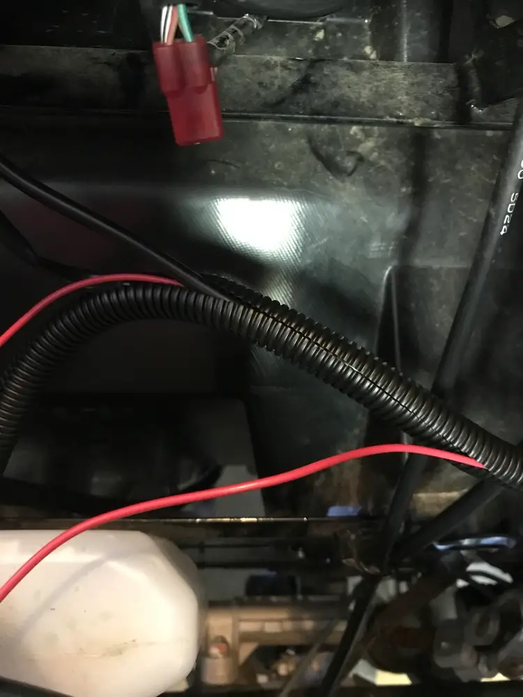

Yes, that is the red pigtail from the keyed powers switch, I have a red wire from each rocker switch to splice into the circuit 090c5ff298a0a7152a83e72a45bca5b4, this is the red accessories switch 7e6d2c2dda407a8e4935995e6f87a371, these are the red rocker wires Fb9a2fc7dd1360eca2fa6e032129108d,,,,
