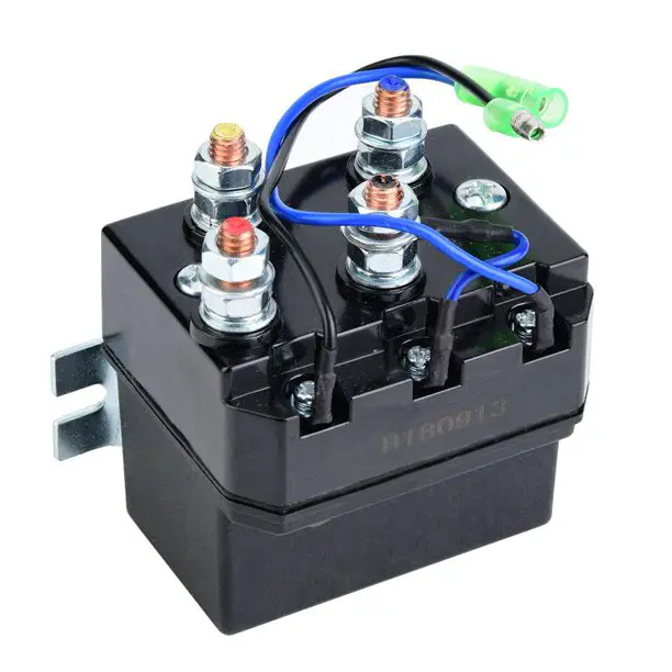

I bet you don't have an actual contactor box do you. (See image of common contactor)
Those red & black wires.
One set runs to the winch. The other to the battery?
Is that right?

This is old school right here.
Is that right?
Yep, one set runs to the battery and other to the winch. I do not have any other contactor or solenoid in the setup.
I was hoping to use this to save time and money, but I assume I'll just end up buying a contactor/solenoid like the image you shared.
Thank you!
That's like the old Warn contactor that turned to switch direction. Like this:
36015 b 1024x1024
You might have to get a newer style contactor to make a switch work.
