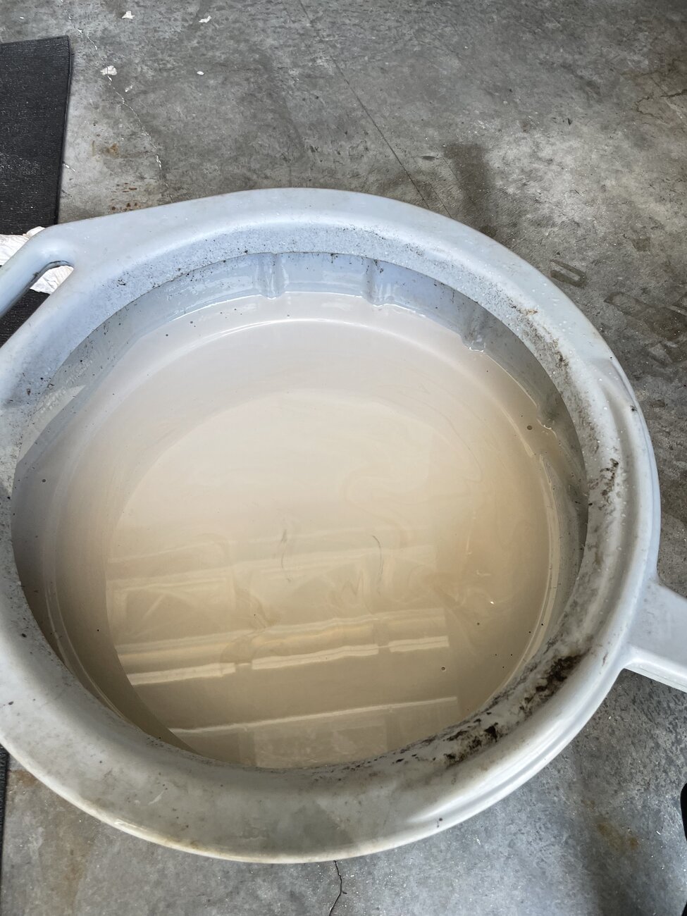

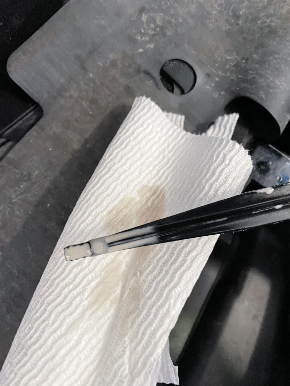

I have a 2021 pioneer 1000-5 LE I had the dealership do the snorkel setup after purchasing it brand new last April. I live Florida so we do a lot of mud riding. I’ve never checked my sub transmission fluid since purchasing it being service wasn’t due on that portion yet. Just recently I’ve been having trouble getting it to shift in low gear and it also felt a little rough while driving and transmission shifting to next gear. I assumed it was the gear cable but come to find out the dealership that charged me roughly 1100.00$ to complete the snorkel never vented my sub transmission or the shifter box at the rear floor and the sub transmission was completely full with water. I’ve drained at and replaced it 3 times and all seems to be working fine now but should I be concerned that internal damage might have happened all ready from water being in there for over a year due to the dealership not completing the work correctly. I haven’t had a chance to speak to the dealership yet they’re closed till Tuesday. Has anyone had something similar happen with water getting in the transmission for that long? My machine has about 70 hrs on it right now and 500 miles on it

While it sucks I wouldnt get too worried. The subtrans is just a simple gear box, completely separate from the engine and transmission. Put new oil in it, run it for a bit, drain it, repeat as necessary until it's clean.
