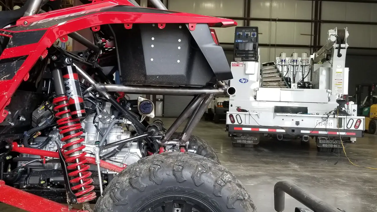

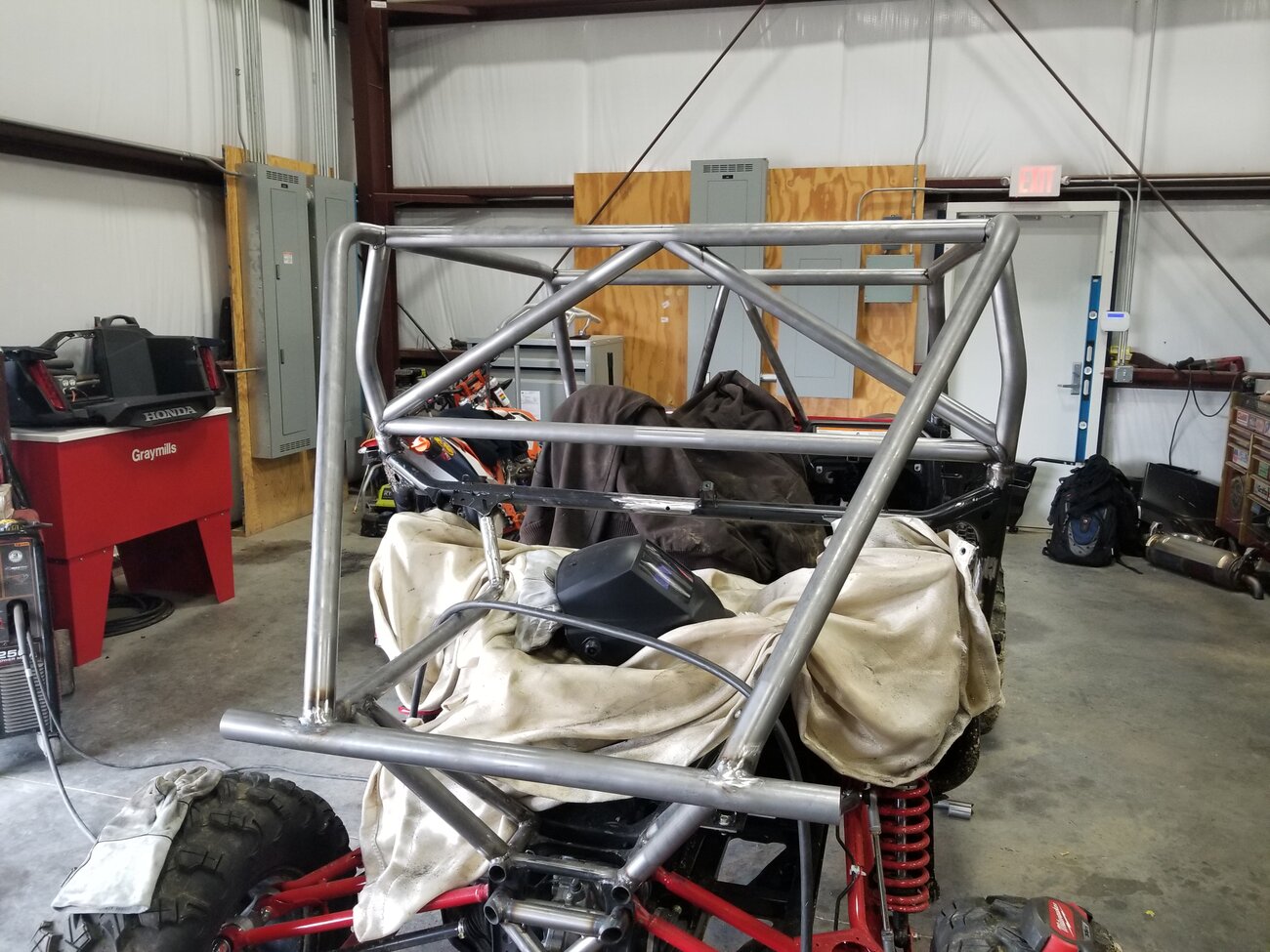

Rear frame below engine bending
I predicted that happening when I was building my car. The only real way to fix that is to cut the entire rear upper section off and rebuild it out of heavy wall tubing along with tying in the C pillar bars to triangulate the back half of the chassis like so....
20200405 173341
20200412 172455
H
HondaTech
We're seeing the lower portion under the engine bow where it meets the horizontal tube. We planned on cutting out the cross members and welding in better supports.
