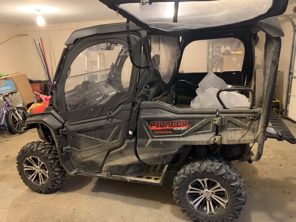

Extended the gastank, sgas tank, shift box, and rear diff vents. I'm not snorkeling mine or intending to use it as a boat so I left the fan and front diff where they were.
Also installed the OEM winch. Next will be the dual battery and isolator which will take a little planning as I'm not moving the prefilter and box under the hood.
It can be done fairly easy. I didnt want to snorkel mine either.

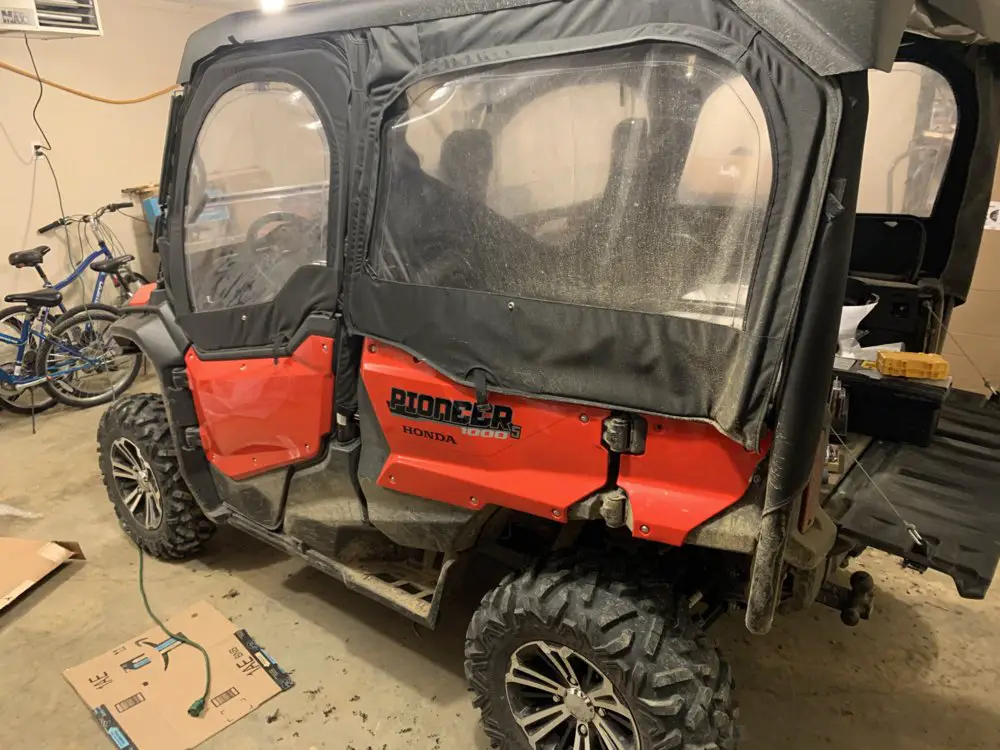

Got back on my tailgate stregththening/tailgate extender project. Need to add latches to the extender tailgate and support bars for the loaded weight of the extender, then finish painting. I think I'll add a strip of angle iron to act as a "cap" for the top of the oem tailgate. I sized it to accommodate an rtic 65 with the rear seats up if ever needed.

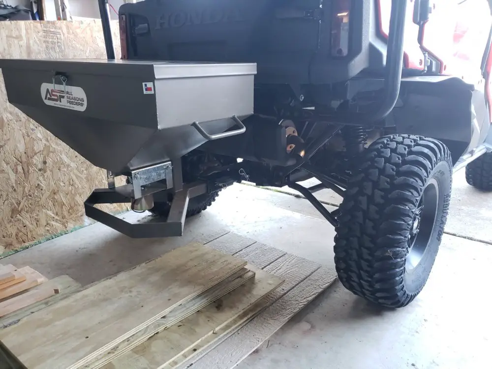

What brand is it?
All seasons feeders
The galvanized line is not so good (thin, non-welded) but the painted line is much better (welded steel).

After a lot of help from previous posts and the links of @JACKAL, I was able to build at kit that installed exactly the same way as the now discontinued red panel kit Honda used to sell for base models.
You won’t have to replace the doors using the kit. You just need to make sure your well nuts are tight fit when installing them.
