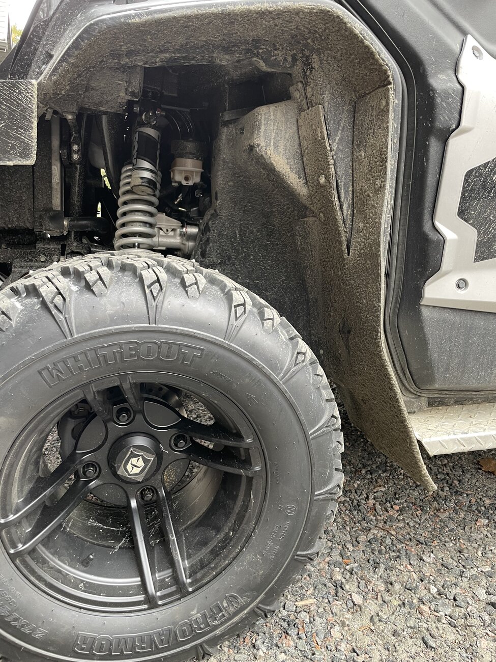

10" wide wheels? No rubbing on the arms, plastics, etc??
Not sure on the rim width, I could check tomorrow. I have 1" spacers to adapt to the different bolt pattern. The outer edge of the tire does rub slightly on the inner part of the wheel well at full turn with compression. Today I increased the preload on the springs (fox shocks) I'll see tomorrow if that helped things. I didn't measure clearance with the stock tires, but I now have 13.5" of ground clearance
JenElio
I checked this morning The tires are actually 27x14x14 Measuring with a tape measure the rims look like they are 11.5" wide. before I adjusted the preload the tires would touch the inner fender at full turn. I'll add a bit more preload today
