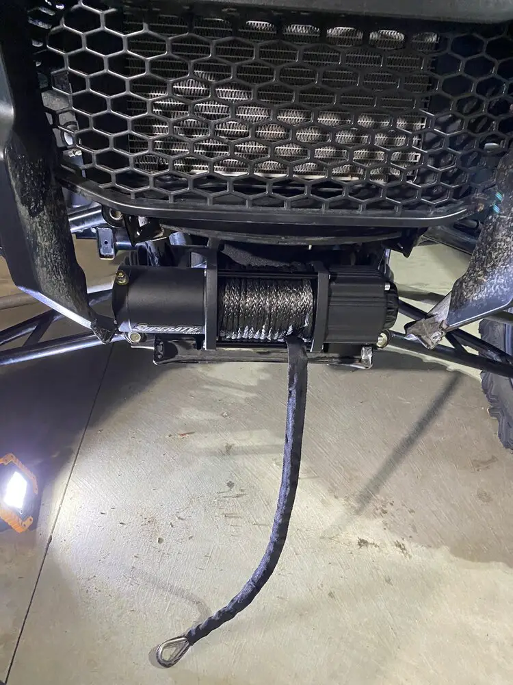

Started installing my 4500# SuperATV winch. Winch is installed. Next step is wiring, but I'm hesitating. I'm thinking of installing a dual battery setup before wiring the winch so I don't have to rewire the winch later.
Is it just me, or does anyone else have concerns that only 4 bolts hold the winch to the frame? I'm sure the system has been tested, but I like things over engineered.

I also tend to over engineer things, but how many times have you read about winch bolts shearing off on this forum. I haven’t read about any. I did watch a YouTube video by Dirt’N’Diesel where he talked about bending a SATV mount when someone accidentally bumped the winch control while the winch was fully wound up, but no bolts ripped out or broken. I just installed a 6k winch from the club store and although the winch is held to the mounting plate by 4 bolts, the mounting plate is actually held to the frame by 4 3/8” u-bolts.

Another thing that you may want to think about is flipping you winch over so you have a straighter pull through the fairlead. Waiting until you have your dual battery system installed is a good idea. You’ll find that things start to get a little busy under the hood when you have to install your battery isolator, stinger relay, winch relay, fuse block, etc. You‘re probably going to have cables that are just right and others that will be too long. Make sure you have plenty of the right size ring terminals and shrink tubing before you start the wiring.

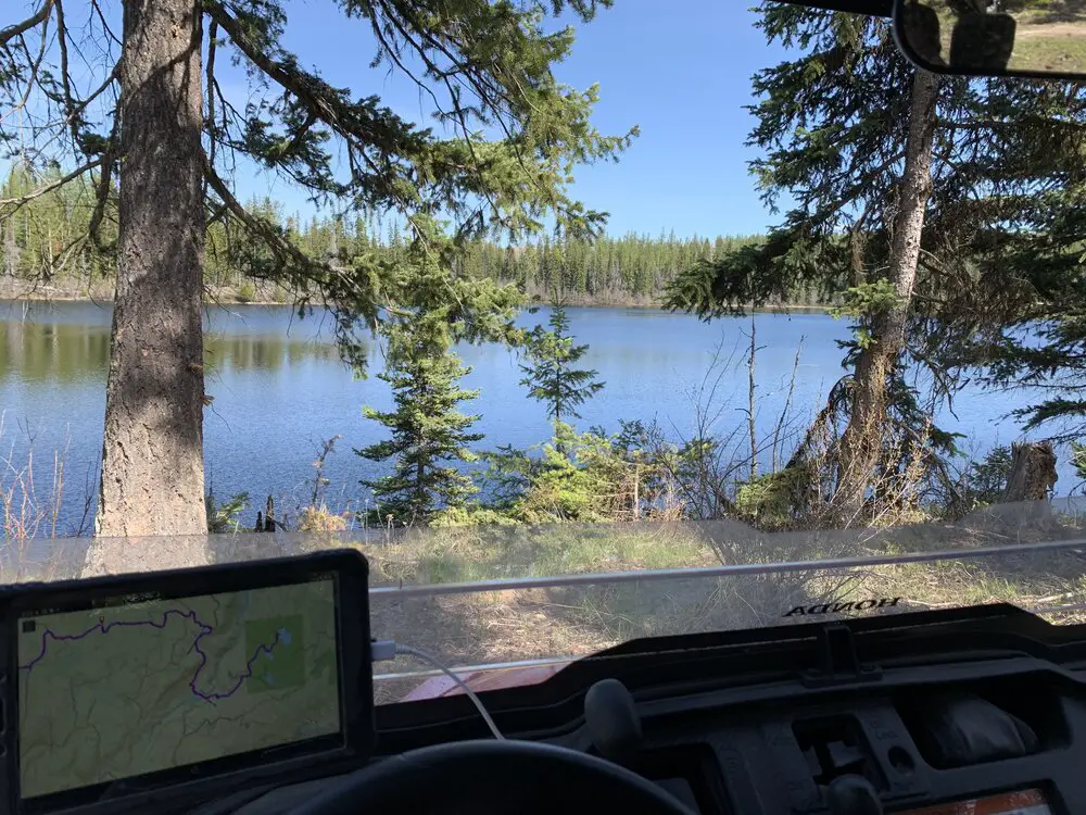

What navigation system are you using?
Samsung 8 inch tablet with Gaia gps app. The app is free but I paid $30 for membership to download backroad maps and atv trails. It was the best for my area. Into it for about $225 including case and mount. There are other apps and mapping so check with what people are using in your area. I’m in Canada so Gaia seemed to be my best option. Very happy as it syncs accross all my devices.

Consider that a single 1/4 - 28 grade 8 bolt has a tensile strength of 2,728 lbs, a 5/16 - 24 is 3,480 lbs (shear is about 60% of tensile), it is unlikely that things are gonna pull apart!
