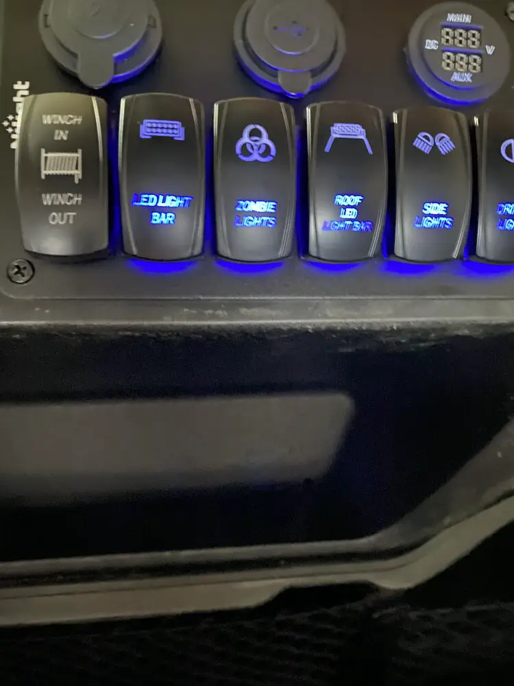

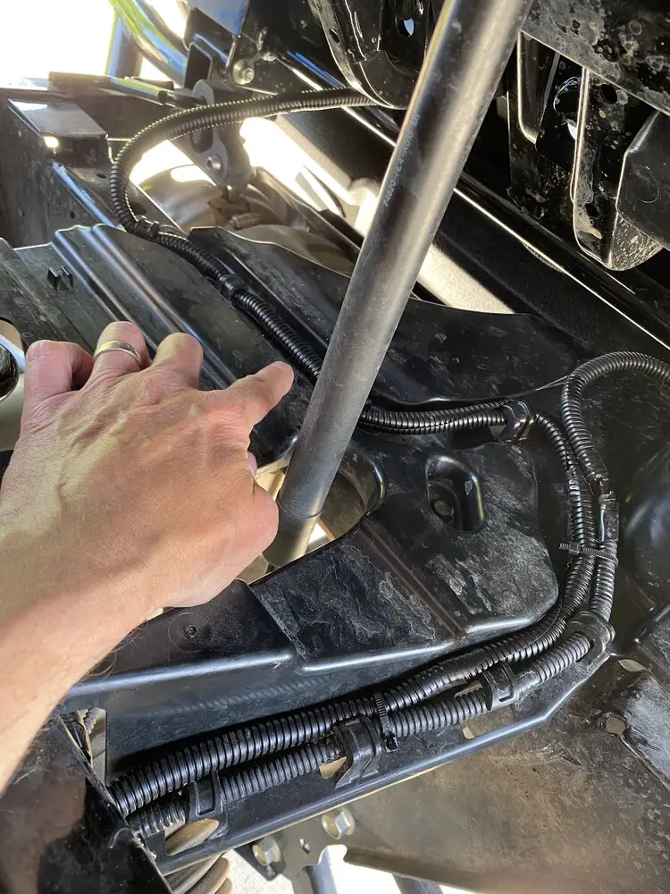

I added rear lights. I was worried about how to run the wires up to the switch panel, but it was rather easy. They go down the right rear ROPs and under the dump bed to the driver side and I followed the existing wires under the seat and under the drivers foot well. View attachment 279750
I used the zombie light switch, because you need rear lights to see the zombies when they’re chasing you.
Question, I purchased Nilight lights and a nilight switch panel. I have the power coming from the fuse box into the switch. My lights will only stay on for about 5-10 minutes and I blow the switch (not the fuse). Do I need an inline relay? What kind?
Yes and it depends on the total amperage draw of all the lights, to start. You can buy a simple wire harness with switch and relay on Azon.

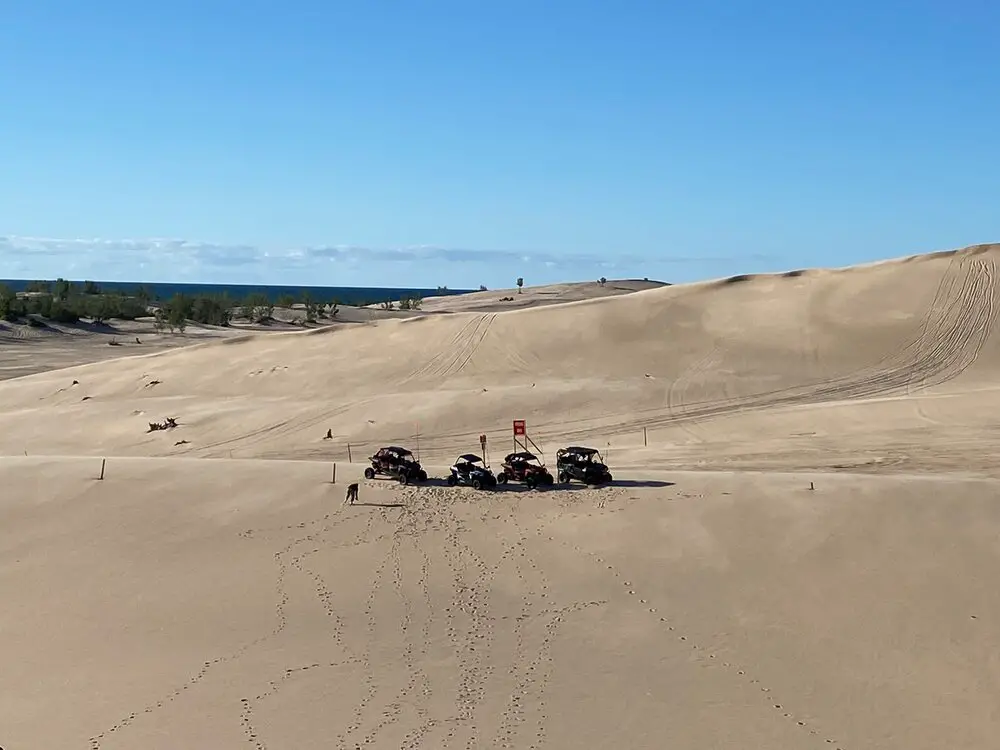

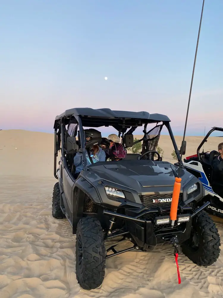

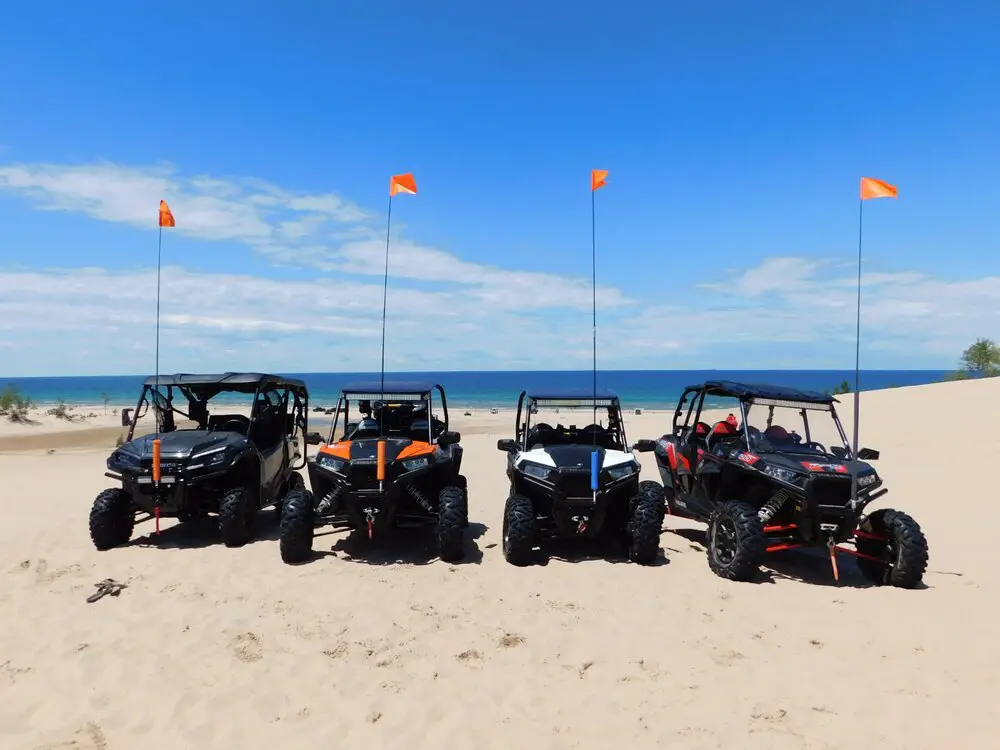

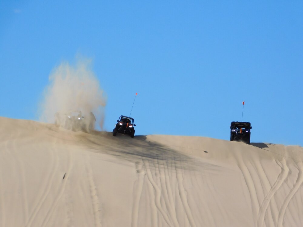

Hit the Silver Lake sand dunes in Mears MI on Monday and Tuesday. It was our first time there and we had a blast. Lots of fun watching all the different rigs and people getting stuck. We went with our friends, three RZR and all but one got stuck. Didn't see another P1K5 the whole time. I highly recommend visiting.
View attachment 280421 View attachment 280422 View attachment 280423 View attachment 280424 View attachment 280425
That's a fun place. I was there just last year. I rented a Jeep and drove the dunes.
It looks like you have the deluxe with the stock suspension and tires. I wondered how it would hold up in a place like that. I figured a Talon or different tires were a must before hitting the sand but your pics suggest I need to trailer down there and try it. What mode did you drive in to go up some of the hills?

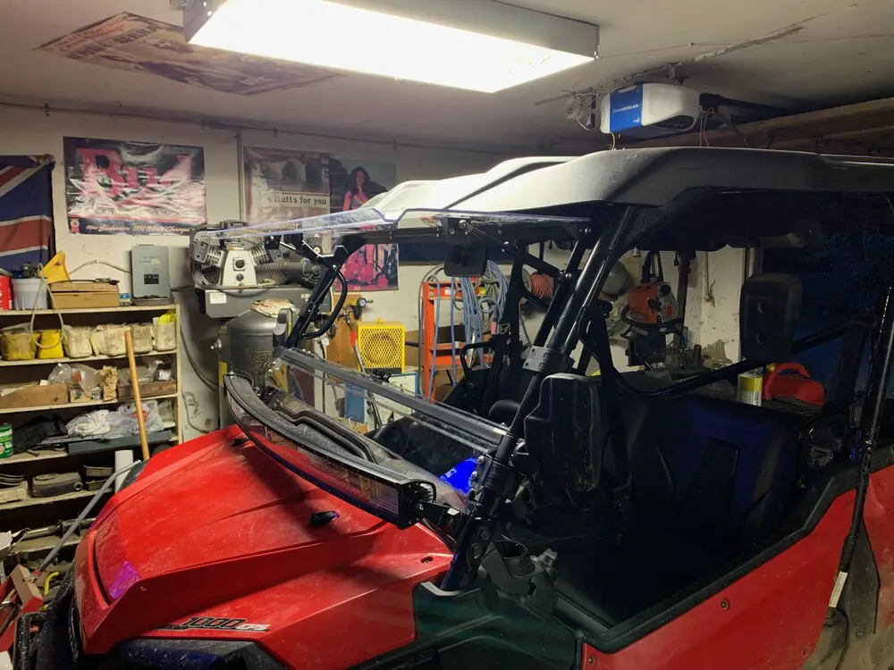

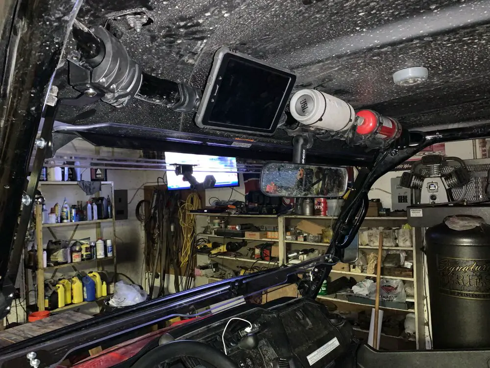

Finally installed one of them SATV windshields. Had to move my tablet though. Not sure if I gonna like it up that high but I will give it a try.
Dude!! I was jones'n on your low mount... now you have me 2nd guessing. Why is the SATV flip-up windshield incompatible with your tablet/RAM mount?
Haha. I was tired that night when I finished the windshield. Came home yesterday, cracked a beer, and thought about it a little. It is back where I had it.

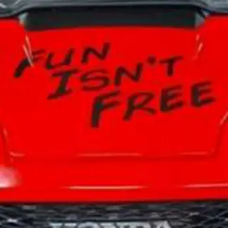

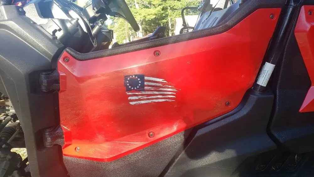

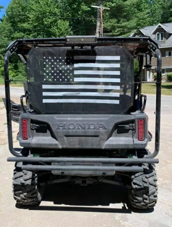

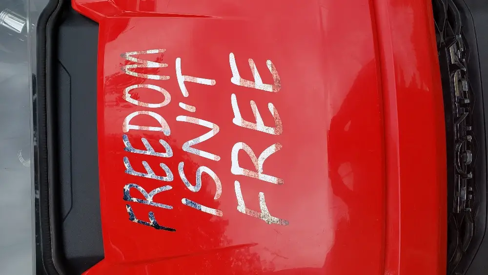

I changed out a good hood decal from what the previous owner had. Although, it was accurate, I wanted something more along my line of thinking with my view of the good ol' U.S.A. Fun is good, Freedom is better. A little bigger font may have been better, but you can read it when you're close.
I also added photos of previous recent adds (rear mesh flag, Betsy Ross flag door stickers) that compliment the patriotic theme of the new hood decal (my wife made me on her Cricut machine).
EDIT: I see the pictures posted twice and the one that was sideways that I corrected still posted after deleting it.

I changed out a good hood decal from what the previous owner had. Although, it was accurate, I wanted something more along my line of thinking with my view of the good ol' U.S.A. A little bigger font may have been better, but you can read it when you're close.
I also added photos of previous recent adds (rear mesh flag, Best Ross flag door stickers) that compliment the patriotic theme of the new hood decal (my wife made me on her Cricut machine).View attachment 280624View attachment 280625View attachment 280626View attachment 280627
Freedom is far from free my friend.
My circle thanks you.
I aired down the front tires to 9 lbs and the rears down to 10 lbs. I wasn’t taking any chances and left it in 4wd HI on the dunes. I dropped it into 2wd on the flatter areas. The stock deluxe shocks are not the best on the washboards. I took a ride in my buds RZR and those shocks soaked up the washboards. It was fun watching the Jeep’s get stuck at the top. The drives didn’t get enough momentum at the bottom and lost power at the top.
