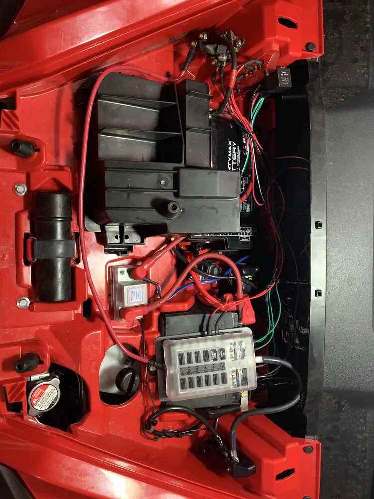

Finally put my second battery in, added my switch plate, and ran the harness for the reverse light switch. Definitely need help with a permanent mount for my fuse box, just Velcro holding it on for now.

Use 3M Dual-Lock to mount it (clean surfaces with denatured alcohol). Dual Lock is far stronger than Velcro so it'll stay in place and you can still move it out of the way if need be (depending on the slack and routing of the wiring course). Speaking of which, I prefer routing the positive to your fuse box along the rear of the compartment so you can secure it to the tube with the other wiring. Not a big deal, but helps keep it out of the way and out of harm's way too.

auto body moulding tape is extremely effective.
Yes, great mounting tapes including the 3M VHB line of tapes (stands for Very High Bond) line. The problem, especially with the new SE version that's prewired for some options, there are precious few places to add more things - they packed the hood pretty good! Where I've added a fuse box on a sidewall, it has to be removed to get to a row of terminals. For this sort of application, 3M Dual Lock is great as it snaps into place yet pries pops off for access, when done, simply push to snap it back into place. VHB, or other side moulding tape will hold stuff, but don't allow removal/replacement with ease.
