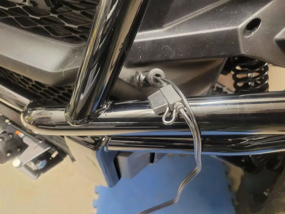

Center of pic shows a Powerlet style (also called BMW plug) with waterproof cap for both charging battery without need to remove hood, and for powering things like an air compressor etc. This type of plug is very reliable.

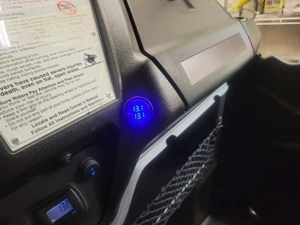

This location for the dual volt meter (came with True battery charging system) faces driver and nothing to remove to reach the back side for mounting and wiring. To the left and below voltmeter is a small rocker switch to disconnect/connect the wireless winch control receiver. It otherwise would be functional all the time (not key on/off) - some have reported uncommanded operation of their wireless winch receiver, probably due to RFI - so the switch is good insurance to prevent damage.
From bottom of pic to top: Just above "tool box" is the wireless receiver for winch (most of wiring goes to winch reversing solenoid just above. Next above is True UTV dual battery charging system. Upper left is accessory fuse/wiring box that comes with 1000 SE. I relocated this to above the AUX battery which is secured by quick clamp strap (strap is hot melt glued to compartment sidewalls, there a dense foam pad between battery and fuse box to maintain tension. On the SE, they don't leave you a lot of room to add stuff. Still waiting delivery is a smaller buss/fuse box (the one I had is stock is a bit too big to fit).

Awesome idea on the location of the dual battery gauge. I’d love to see your pics/videos on installation. I’ve got a 21 1000-5 SE as well and I’m planning on adding the same True setup this weekend.

Congrats on even finding a 21 SE! Other than what I've posted, no other pics (I don't think about taking videos when I trying to figure what I'm doing next). The Tru came with a rocker switch style dual volt meter, I didn't want to use that on the stock switch panel, as I knew I'd be using those spots for switches, so ordered the round one. You might check with Tru to see if you can get that substituted - though the meters are not pricey.
Just got in a 12" X 12" textured plastic sheet, so I'll be removing the, "YOU ARE ALL GONNA DIE!!" warning plate on the right side of the dash. That will be replaced with the blank sheet. I'll make an access hole in the dash under the new panel to make wire routing easier. I'll use blind rivet nuts to fasten the new panel.

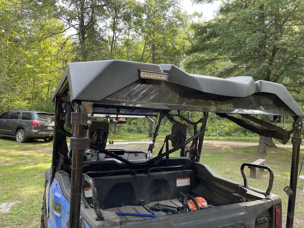

I cut my roof and rear window to add a backup light that I’ve had laying around for a while. It is awesomely bright! The club store lights are very nice and easy to install.
I also added a few stickers so I can keep up with the red ones while still dropping drawers…….

I briefly considered that approach, but then decided to take the coward's way out and surface mount them to the roof using a large washer inside to reinforce the through bolt mount.

The Club Stores come with ROP clamps and the lights hang down under the rear roof?

I'm sure that's a good option IF you don't have a rear windshield by SuperATV. :) If you do, another alternative is to mount the light bracket to the upper portion of the windshield (fixed part), as the polycarbonate is plenty strong for that (unlike plexi).

I thought about those options, but I already had to trim an inch off the front of the roof because the flip up windshield would hit right in the middle.
I’m not scared of a sawzall. :p Someday I’ll take a utility knife and clean up the burrs, or they will wear off eventually on their own.
