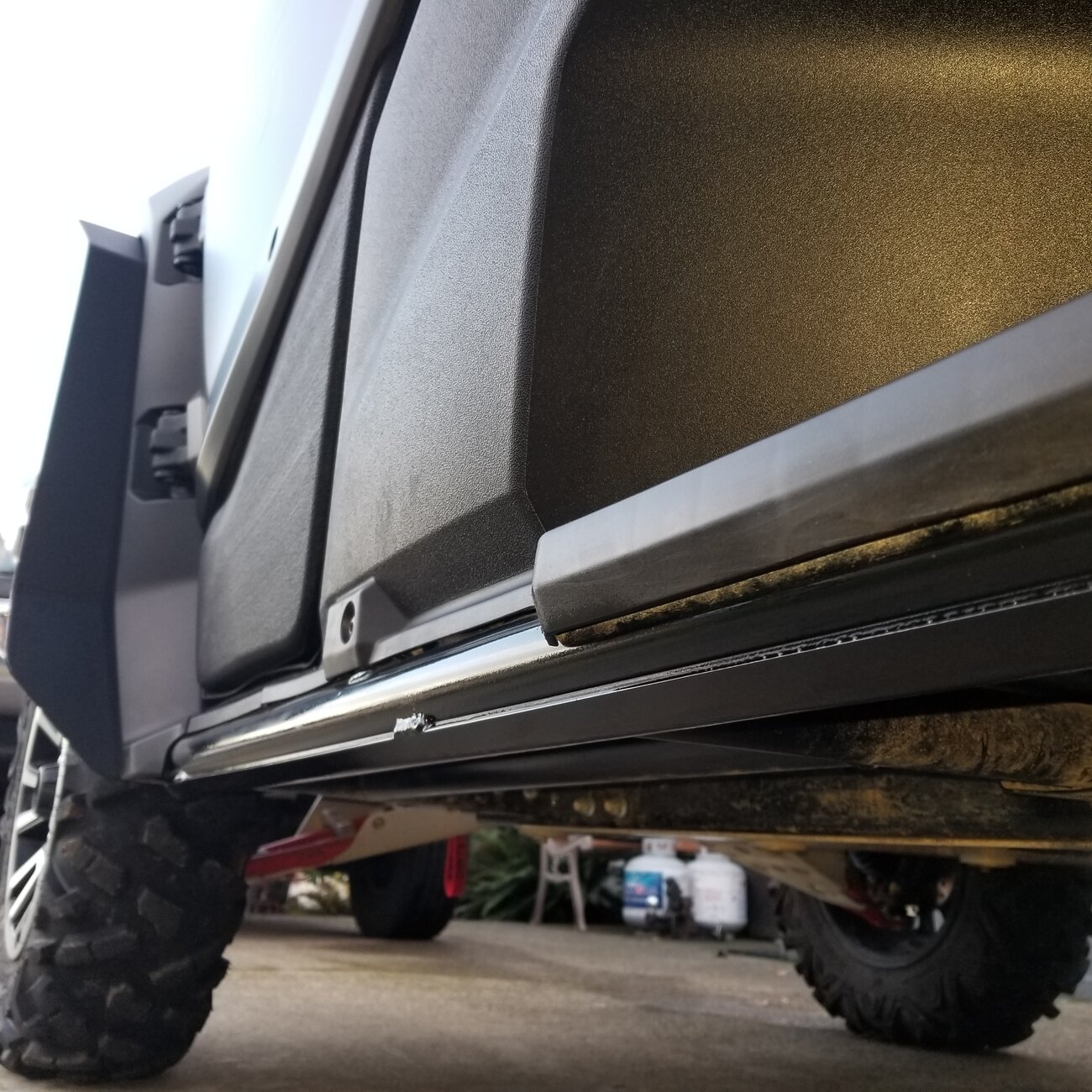

If you are going to weld a gusset - wear bar on, keep your heat lower, wire feed speed up and most of your bead, heat and motion on the wear bar when you weld, as the tube frame is unbelievably, super thin.
Disconnect your battery ground before welding.
Good luck.
