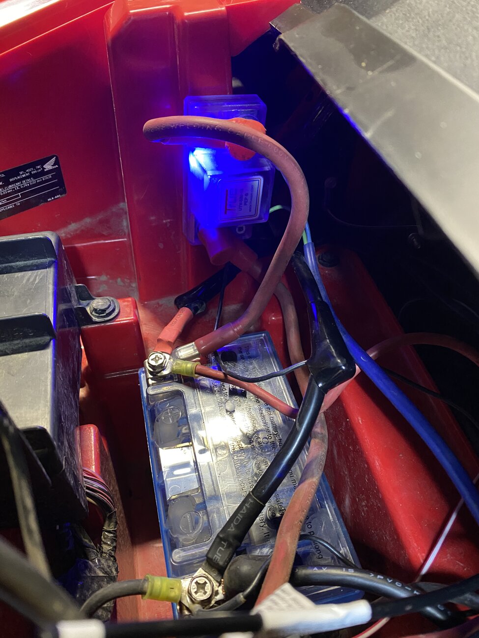

Installed the second battery and moved the accessories over!
Don't see one, but using a battery hold down is a good fire safety idea I think. One easy way to do so is to use a cinch strap (nylon strap with cam type lock). I cut mine to length and attached to compartment side walls with hot melt glue. That was after testing strap adhesion on scrap piece of plastic to make sure shear strength would be adequate.
