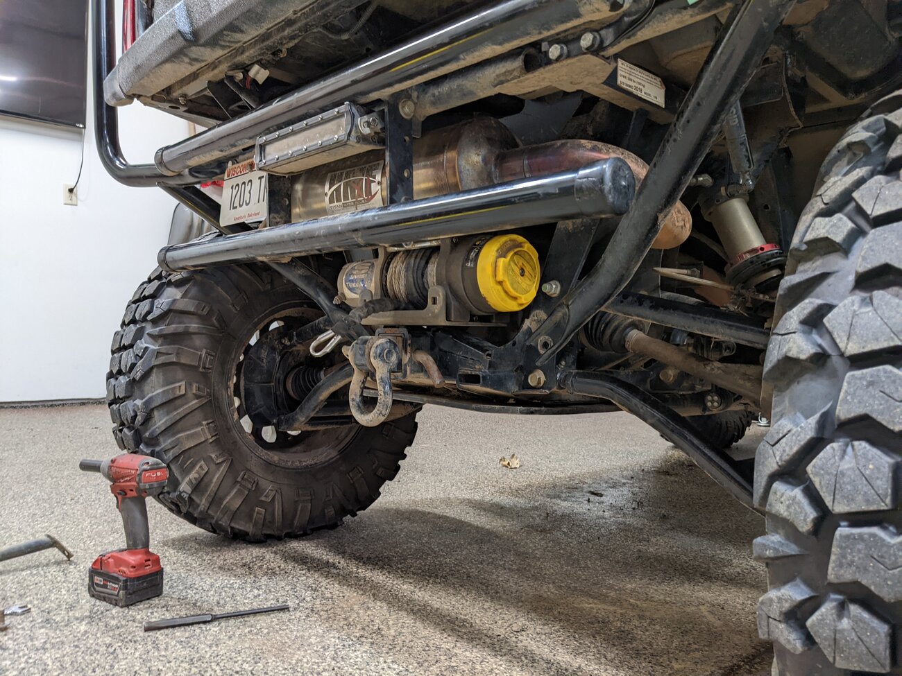

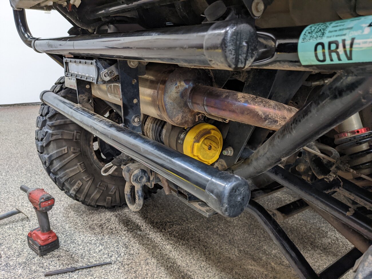

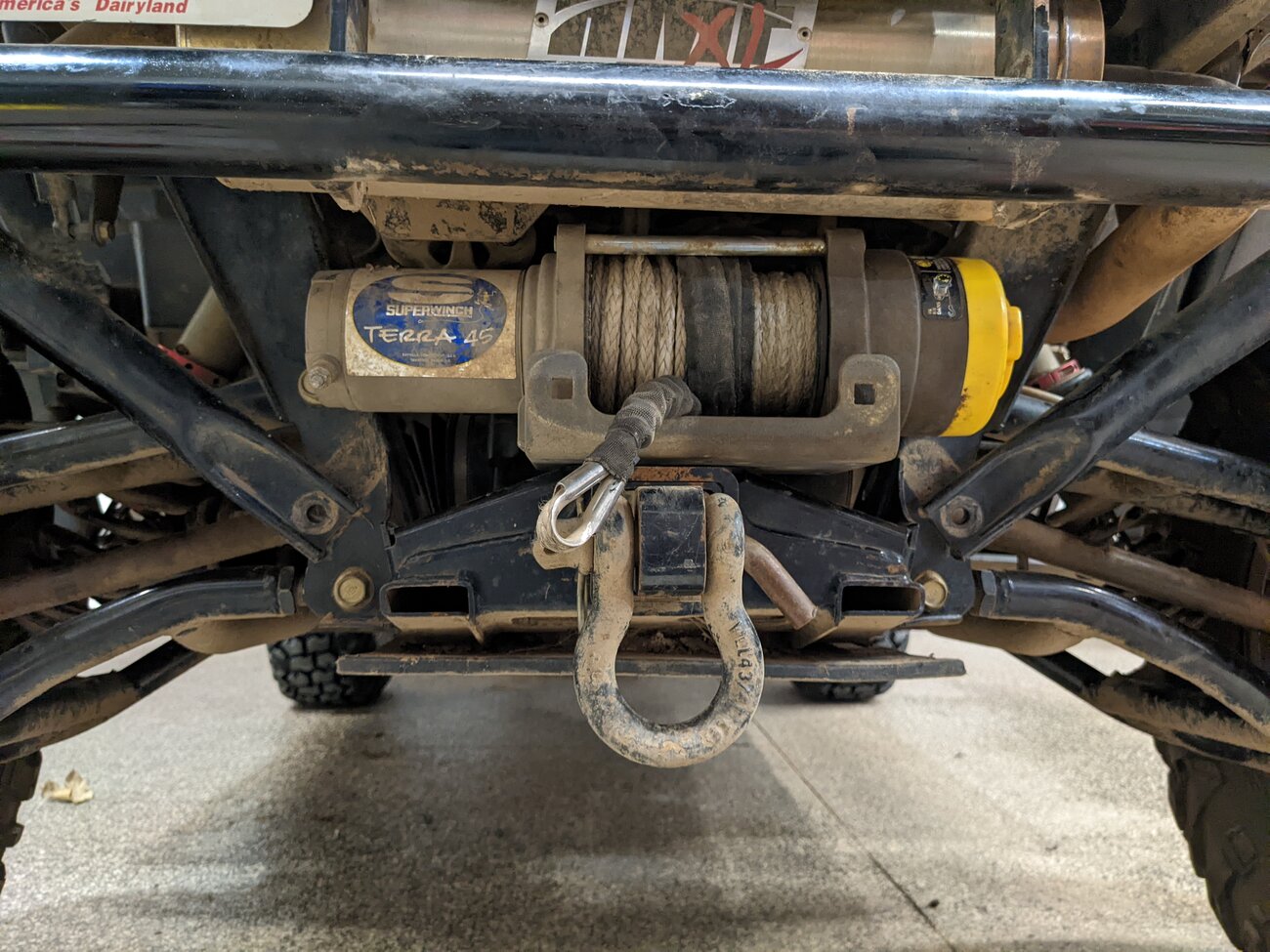

Started looking at my rear winch mounting location. I couldn't visualize a bolt in solution today but I can visualize a more permanent welded on mount above the hitch.

I think you and @ CummingsPusher are the first.
I was thinking about a winch plate mount that plugged into the receiver, for portability.
Great idea
I hate the slop of receiver mounts and there's no way I could give up that departure angle. I had a tiger tail strap and it would drag on everything.
Take it out and put it in the bed until needed? They make battery cable connectors that I'm sure would work for the power.
I would have never winch backwards from here but this was one of the few time I got stuck this year. I'd say most times, I'd never get the winch in the receiver if it wasn't there before I got stuck.
In this particular spot we winched forward 2 full cable lengths and tied off at least 5 or 6 times with a snatch block. The ruts were deep

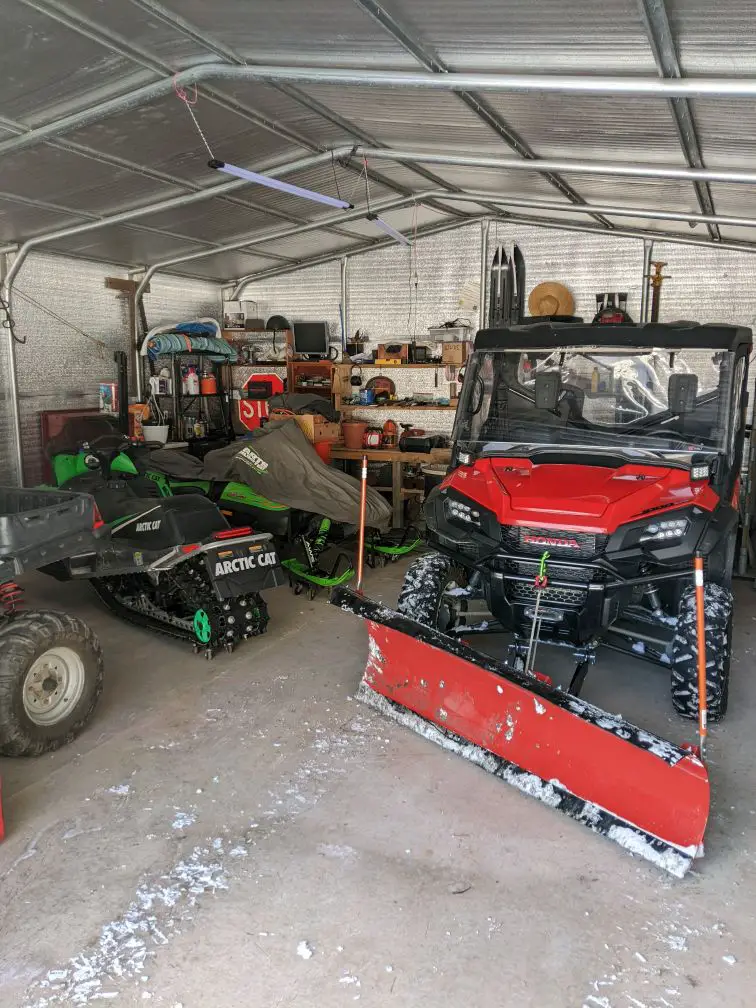

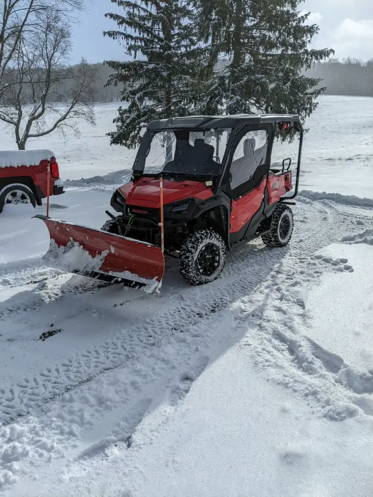

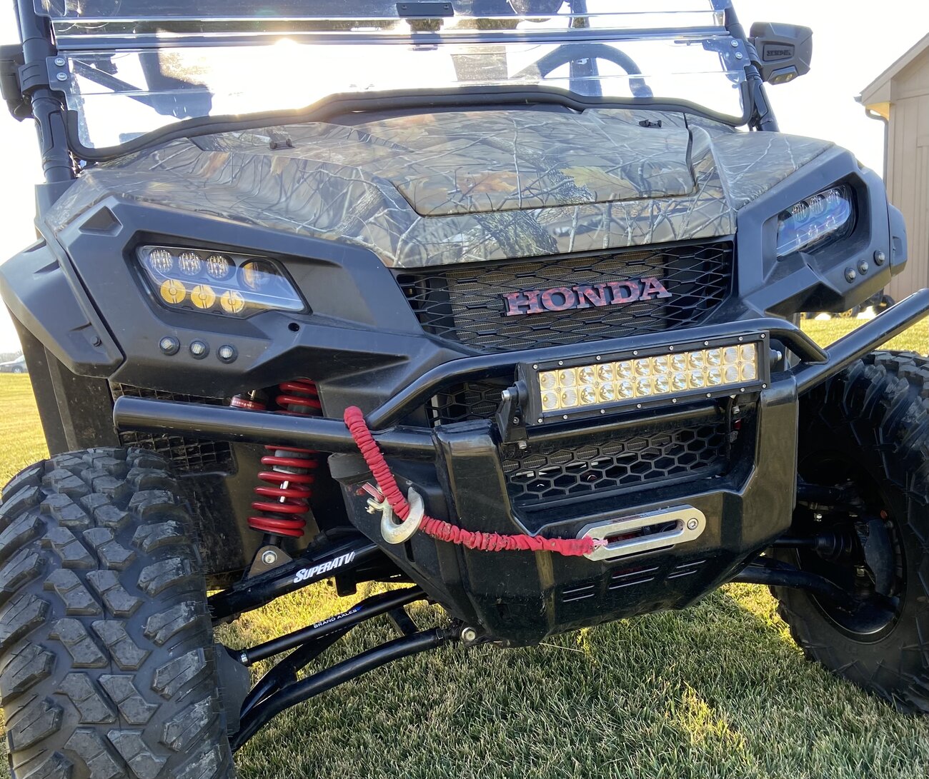

Finally having a snow-day here to try out my plow setup. Not much snow but since I've never plowed before it was just enough to figure things out. Now it's time to play with the other toys!! I smell 2-stroke!
Saw your set up and thought I'd pass on a prior link. One of the reasons I use a dolly is to drop the blade onto wood and not have the skid pucks chip the cement garage floor. Just an idea.
Thanks for the thought but if you could see the damage a carbide tipped snowmobile stud does to concrete you'd see there's not much hope left for my garage floor. It keeps the weather off the toys and the mud off my feet so all is well. If I ever have a new garage a lot more care will be taken.
