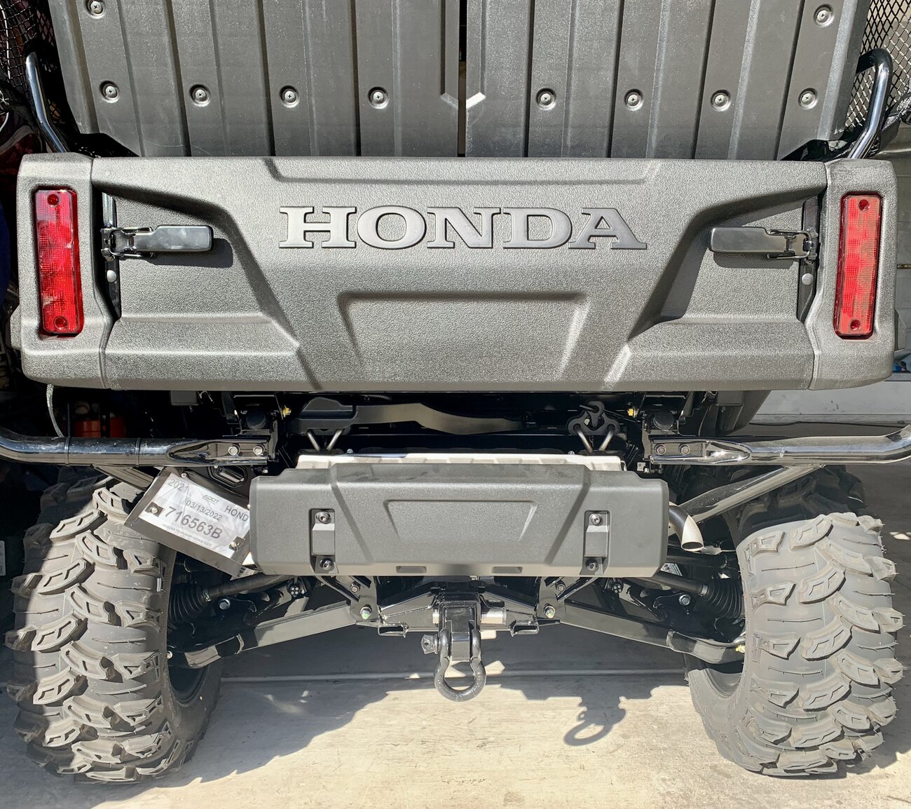

Mine is on the cover but I dont have a light

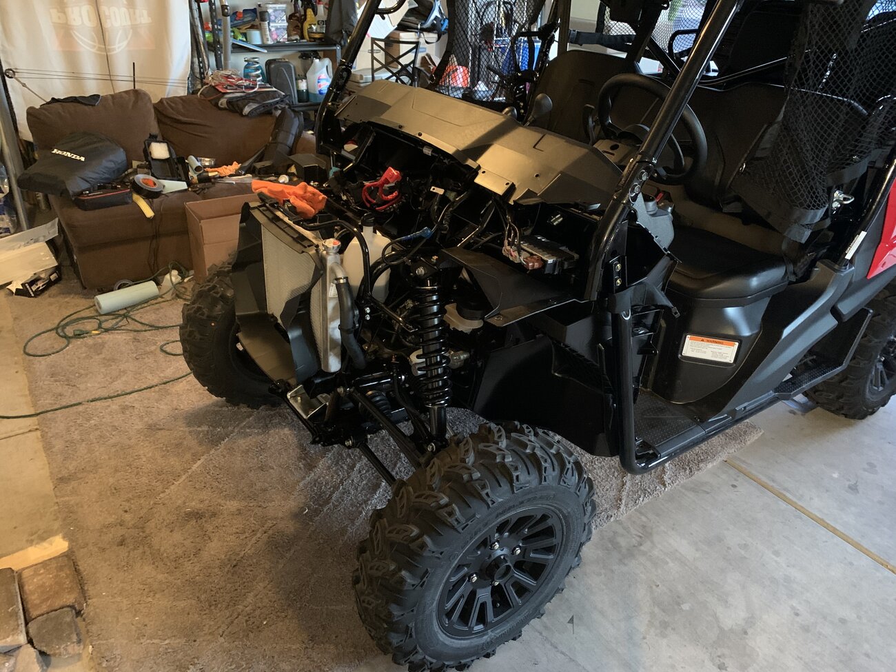

Not today, but Sunday. Took her for the maiden voyage on the ice. Helped a couple buddies move their bobhouses and did a little fishing. Saw some on the fish finder but they were tight lipped. Overall about 15 miles on the lake. Only took one picture, touch screen and fingers and -15 windchills don’t mix well.

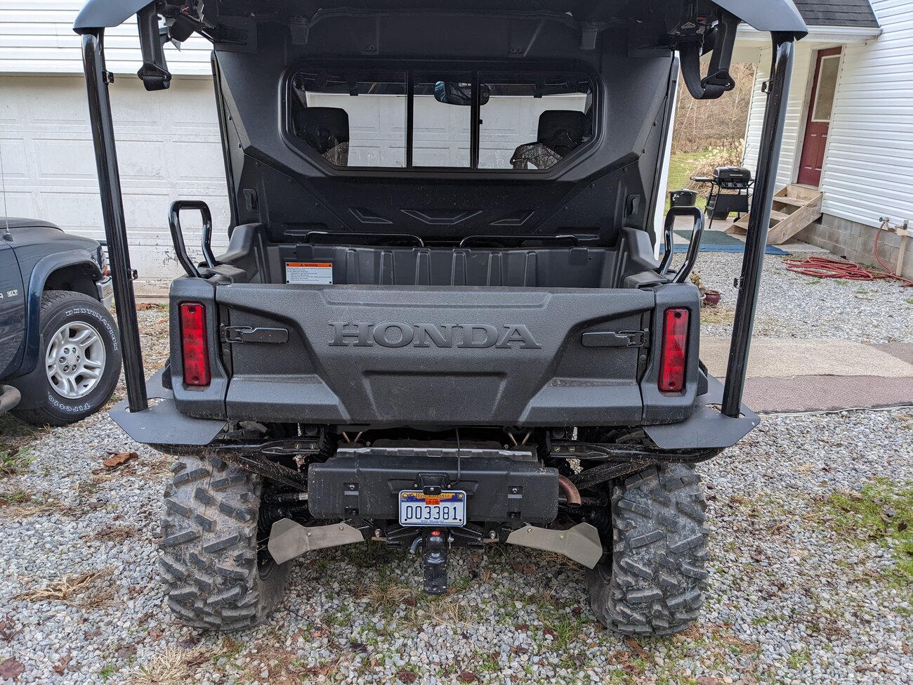

Wrestled with a license plate mount and picked up a recovery shackle. Tried mounting the plate/light on the roll bar but it interfered with the dump bed. Hopefully LEO won’t hassle me because it’s angled.
View attachment 317132View attachment 317133
You shouldn't have a problem with law enforcement. I've seen boat and utility trailers with plates mounted sideways on their fender (some without the required light). I only stopped them if it was a slow day and then looked for "other" things to consider. Otherwise, it was just a warning (I didn't write tickets for nonsense like that).

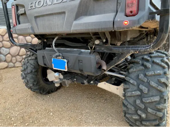

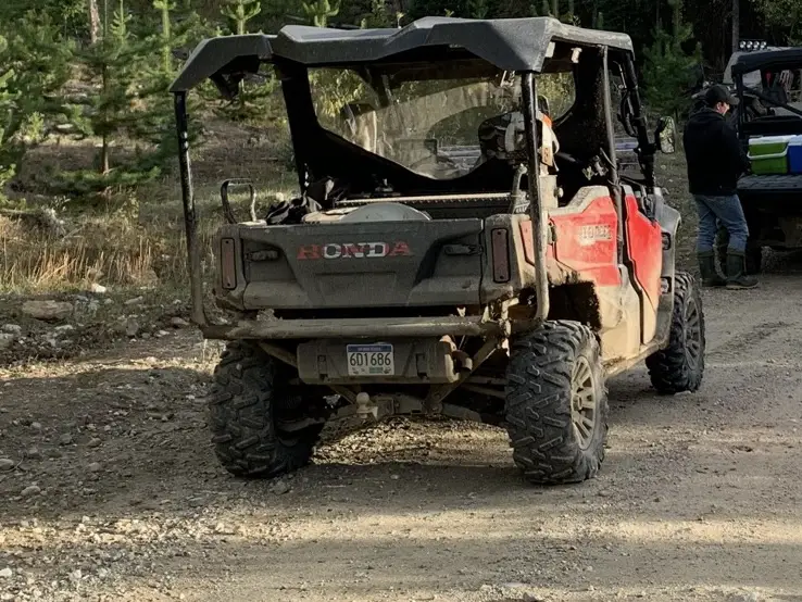

Utah requires a light for it to be street legal.
I found this LED light on amazone for $12 or so and it's worked so far. I tapped into the tail light for power so if the lights are on, the plate is lit.

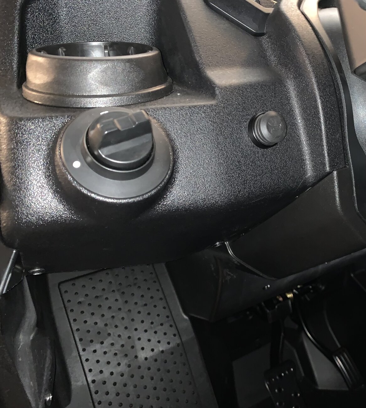

I installed the high beam light bar trigger from the club store to control a small light bar in the front. I ran it through a seven pin on/off/on switch so I can have it on with lights or just on or off. I repurposed the seven pin after replacing it with the ten pin key on /aux power switch from the store. Everything I get from the club store is top shelf.

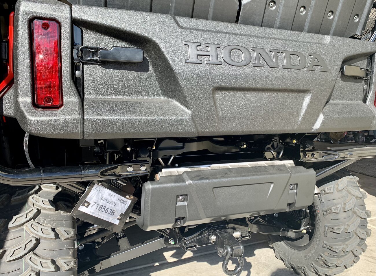

Same here, looks great there and is always showing even with the tailgate down. My plate is from Azon and is metal. When I mounted it, I put several stacked small washers behind the plate so there is a slight gap for air between plate and plastic shield. Never has it gotten hot, great place for a plate!

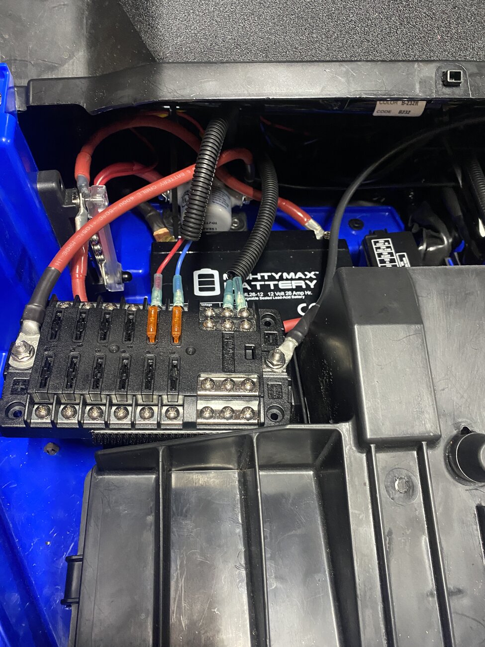

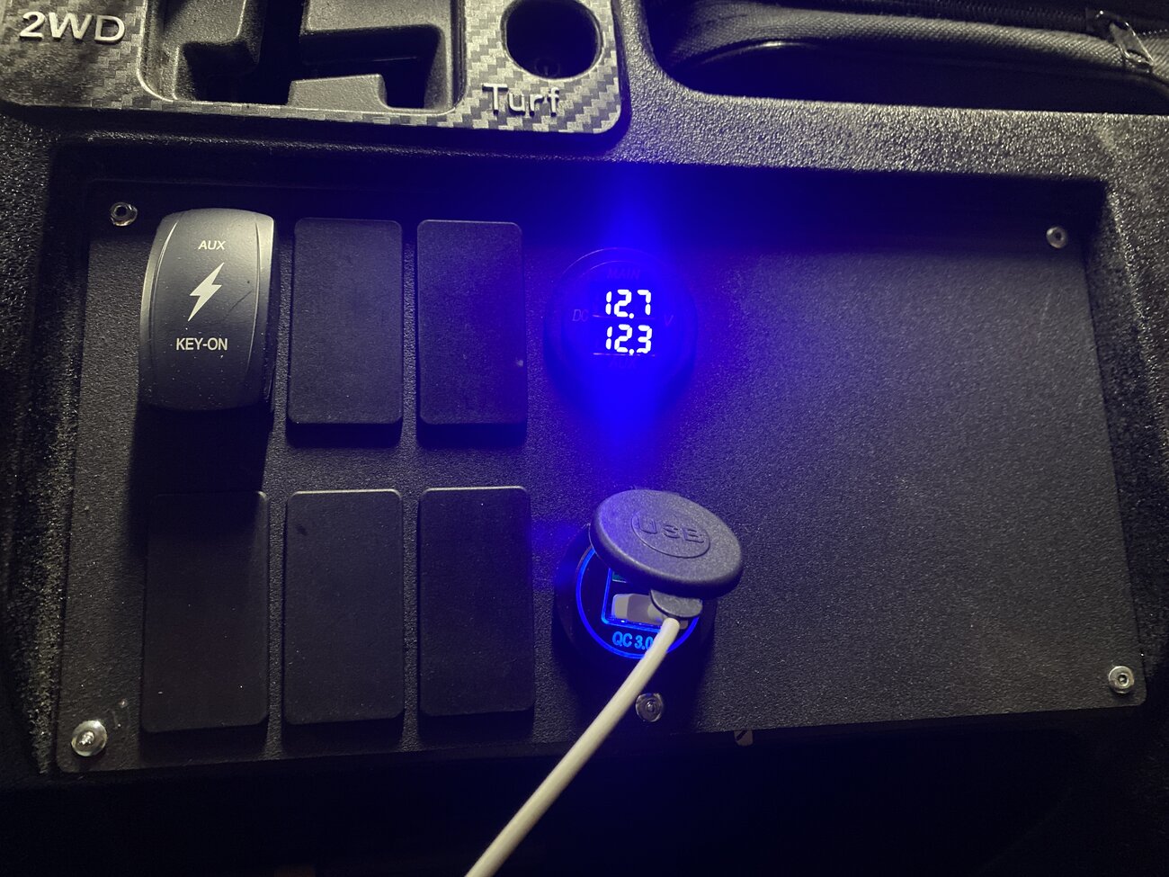

Finished cleaning up my dual battery and switch plate setup. I know a lot of ppl dislike using rivets but for me, they will be MUCH easier to mess with than trying to hold onto a nut to remove a bolt/screw. Couldn’t have done this without the help of all the people on this forum!
I also gotta say that I really like the fact that I can have accessory juice with key on or key off via the DPDT on-off-on switch.

Very cool
