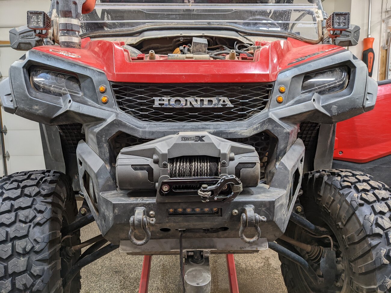

Turns out my spare Superwinch was more than full of mud. It previously stopped going to free spool and it was full of mud. It also had a broken magnet mount and the motor was locked up with corrosion and mud. Motors are indefinite back order.
Enter the replacement winch. Traveller 6000. Very similar line speed and power consumption to the Superwinch and 6000lbs pull capacity with a wireless remote. Even the wife said " it looks cooler on there"
We will see how this 3 year warranty works. I'm certain this will get used. I'm a bit worried about only 45ft of cable but give it a year and I'll have 55' of Amsteel rope on there. Otherwise there's 55' of Amsteel in my spares bag when the stock stuff comes apart. Winch definitely looks like a beast and sounds better/smoother than I expected

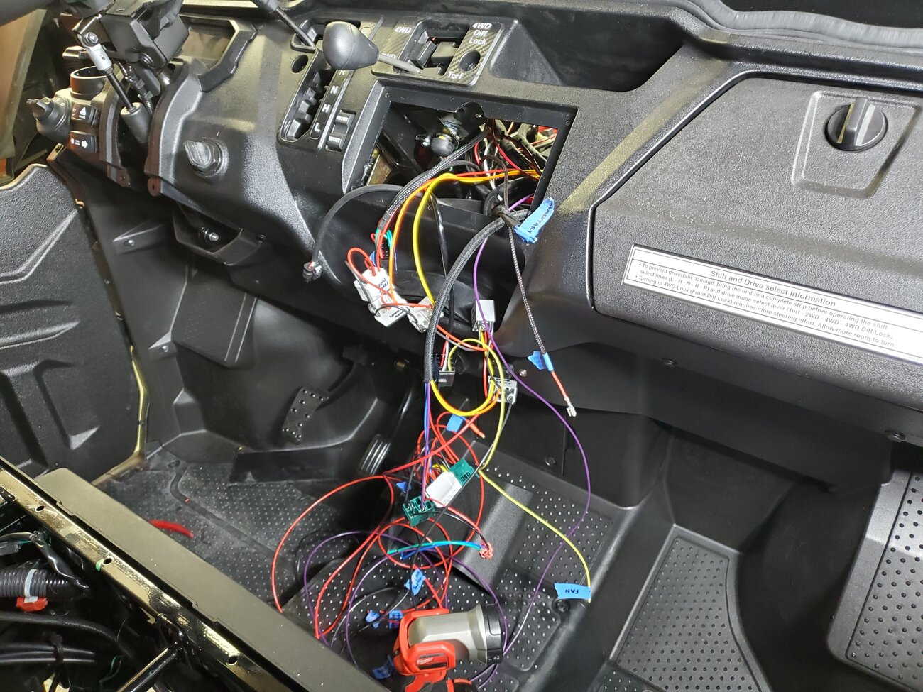

Worst part was I put it all back together and the dash cluster was dead. Somehow the plug came out on the dash side so I got to tear it apart a second time. :rolleyes:
Horns are sooooooo easy too, I can't believe they made you have to get that deep into your front beak. Power source + to temporary button, button to horn terminal, other horn terminal to ground = beep beep!. I got my horn and button on Azon and it was easy enough for my idiot level of skills, I do like to use factory accessories but horns are just so easy. I hope your frustrations are over!

@ToddACimer I was just reading the Q&A on your winch and guys said it wires straight to the battery without any kind of relay, and one said it burned down his battery when it shorted. Is that the case?
Scoop
Scoop
Sep 7, 2021
5,325
20,985
  3. Talon R LV
Relays can't handle the amperage that most winches draw. That's why you should connect the main lead directly to the battery and then the positive low amp lead for the contactor to a switched 12V source.
That said, while my winch primary lead is connected directly to the AUX battery, there's a fusible link in that line. While not a perfect solution, it would protect the battery if anything after the link was shorted out or damaged.
There's a winch solenoid under the cover above the drum on the Traveller 6k. The only downside of this is the hot leads from the battery are hot all the time from the battery to the winch. With my Superwinch setup the leads to the winch were only hot while winching, because the solenoid was next to the battery. If I crush the harness from the battery to the winch it has a potential to short that doesn't exist on a winch setup with a remote solenoid. My rear winch is set up with the solenoid under hood and I'm a bit happier about that but I made sure to route the front winch cables out of harms way and I wrapped them with a cable guard.

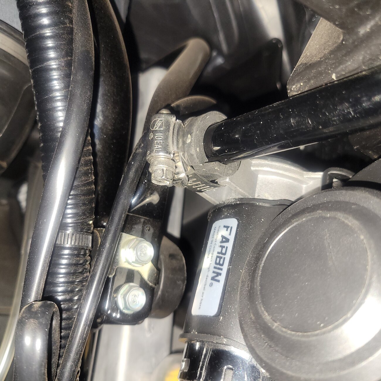

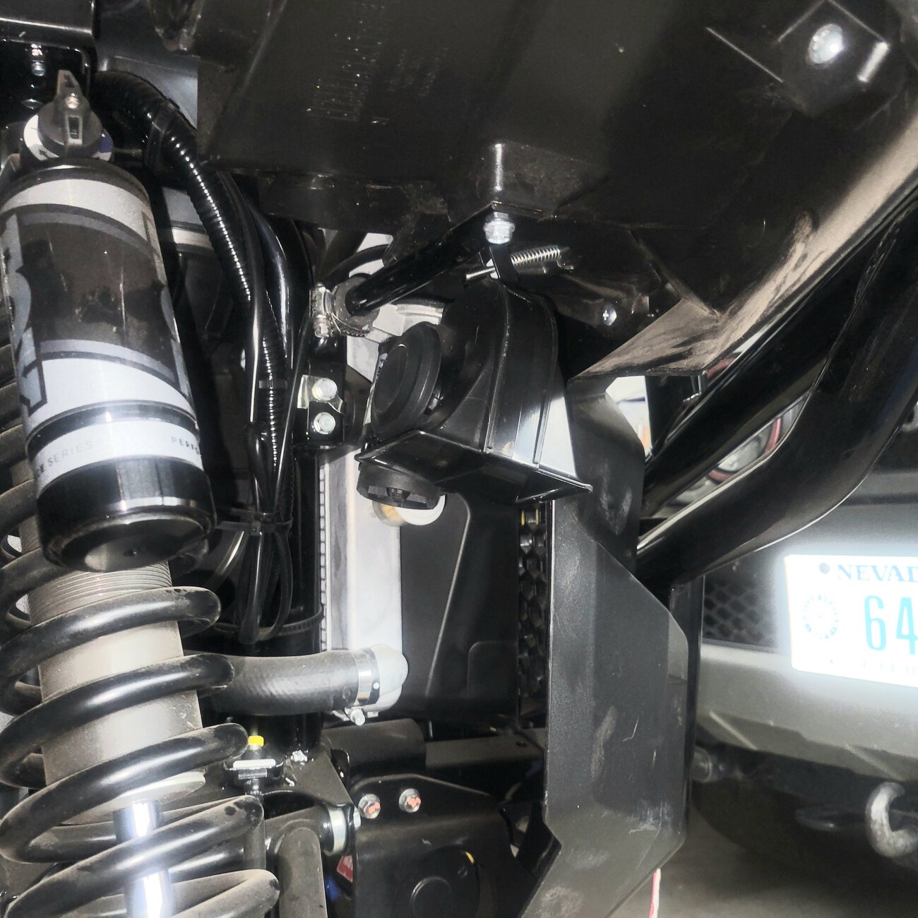

What? No horn?

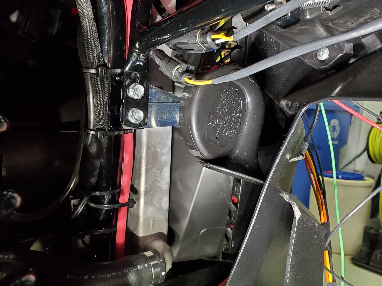

Wanted a loud horn, like an air horn, but not with the big trumpet mounted on the fender or roof. So a compact horn was in order - This one: Horn
and Horn button
Now where to mount the dang thing? It mounts with a single bolt (included) but I just couldn't find a good spot out front for the provided mount. After adding an AUX battery etc. under the hood, no room for a horn there. Inboard of the wheel well, offered some hope, but didn't want to hang it off plastic. There is a steel tube strut, inboard of the wheel and up high, that support the forward fender assembly. Fortunately, there's also a thin slot on the horn mount casting that accommodates a SS hose clamp. I used a bit of rubber hose, over the tube, to provide a shock mount and prevent any damage to tube. Cinched the hose clamp down tight and it's a nice solid "shock mounted" install. Oh, and it's loud.
View attachment 298900View attachment 298901
I linked to a black button, which I have on order, but I used a SS button I had in stock . . . might switch it out later. A relay is required. I used the relay that shipped with the wiring harness, but didn't use the included wiring as I wanted heavier wire (12 GA).
Inside the left front fender, that only requires you to pull a few rivets, there is a lot of free space, actually inside both fenders have room.
