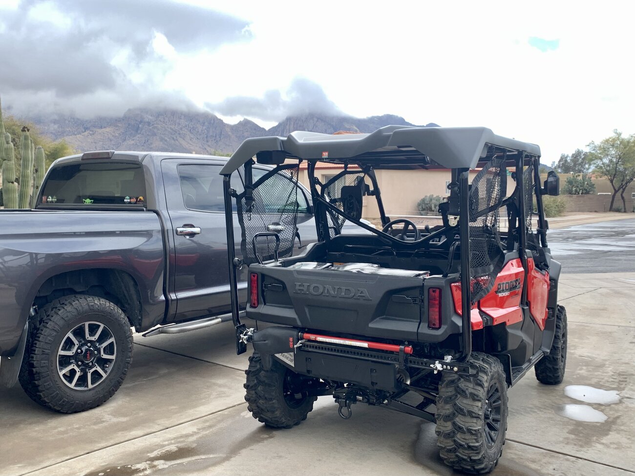

Did you see mine from awhile back??! Same Idea, but yours (or mine) is upside down. I added a bit of resilient closed cell foam in the jack base so it wouldn't rattle around. Also, hard to see in picture, but I cut a bit of 1.75" ID tubing for the U-bolts to clamp against the roll bar - as I was unsure of the roll bar thickness and didn't want to risk denting it.

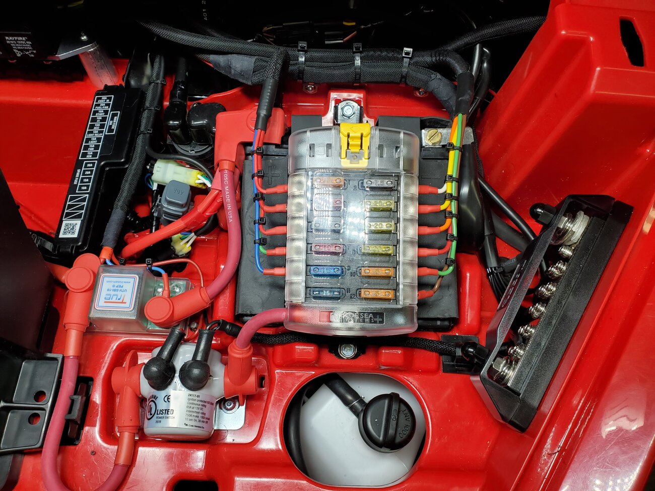

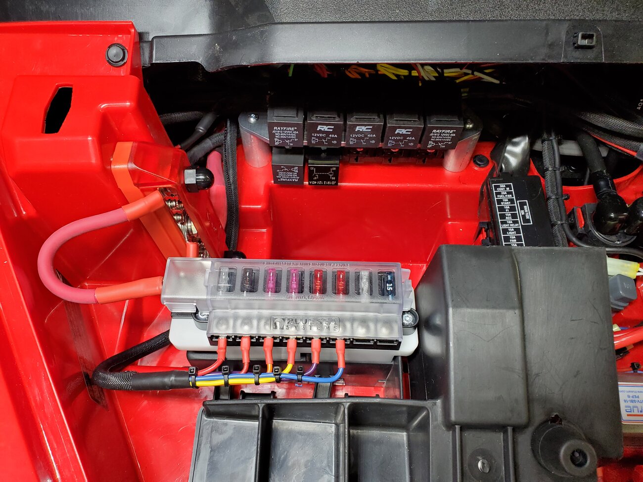

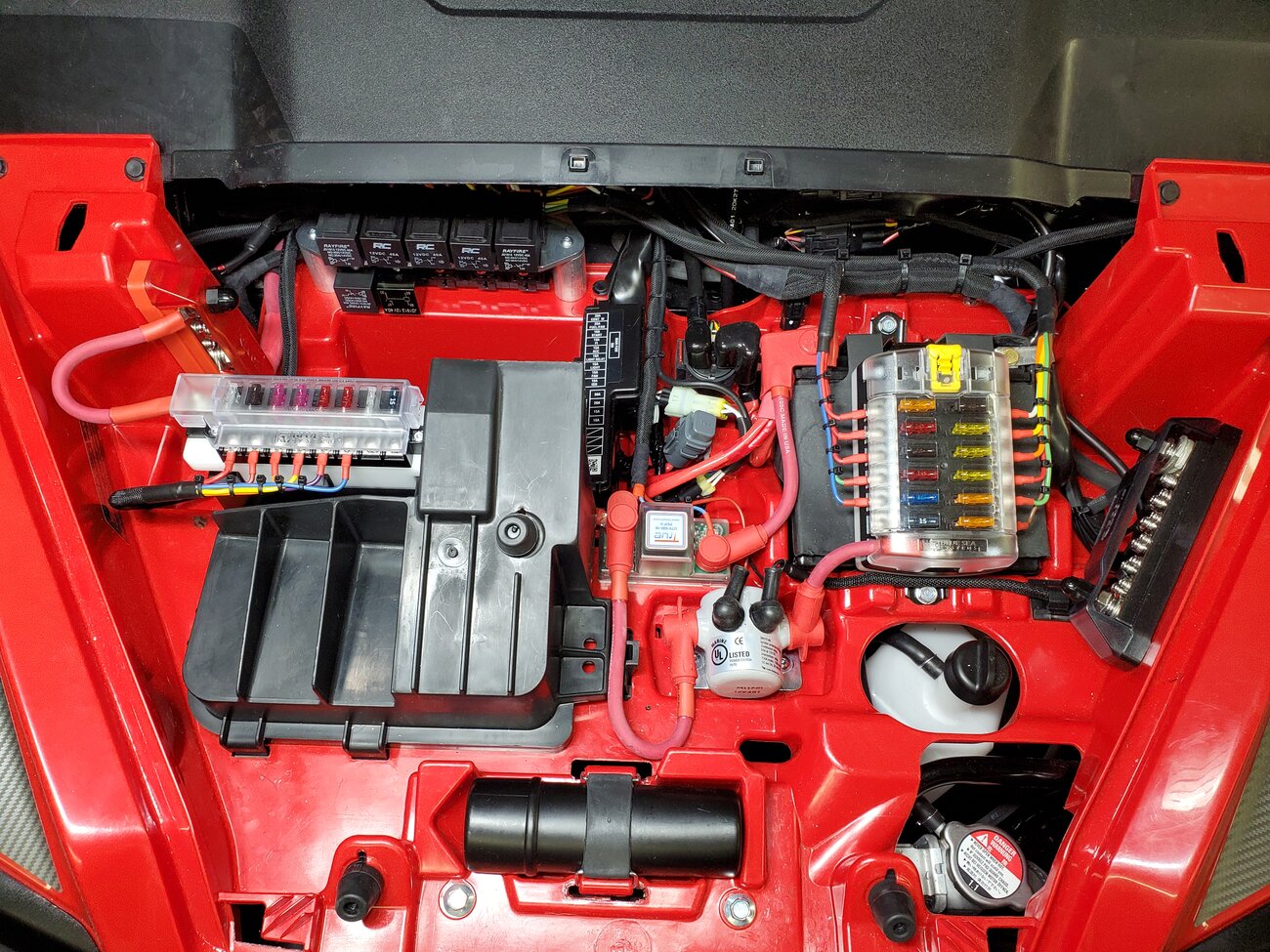

FINALLY finished terminating wires today and tested everything. Much to my relief, everything worked perfectly. BIG thanks to @Hondasxs for all of his wiring harnesses that I purchased. They are fantastic! It was nice to get the hood & seat back on after what seems like a couple of months of on & off wiring on this thing. Next is to machine & hydrodip the switch panel.

You Sir, Clearly have skills and understanding.

That is probably the cleanest most organized wiring I've seen 😳.........nice!! 👍

Thank you. Seems like I have to slow down and rethink this stuff every time I do it, even though I've been doing it most of my life!
Wish I would've had the patience and self control to do all that before I had my P1K5 dash deep in mud a few hrs after leaving dealership 😂😂😂 hasn't been clean ever since 😂 🤦‍♂️
Thanks! Sometimes I'm not sure it's worth the effort, but I'm recently retired so......
It is not my patience that has kept it so clean. As luck would have it, a buddy of mine finally convinced me to sell him my trailer less than a month prior to placing my deposit for the P5. Between no trailer, not wanting to pay for an OHV sticker with less than a month left in 2021 & needing to install a harness for our special needs son, it just holds down the garage floor while the warranty slowly disappears & I work away on it!
