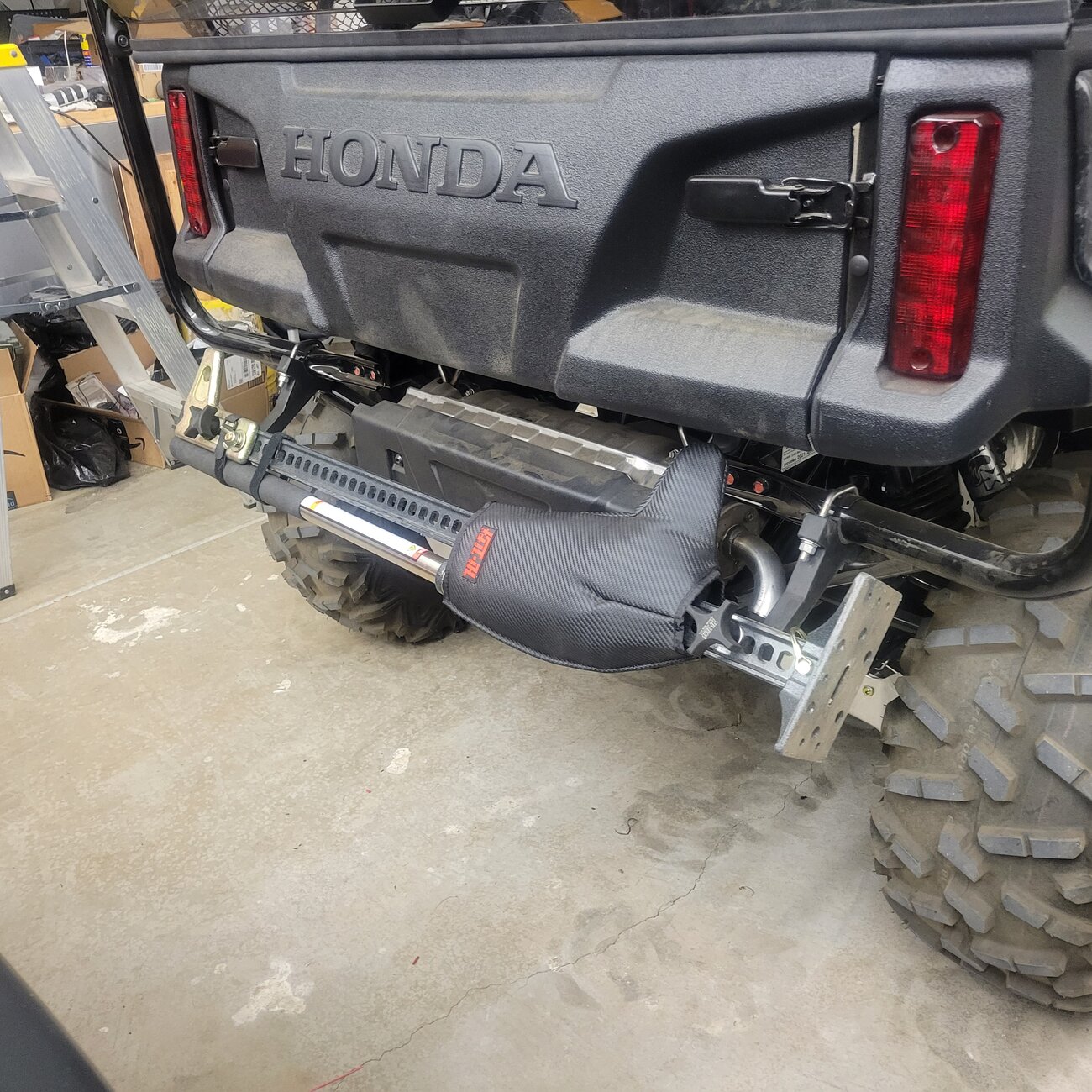

Found a way to mount my hi-lift to take on the trail.
Did you see mine from awhile back??! Same Idea, but yours (or mine) is upside down. I added a bit of resilient closed cell foam in the jack base so it wouldn't rattle around. Also, hard to see in picture, but I cut a bit of 1.75" ID tubing for the U-bolts to clamp against the roll bar - as I was unsure of the roll bar thickness and didn't want to risk denting it.
What brackets are those? I'm assuming they would work with a knock-off hi-lift jack from tractor supply? I like to take my jack when it's just me and my wife camping and not take up bed space. When I have other people with me I just leave the jack at home.

These are what I used - Hi-Lift Jack TM-700 1"-2" Adjustable Tube Mount Amazon.com
Full disclosure - the tailgate opens fine but you can’t dump the bed with it mounted where mine is at.

These here ones!: Hi-Lift brackets They extend out further than the ones AZBoatHauler used, and have an angle to them that affords more options in positioning the jack. It also allows the jack to be placed down onto the threaded studs, so it stays in place nicely while removing or installing it. The jack, but not the mount, has to be removed for dumping the bed.
