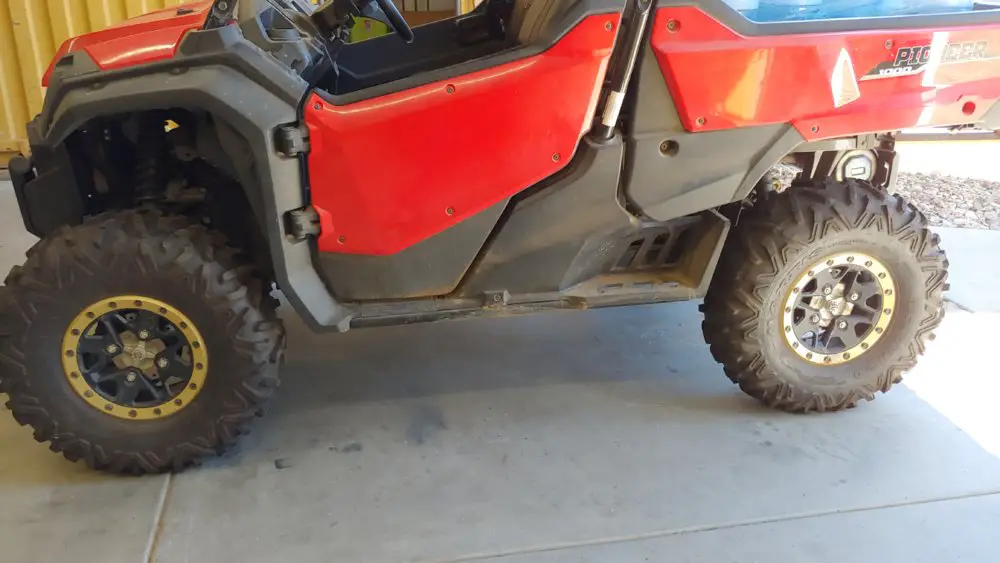

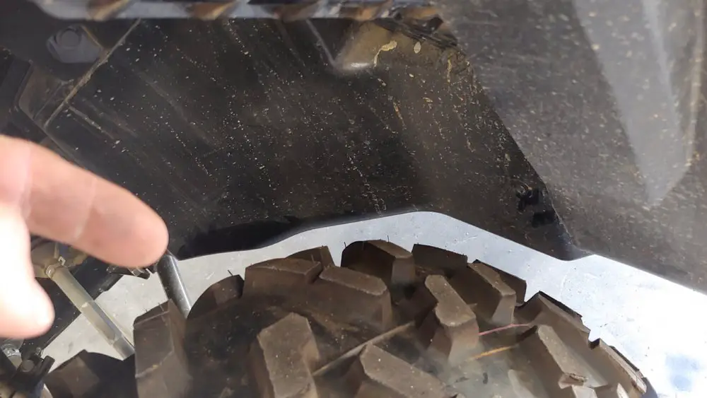

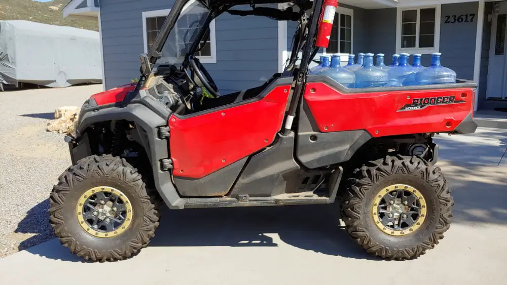

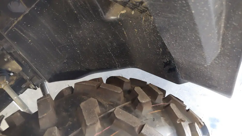

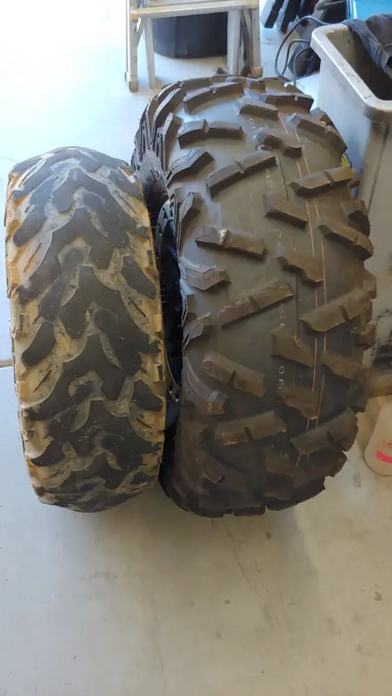

They fit...
Tad bit of rubbing at FULL lock, on the inside of the wheel well (see dark "rub" spot on inner wheel well liner in picture).
Size over stock, is humongous. Actually makes getting in/out of the Pioneer a "lift your butt" up onto the seat, rather than the faster open-door and slide-in approach. Nice to have the added ground clearance.
Not sure if I'll order the +1.5" highlifter a-arms, heat up the inner wheel well and make clearance, or simply run it and be careful to not turn so sharp. I know... it'll be this way until I get tired of it... then, will I do something about it. It's not that bad actually. But I also haven't articulated it into a bad spot on my off-camber pathway down off the back of the property. Time will tell...
WHAT (almost) FITS? Can-AM, XRS beadlock wheel with Maxxis Big Horn 2.0 30" tire (and using the stock Pioneer lug nuts)
It was... either buy 27 x 9/11 x 12 tires for $290/set (plus removal of old and mounting of new, and time to/from tire shop) or used set of 30s on beadlocks, for $400, and I can dismount/mount in the future. Easy math there!

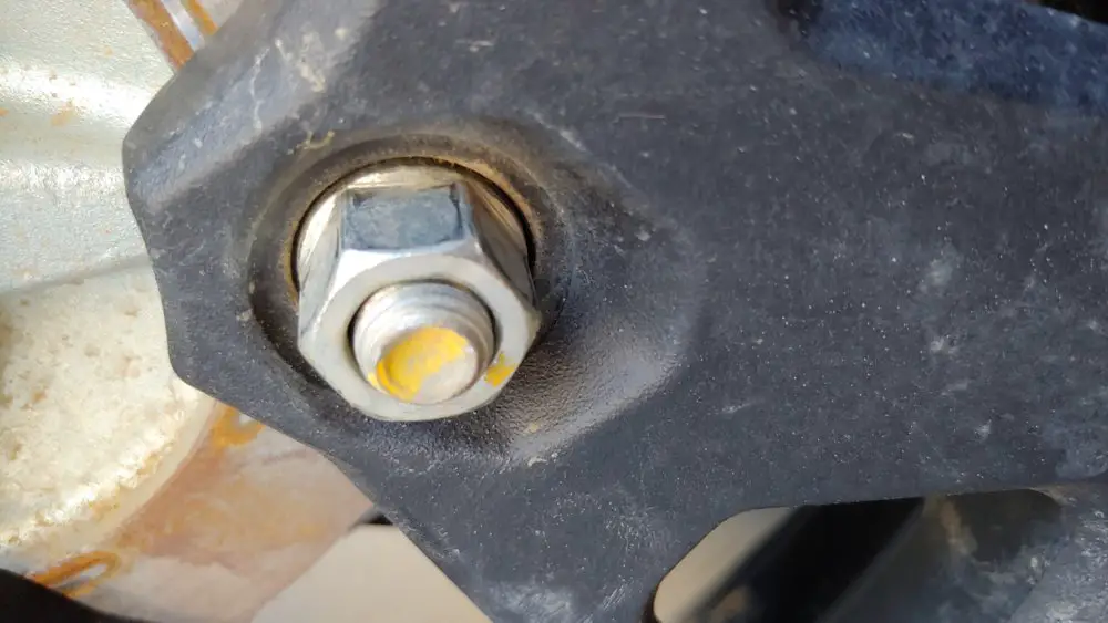

I purchased a set of take offs can am x3 that had 29s on 14” Beadlock 9”ft 11” rears bighorns 2018 or 19 the tires say 8 ply rating on side walls.purchased rims and tires like new 500 dollars.Mine is a 2016 1000 deluxe 5,the offset on the rims is narrow same as Honda 6 1 ft .rear is narrower than stock pioneer.The only clearance issue I had was there is a one inch tube by 3/8” welded to the back side of the lower a frame on the ft that rubbed on the rim on full lock,I cut the tube off and ground smooth ,that cured that.installed 1” spacers in the rear.w can am rims there is no center cap that will work ,I painted the centers black,u can see the castle nuts.The ride w the 29”s is great ,stock suspension height.I have Elka stage 3 shocks on ft adjust to original preset load.Stock load levelers in rear no tire rub w 29 “ bighorns.
