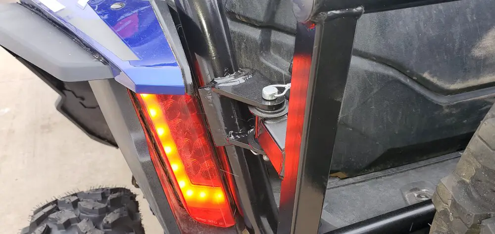

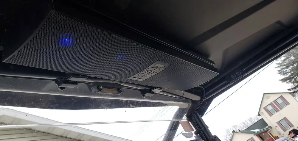

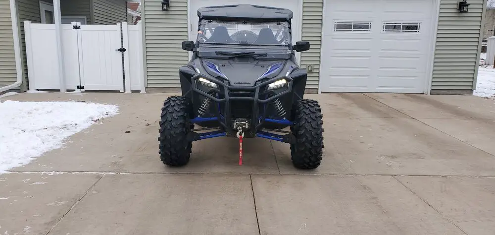

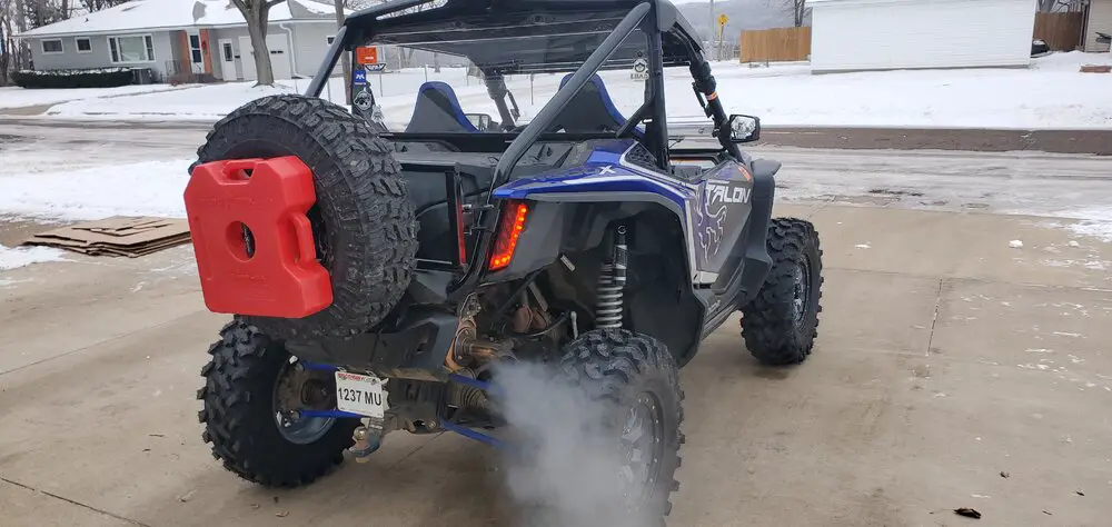

Here is the system 3 installed along with some other pics of things I have done. Memphis sound bar warn 4500 winch kfi winch plate and rear receiver, mud blaster for rear wheels, jei modified spare tire carrier and rotopax gas can. Hated not being able to get in my storage so had swing like a tail gate or just remove it. Super atv windshield and honda rear window. And stainless.exhaust tip.

How do you like your tires and wheels So far? Are those the 6+1’s in the front? I have the same tires sitting here waiting on the same wheels, I ordered the 6+1’s all the way around since I’m already running spacers. It’s nice to be able to rotate tires front to rear to help even out the wear

6+1 and 4+3. I don't have spacers. I like the look and stance but besides two donuts in the street not many trails up here open and not enough ice for lake riding.
