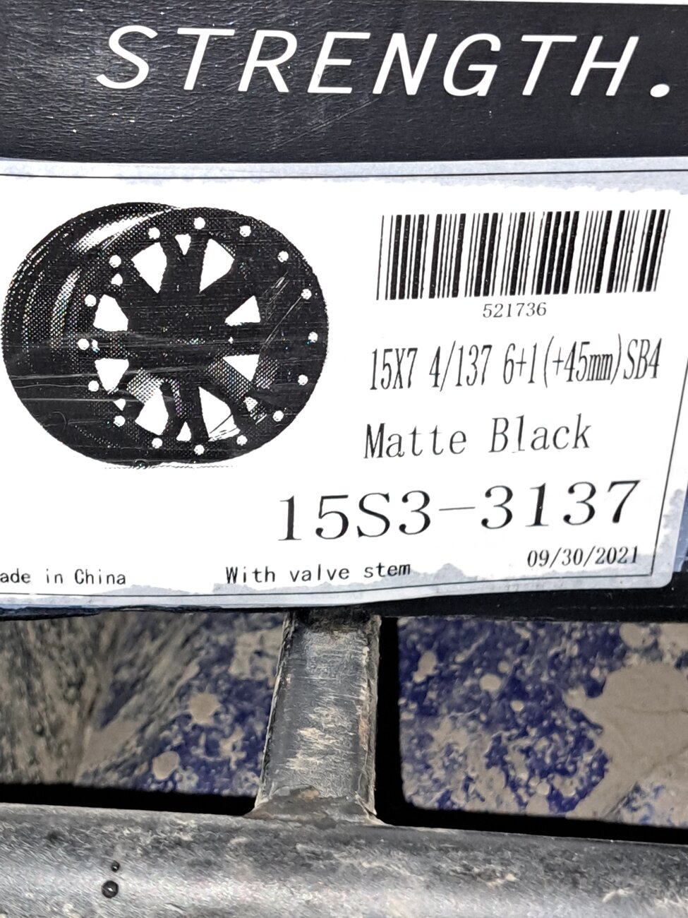

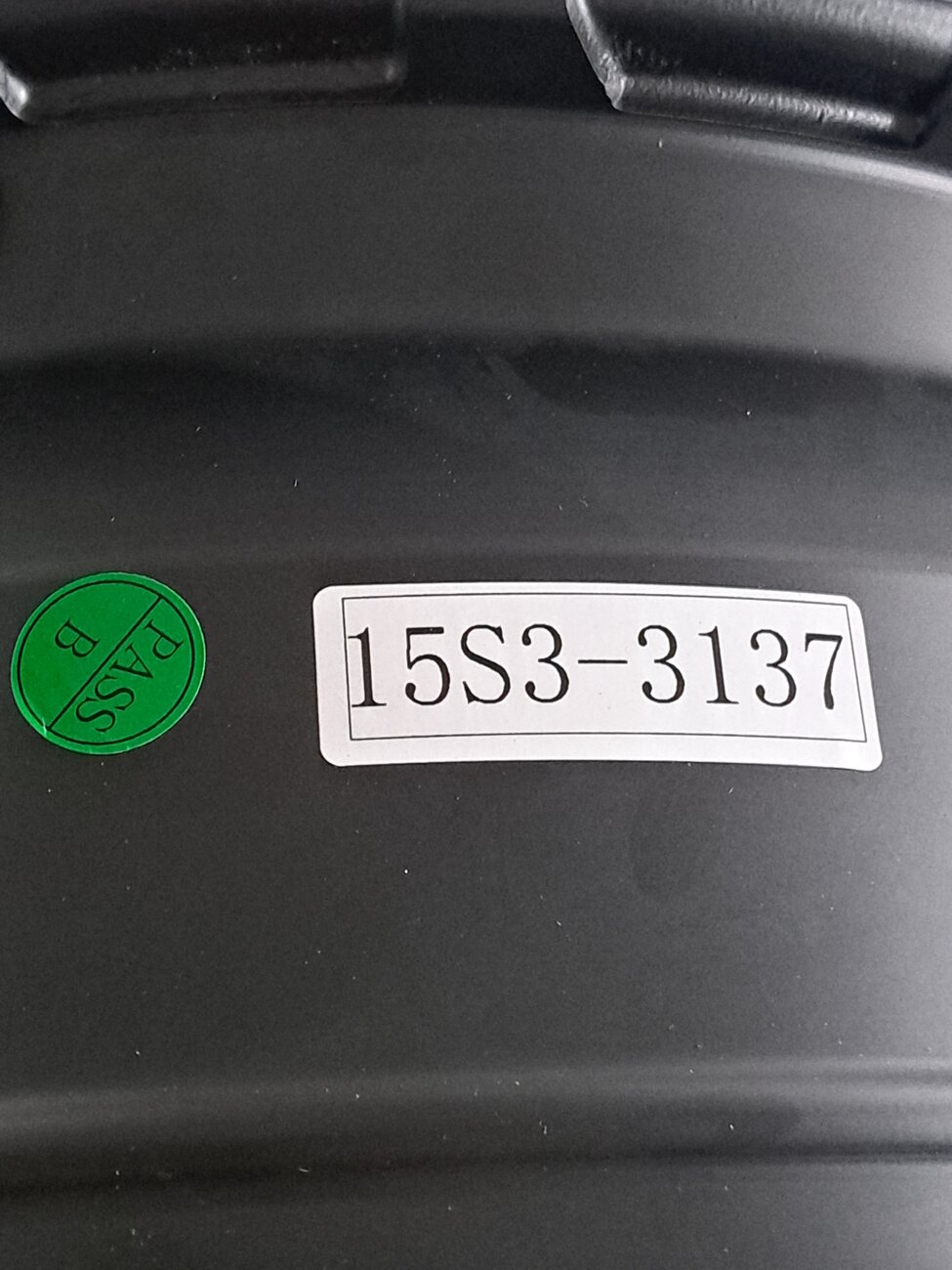

Wheel #1:
System 3 SB-4 matte black
15x7 4/137 6+1 (+45)
mfg item #15S3-3137
Wheel #2:
STI HD9 matte black
15x7 4/137 6+1 (+50)
mfg item #15HB928
These 2 are really popular, especially if you want to square up a Talon with beadlocks without adding much more width. I also found them to be the cheapest and both are decent looking wheels. Definitely not as strong as a forged wheel or even an American made counterpart but wife looks at bank account, not the quality of wheels I buy for my toys.
I ordered 1 of each to compare. Weight will be most important but also quality as I assume both are made in China.

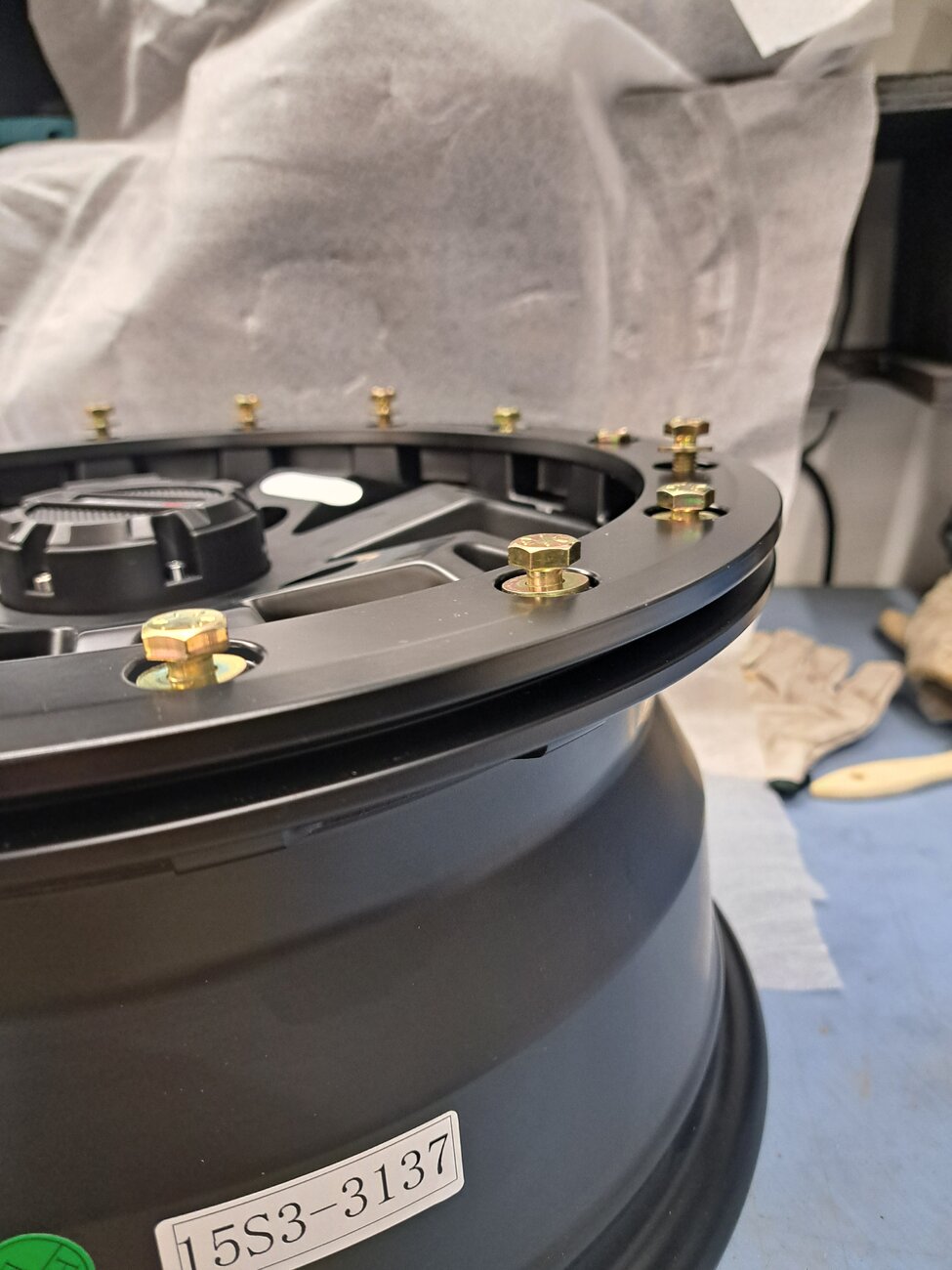

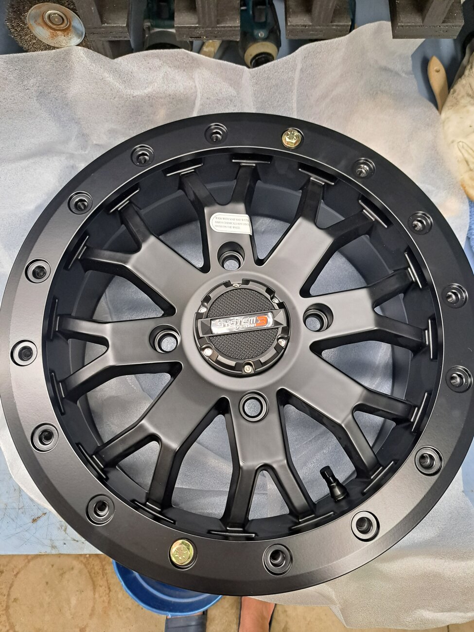

System 3 SB-4:
The basics:
20230823 18365620230823 18362620230823 175802
The candy:
20230823 18003420230823 17572320230823 17564020230823 175623
The stats:

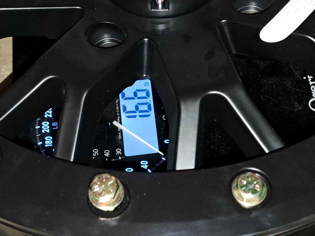

20230823 183206
16.6 lbs. With all beadlock bolts installed.

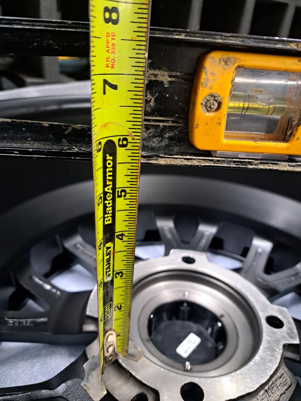

20230823 181222

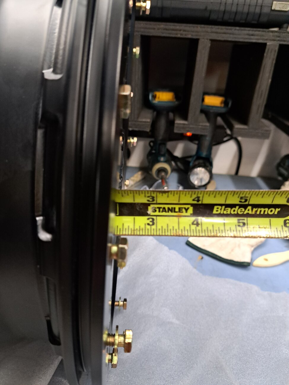

5.5" backspace
20230823 182809
2 3/16" from flange face to beadlock ring face

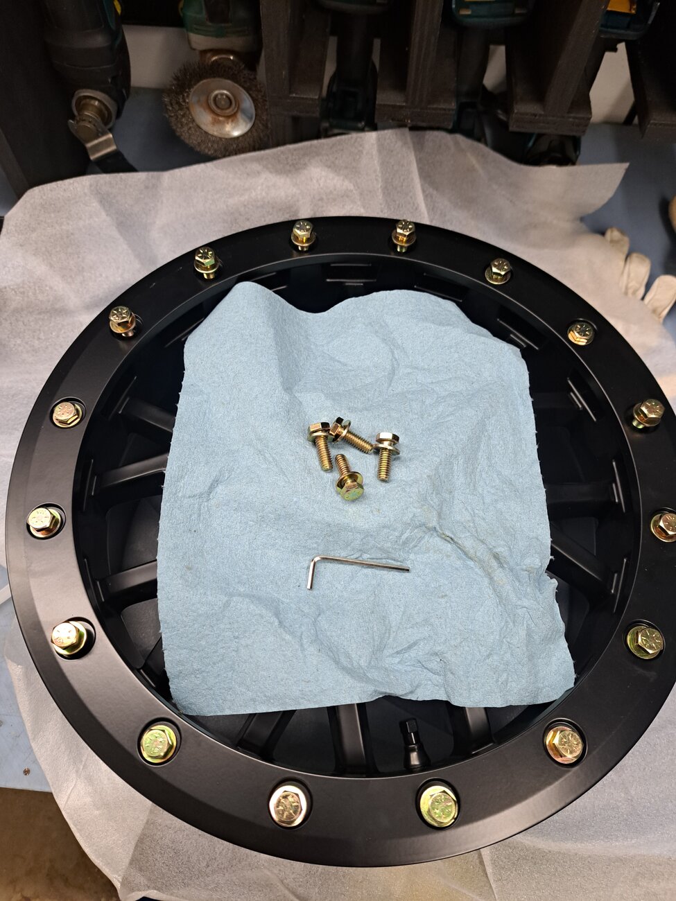

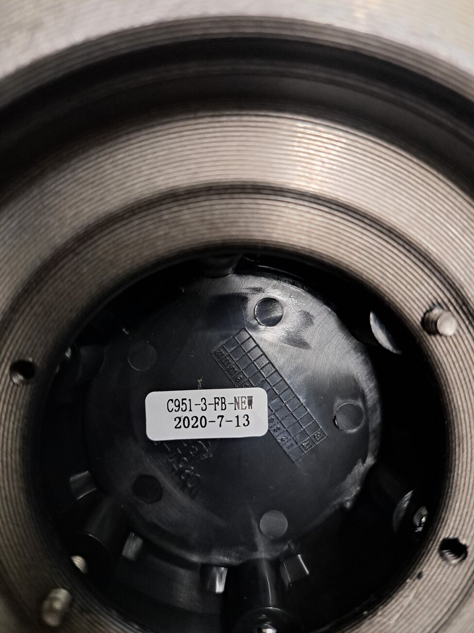

20230823 182135
4 spare bolts + allen wrench for center cap

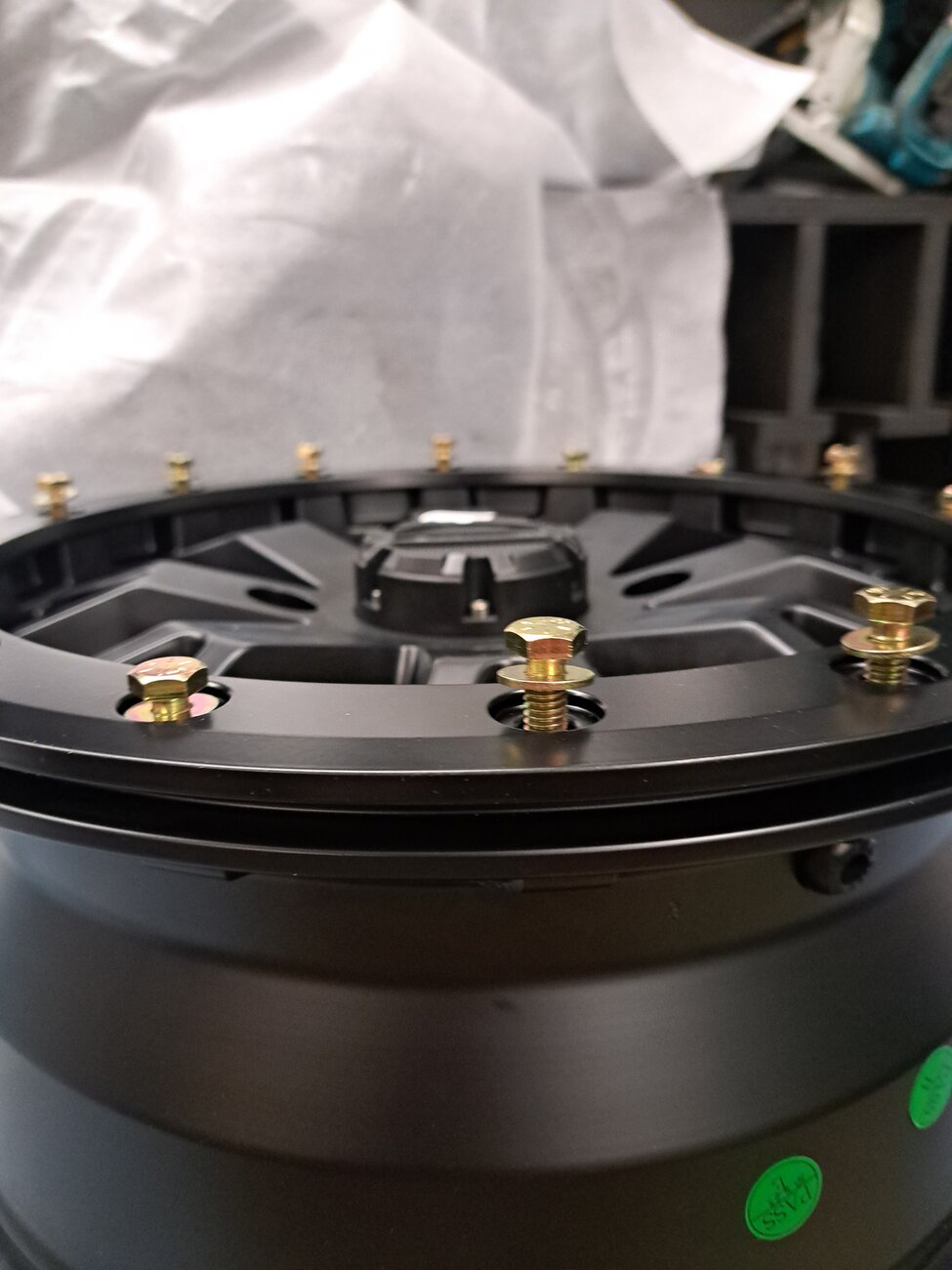

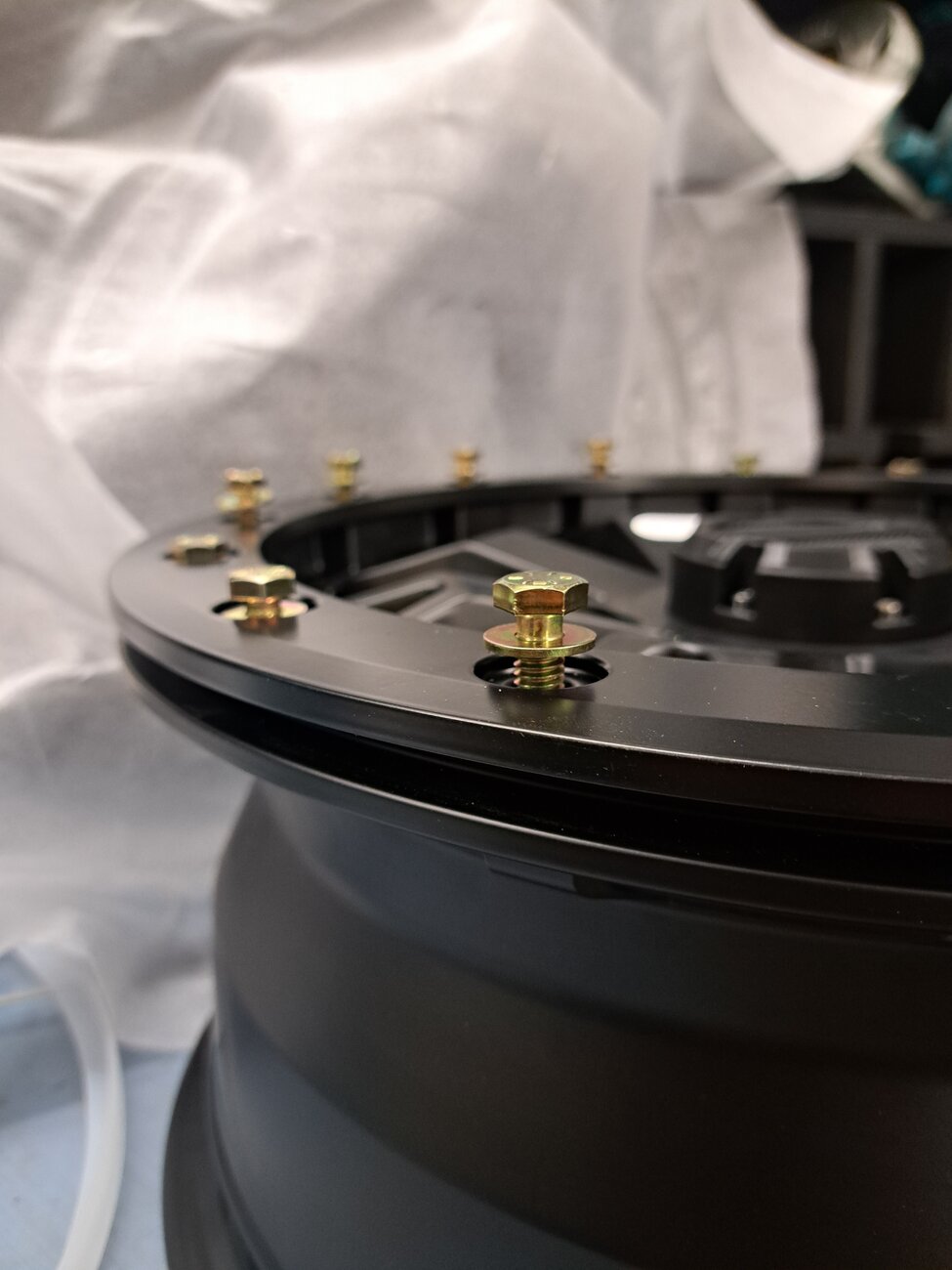

Extras:
20230823 18224320230823 182247
I could only run 2 bolts down by hand. If I keep these, I'll use a thread chaser to clean up before install.20230823 182253
View attachment 400472 20230823 182809

NOT SCIENTIFIC W/BATHROOM SCALE!!!
Weights were all over so I changed batteries. System 3 stayed same at 16.6.
STI came in at 16.6 without ring bolts, sorry 🙄

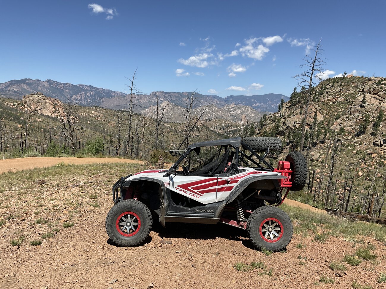

Love my STI HD9's. Note that the 15" wheels weren't available with red beadlock rings, I painted mine with the last tire change. I'm used up on blacked out everything on SxS's but that's just me.
I'm tired of black too. I'll do a colored ring also...likely red👍
If I remember correctly, I saw the colored rings available for the 14" only.

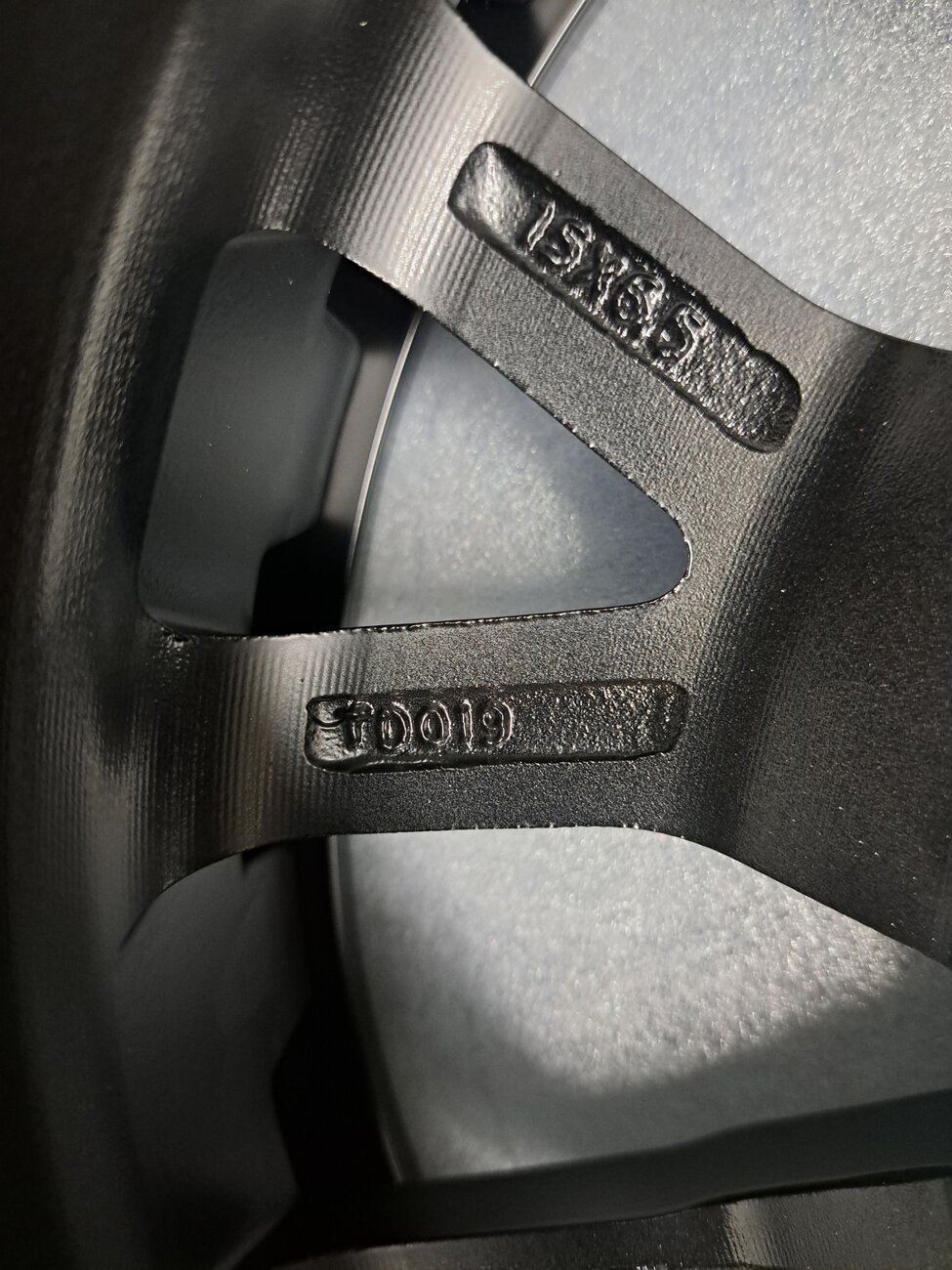

That rim is marked 15x6.5 not 7.
Having to chase all the threads on something brand new is why I hate buying made in china stuff. There's some MFer somewhere getting rich from our purchases and we get to do some of the Rework before it can be used.
