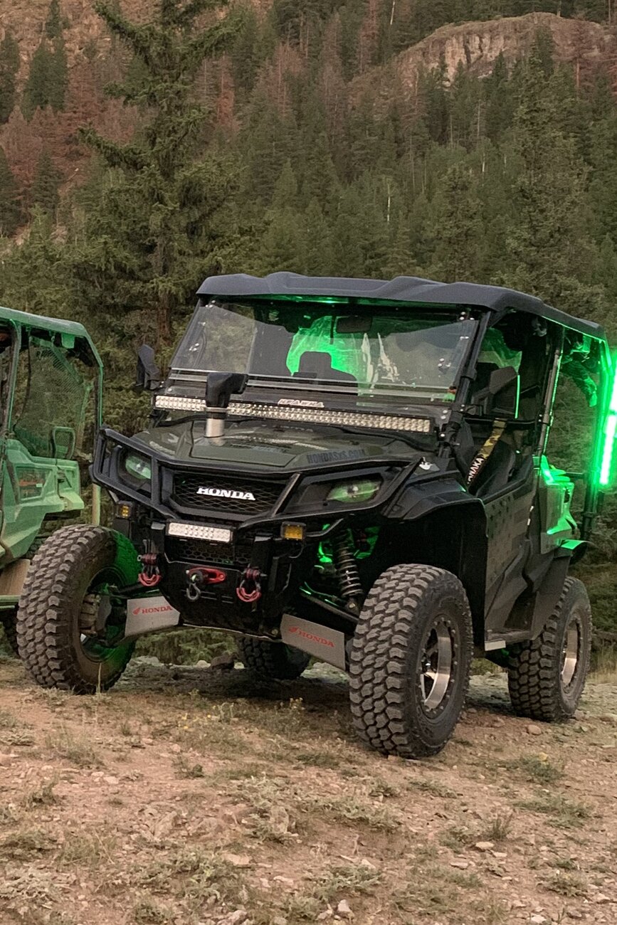

The @RB3offroad P1k wide bundle kit is what you need. kinda have no choice with what you have. Its only giving you 2” wider total in the front. Thats what i have with dam near your set up.
