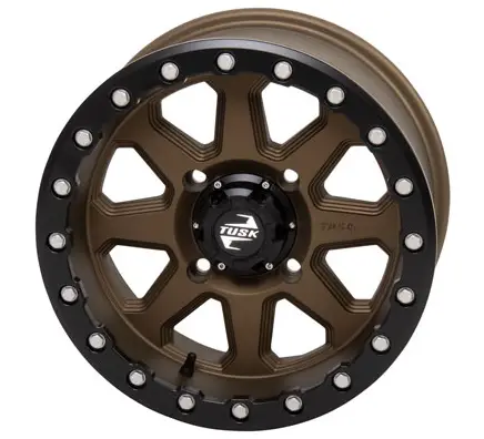

I've, again, narrowed it down to the following two 15x7 5+2 in bronze.
It's a beadlock vs a non-beadlock for the exact same price: Tusk Uinta beadlock vs Raceline Krank.
View attachment 382389View attachment 382390

I had bad luck with 5+2 raceline beadlocks. The 5+2 Racelines had a 30mm offset as I recall and they stuck outside the OEM brake caliper shields. I broke 2 wheels one day when rocks got stuck on the calipers. Ended up needing 2 wheels, 2 calipers, 2 caliper brackets, 2 hubs, and 2 rotors. Since switching to non bead lock wheels I've only popped a bead once and the tires have never leaked like the beadlocks always did.

Those Raceline A94 Kranks are non- beadlock wheels and are listed as 5+2 +10mm. Thoughts?

5+2 +10mm is what I run now. They don't look as good but I haven't had any issues

5+2 +10mm is likely a 4+3 wheel regardless on how manufacturers label them. It is either a 5+2 or +10mm offset, it can't be both as the math doesn't work. 7" wide (178mm) = 99mm (3.9") x 79mm (3.1").
@Scoop If something is listed both ways, I'd ask them to verify if it is one or the other before buying them.

I agree, and that's what confuses me. I've seen the same wheel listed on the same website with one description saying "5+2 +10mm" and right below it, the same wheel listed identically but "5+2 +38mm". I'm like ... WTF?!

Well, we can let this thread simmer down to a slow boil. Just placed my order for five each of the following:
Tusk Uinta Beadlock Wheel 4/137 15x7 5.0 + 2.0 Bronze
Tusk Aramid Terrabite 10 Ply Tire 30x10-15
Plus Tusk tapered chrome spline lugs (21), a spline lug nut key and a nice Tusk Extendable UTV Lug Wrench Kit to throw in the trail bag.
They said they would assemble and ship today. Guess I better get working on that a-arm tab reinforcement project and installing the SuperATV a-arms.
Thanks for yet again, helping me spend more $$$ ... 😄
