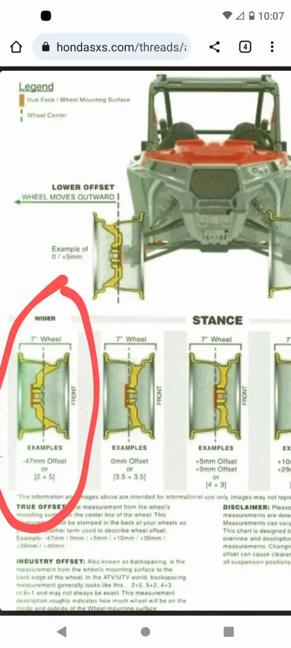

47mm is probably getting closer to 1+6 or 6+1 depending on the direction as they probably just round up since it's greater than 5". I'm sure that at some point a higher positive offset (30mm) is considered 5+2 vs 4+3. Using a 1" scale to describe UTV offset is a pretty coarse scale. Truck and car wheel offsets are all typically measured in mm.

I'm no expert but.....47mm??
And just my 2 cents.....
Unless you're the type to rock crawl or do aggressive riding with real low PSI I don't see the need for a true bead lock really 🤷‍♂️ if you really like your wheel choice I wouldn't go crazy over a different choice just cause it's a bead lock wheel. Also just a FIY....not all tires work well with bead lock wheels.....just something to consider as well when purchasing

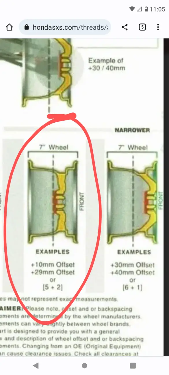

My mistake @Scoop I misread the diagrams posted by @Wisco-Tango
This should be a little more clear, yes.....you want the 10mm off set, that's close to a 5+2.......🤔 I think?? 😂

I was just going off the chart that was posted.....47mm ~ 5+2 offset.
I'm sure there's some wiggle room in there being that every (7" wide) wheel sold isn't really an exact 7" wide....or any other size for that matter. So the "5+2" offset is more of an approximate guid 🤷‍♂️
The good ol'......close enough!!! method
All this is a big close enough, as the 7" is probably an approximation too.
Nope. The point I was making is that +10mm is almost a perfect 4+3. vs the 5+2 that the RB3 chart calls them.
I think the real question is what size and offset are the OEM wheels. That would make this whole offset conversation a lot easier to figure out.
Oh gotcha.... I'm a slow learner 😂
I think most people say the P1K stock offsets are 6+1 fronts and 4+3 rears....
When I bought my wheels from Race Line, they sent me 6+1 for the front and 5+2 for the rear and they are the same stock width as OEM front and rear.

Sure looks like the wheels in question are 4+3, so I'm not sure exactly what size spacers to order for front & rear.
@Remington said "go with 5+2 and yes the wide track bundle", but ... I can't go with 5+2.
I don't want to order these wheels and have them not fit (regardless of spacers used). That would be an expensive mistake.
This makes sense assuming the track is even front to rear from the factory. Having to add a 1" spacer to the rear if using a 5+2 setup all around would keep the same front to rear track. It would just widden the overall machine by 2".

Welp, I'm gonna steer clear of 4+3 wheels, so the Fuels (above) are both out.
I've, again, narrowed it down to the following two 15x7 5+2 in bronze.
It's a beadlock vs a non-beadlock for the exact same price: Tusk Uinta beadlock vs Raceline Krank.
