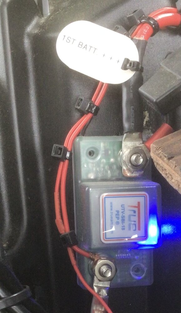

Go with True, I bought the kit and did the install last week. It was easy and simple, if your gonna be in electrician mode then go ahead and a fused bus bar and stinger solenoid.

This is my setup

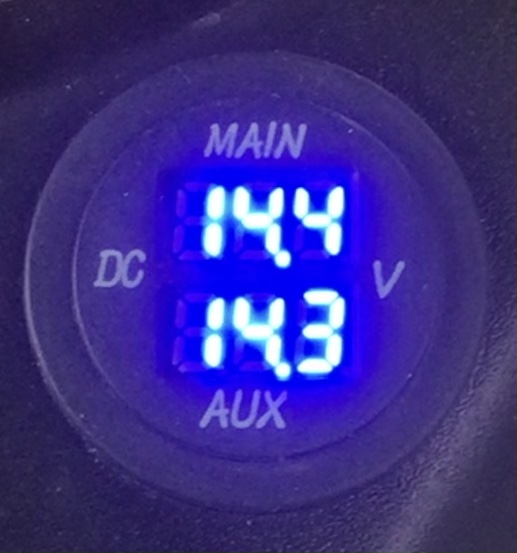

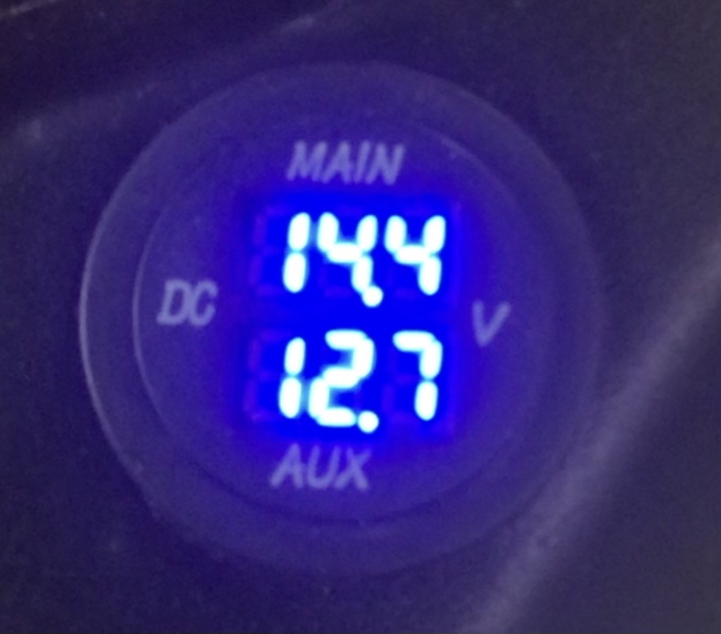

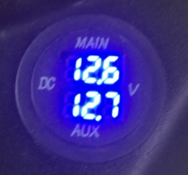

I have the Ture and no problems. Get the dual gauge to see what is going on.
1st photo is key on.
2nd photo is engine just started.
3rd photo is both batteries connected.
Good job DIRTBILY, looks better than mine.
