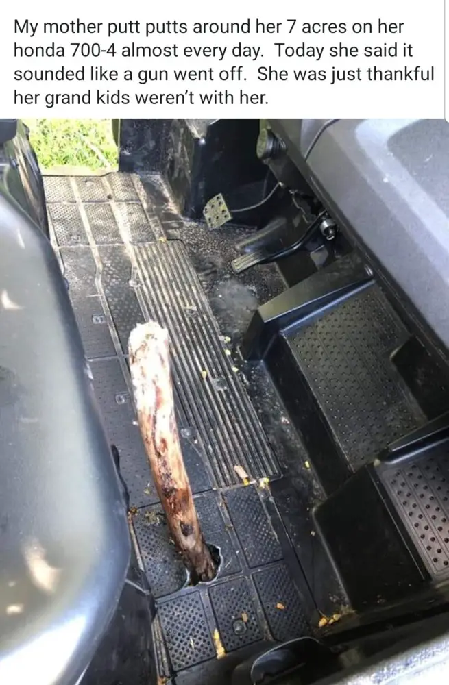

This was just posted on Facebook, P700. What if this happened to you with a child was in that seat and having proper underbelly protection would have prevented that from happening.
Full coverage skids, a wise investment.

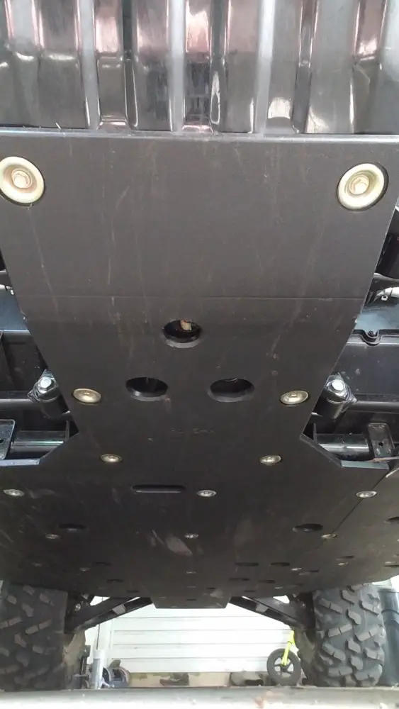

Definitely an investment to protect your machine and your legs. DIY wheel well plates and a skid plate that took hits.
