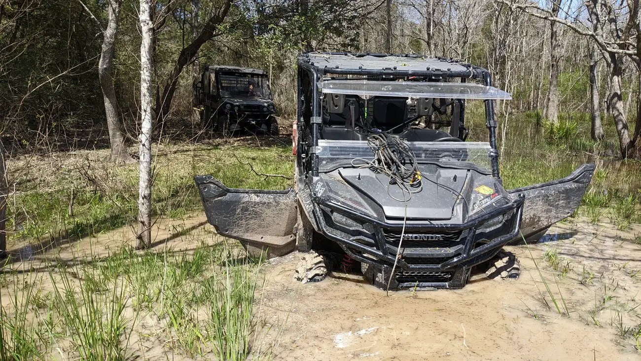

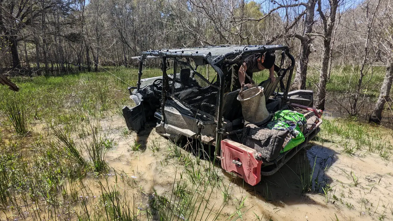

Pics
PXL 20220326 184929507 PXL 20220326 175358625
