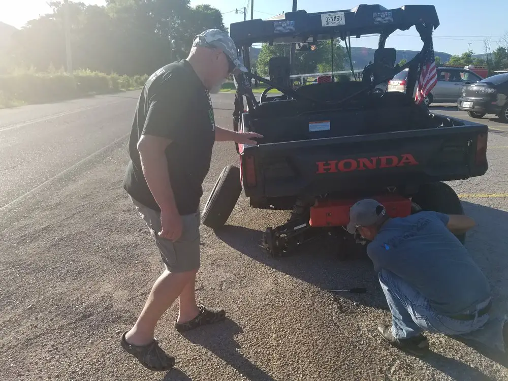

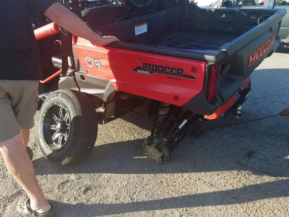

Who in the hell tightened those lug nuts or loosened them?o_O I want a full investigation and I want it now!:mad:
Went for ice cream after supper and made it halfway back to the house. Bang, the left rear dropped on the road and my tire and wheel went rolling by me. Lucky for us I was going about 20mph on a secondary road. I figure those 3 seaters have way more power and just twisted the wheel off.;) Of course I took my jack and lug wrench out of the Pioneer a couple days ago... Lucky for me there are good people in this world who wanted to help...:) Didn't bugger the studs and all four lug nuts were laying in the road about 30ft apart. Nothing tore up when I went dragging the left rear on the road either.... whew! Top that you axle breaking, A-arm bending whippersnappers!

You need the tapered lug nuts for those wheels. The Honda lug nuts have a round taper. The Honda lug nuts can damage the aftermarket wheels. You need to torque them with a torque wrench.

lugnuts are tapered... ones that came specifically for the wheels and I don't need a torque wrench to know I have them tight. Any more torque and I'd have twisted them off.

so there is a reason most tire shops want you to recheck the torque after a few miles. Steel wheels you can probably get away with hand tightening, I think even, proper torque is in order for aluminum wheels. I use my torque wrench on lug nuts all the time, mainly because its longer than my tire iron. Glad you and mama are ok dr.
