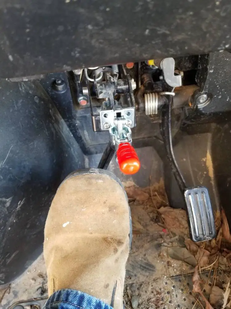

I got my Lavalock bbq lever lock but have not tried installing it. It appears to me that it will require some kind of bracket. Can someone post an installed photo of this Lavalock. Thanks.

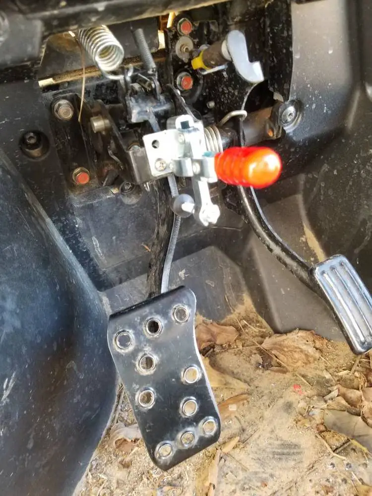

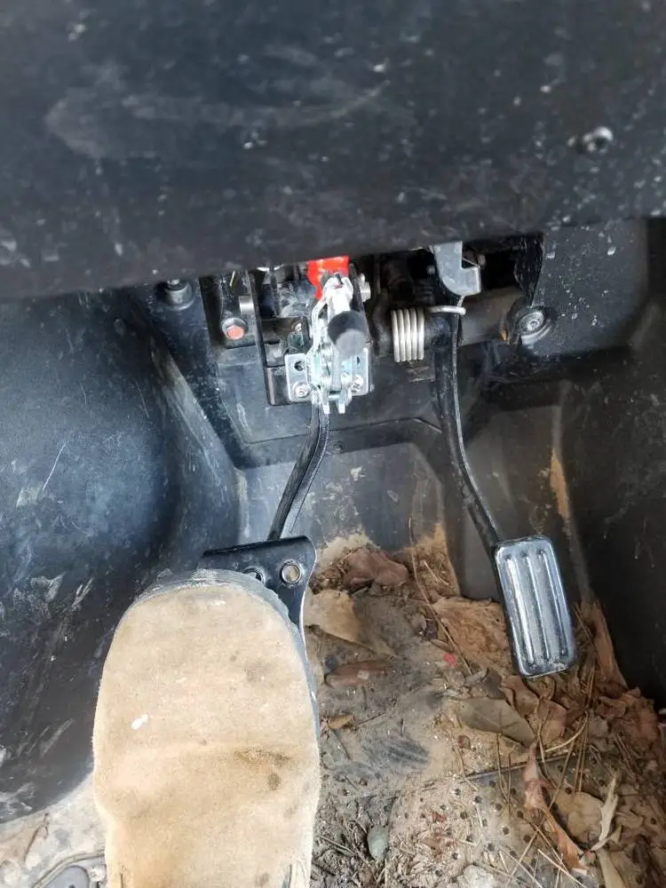

I actually drilled 3 holes in the stock bracket to mount mine and used 10-32 bolts to mount the clamp. good clearance for my feet. thanks guys saved me some time searching for a good clamp. 9ca230702e3258c4a57989d4af3688d40766c80ab8d4cfb1b99e87ba03670c750fc9922798b5655c904011938a1b2f03

hadn't had a chance to test it riding wise. I will be at mulberry this weekend so I will see if it falls on the petal while riding. if it does I might just add a spring or something to keep it up. really. simple install.
