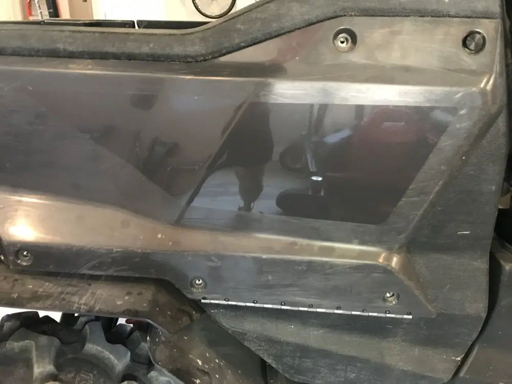

Decided to copy @joeymt33 door mod and I cut holes in the rear doors. Wow those things are cavernous. All the gear I usually carry in the bed can now be stored away in the doors once I get different storage bags that fit better. Hopefully it stays cleaner, the extra gear weight is much lower, doors don’t rattle, and the bed is free to be cargo or people much easier than before when I had to rearrange everything or pile stuff on top of other stuff.
The ONLY a downside I see is if I am leaned into the door panel that has my recovery gear stored in it. I may keep a short tree saver and block in the glove compartment.
I ended up mounting the stainless hinge to the plastic panel first. Then remounting it to the door taking a piece of masking tape and lining it up along the bottom side of the hinge marking each end then removing the panel and lining the hinge up so that it was in the same place. A few rivets later and she’s done it was quick, maybe 30-45 mins.
View attachment 76048 View attachment 76049

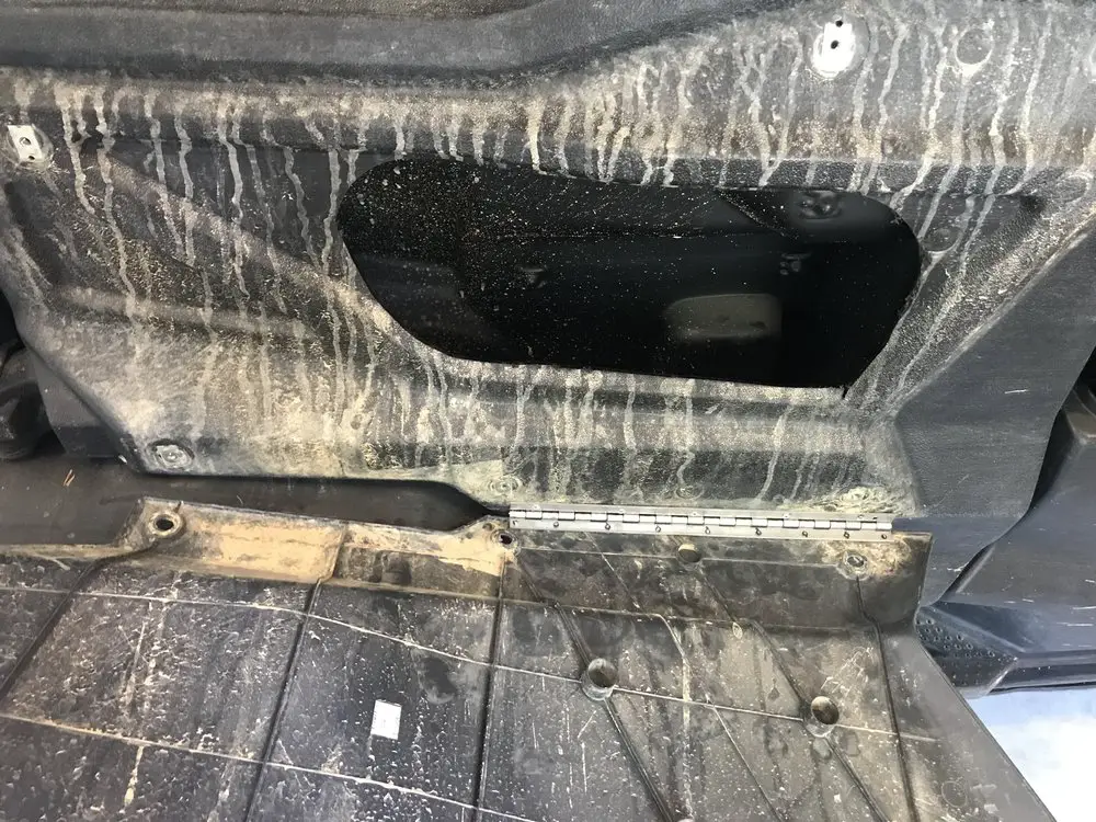

Gotter all done just have to cut the holes... I installed the tansky pins in all screw locations but only use the corner pins, the other middle two just for looks. Is anyone finding you get much water inside from rain, washing, etc.?
Just wondering if I should try to cut it out nice, hinge it and use the piece to make a door to seal up from the elements.
Or just say screw it and put everything in dry bags and count on the water going in and drain out the bottom hole.

Dry bags
39,130
Yep, you’re not going to keep the water and dust out easily. Drill a couple half inch drain holes in the bottom of the door and put your items inside dry bags.
Fb8d4b1ef86cd851b44291f3df748adc
Some items like a tire tube and tie rods I just throw in the bottom and not worry about putting in a bag. I put my small air compressor and first aid kit on the top so it doesn’t sit down low enough to get water in the doors if I happen to drive through something too deep
