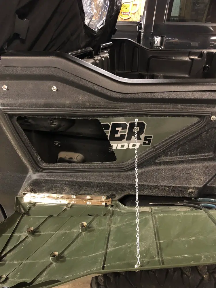

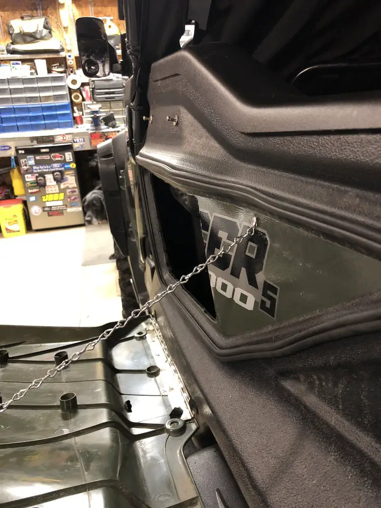

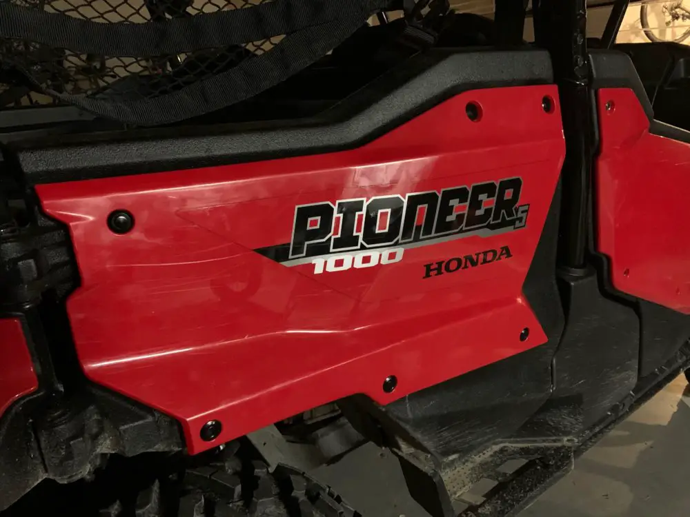

Finally got some time home and finished this project. Well, almost finished. Still waiting on the thumb screws. I’ll do 2-3 per door and that should be enough.
Passenger side panel. If someone cared they could color the rivets.
The drip ledge worked better than I expected for vertically-inclined fluids. It's now been in the rain several times. Also seemed to function during the hose-downs. Pressure washer is a different story, and so far untested, but all probably depends on the angle of attack.
Whatever gets over the top of the panel (at low speed) tends to run down the inside of the hinged panel instead of running down the blow-molded storage area. The hinge has mud on it (most likely came in thru the front), but the storage contents stayed clean and dry.
I increased the bend in the threshhold a bit where the panel sets out the furthest, in this case the corner above the double E in Pioneer, but this varies with each install.
The longer strip at the lower part of the door top was cut in width by about a quarter inch, and the adjacent angled strip was tapered to match at the miter joint.
I'm a "form follows function" guy, so if it works, it looks good to me.

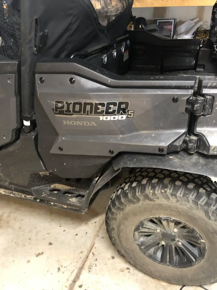

I did my rear door storage a little different. I cut the hole opening on the inside of the door and used a heavy vinyl cover with snaps. I installed the snaps on the door with #6 bolts with nylock nuts. I first cut a small hole to my hand in and get the snaps in place, then I enlarged the hole out tot he snaps. I forgot to take a new photo with the larger hole but it ends up being about 6 inches square. $30 to have both door vinyls made. This could be done with all levels of pioneers.IMG 1720 IMG 1722

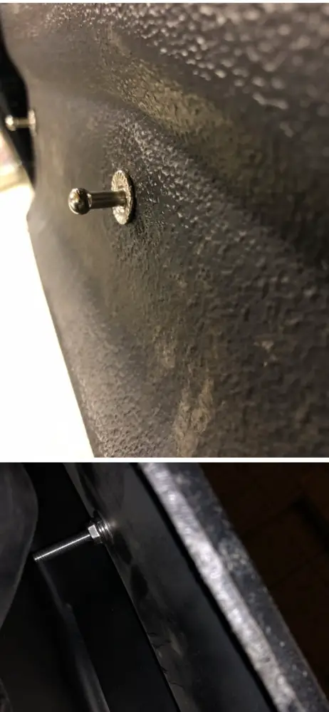

You can see the top pic, I had to reverse the nut so your outer sunk to the body. The bottom pic is the inside with the other nut used as a jam nut to keep things sucurred

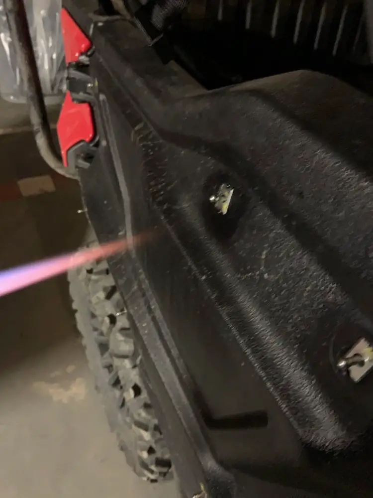

Thank you all for your R&D on this! The only thing I can contribute is that I didn't like how the posts didn't line up super smooth. I took a torch and gently melted the plastic, then massaged all the bases to line up. Now my cover snaps in like a DREAM! Once everything is all heated up and soft, snap the cover on and let it cool. Do not rush this... I even pushed a few posts deeper into the door to make the cover fit more flush. Now it's just a snap-snap-snap-snap with no struggles.

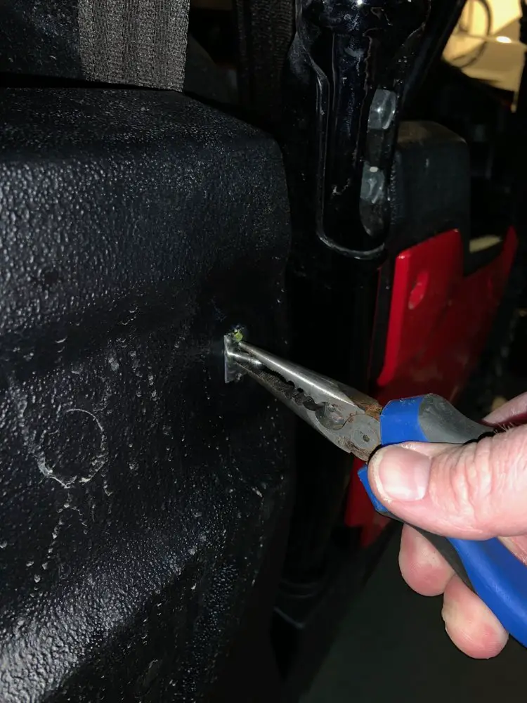

I also didn’t like how they lined up but the studs will bend fairly easily using a pair of pliers. I’m sure melting the plastic worked just as good.
