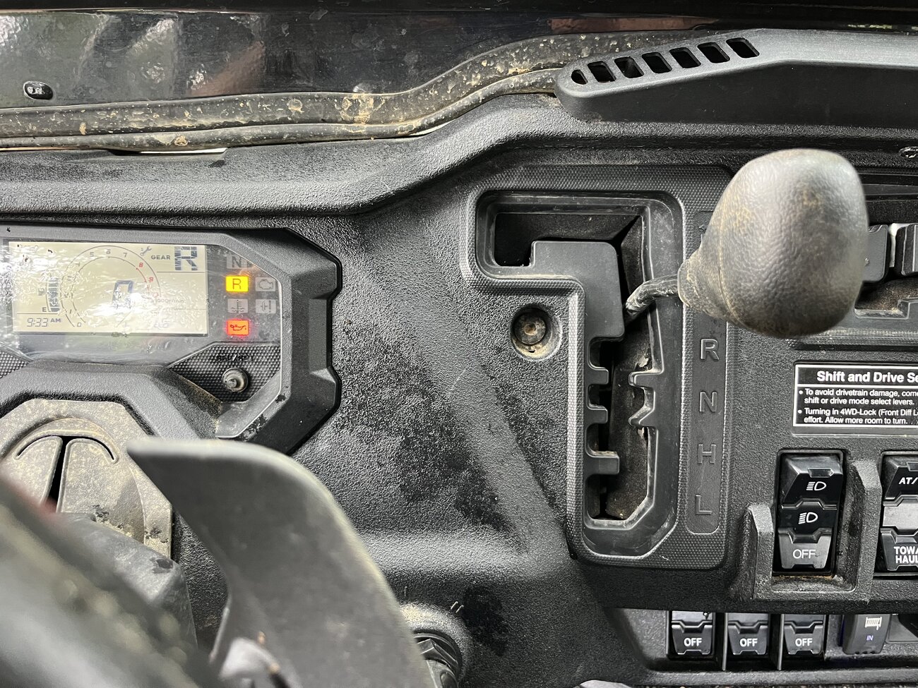

Swampmonkey Active Member Jan 17, 2019 154 154 43 Al Ownership 1000-5 Saturday at 10:28 AM #1 Guys, I have an issue with a 1000-6 PRNDL shifter being out of sync with shifter indicator slots. Any suggestions on a fix?

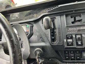

Swampmonkey Active Member Jan 17, 2019 154 154 43 Al Ownership 1000-5 Saturday at 10:29 AM #2 Example.
Hello_Darkness Well-Known Member Jun 6, 2024 677 2,746 93 Just to the right of nowhere Ownership Do not currently own Saturday at 11:16 AM #3 Will it go into low?

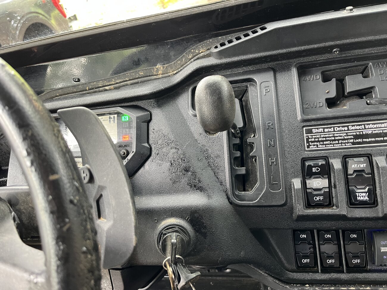

Swampmonkey Active Member Jan 17, 2019 154 154 43 Al Ownership 1000-5 Saturday at 11:19 AM #4 All the gears work. Shifter just isnt lining up.
Swampmonkey Active Member Jan 17, 2019 154 154 43 Al Ownership 1000-5 Saturday at 11:23 AM #5 Low works, but in low shifter is in the high slot.
ODAMO Well-Known Member Oct 12, 2018 1,396 3,672 113 Ohio Ownership 1000-3 Saturday at 2:11 PM #6 Under normal circumstances you would put it in neutral and then adjust the thimble at the sub trans until the shift handle on the dash drops into the N slot. Tighten her down with the handle in the middle of the N slot. Reactions: Smitty335
Swampmonkey Active Member Jan 17, 2019 154 154 43 Al Ownership 1000-5 Saturday at 3:30 PM #7 Figured it out. Shifter adjustment under the battery. Just not sure hiw it came out of adjustment. Reactions: WagginTail, RacinJasonWV, Smitty335 and 1 other person
