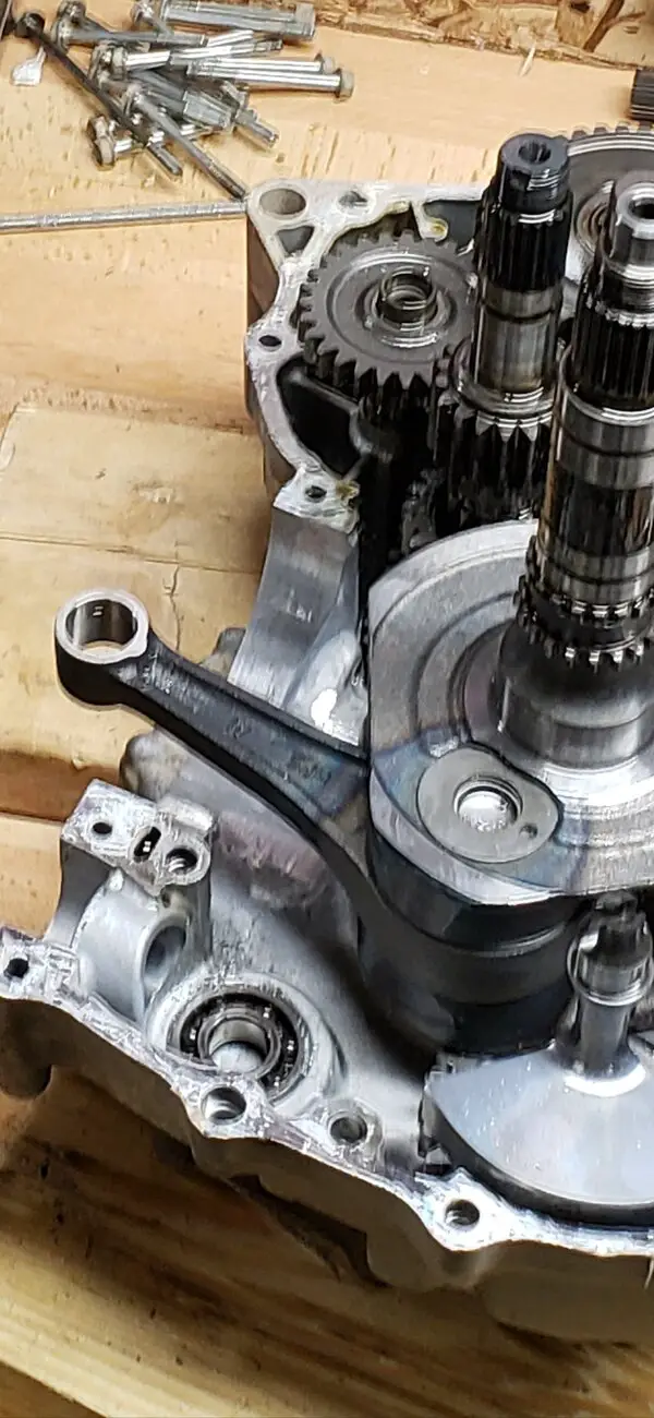

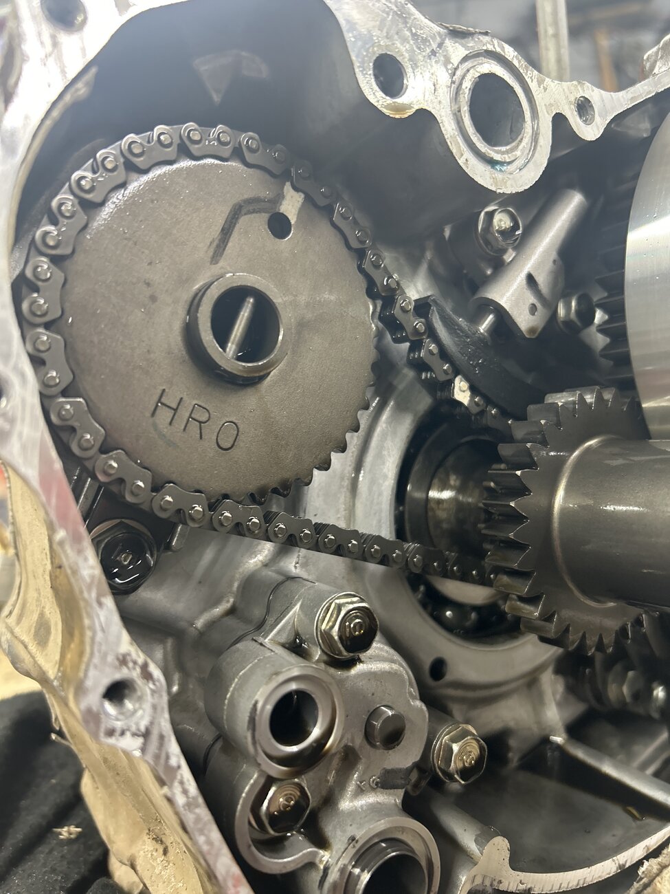

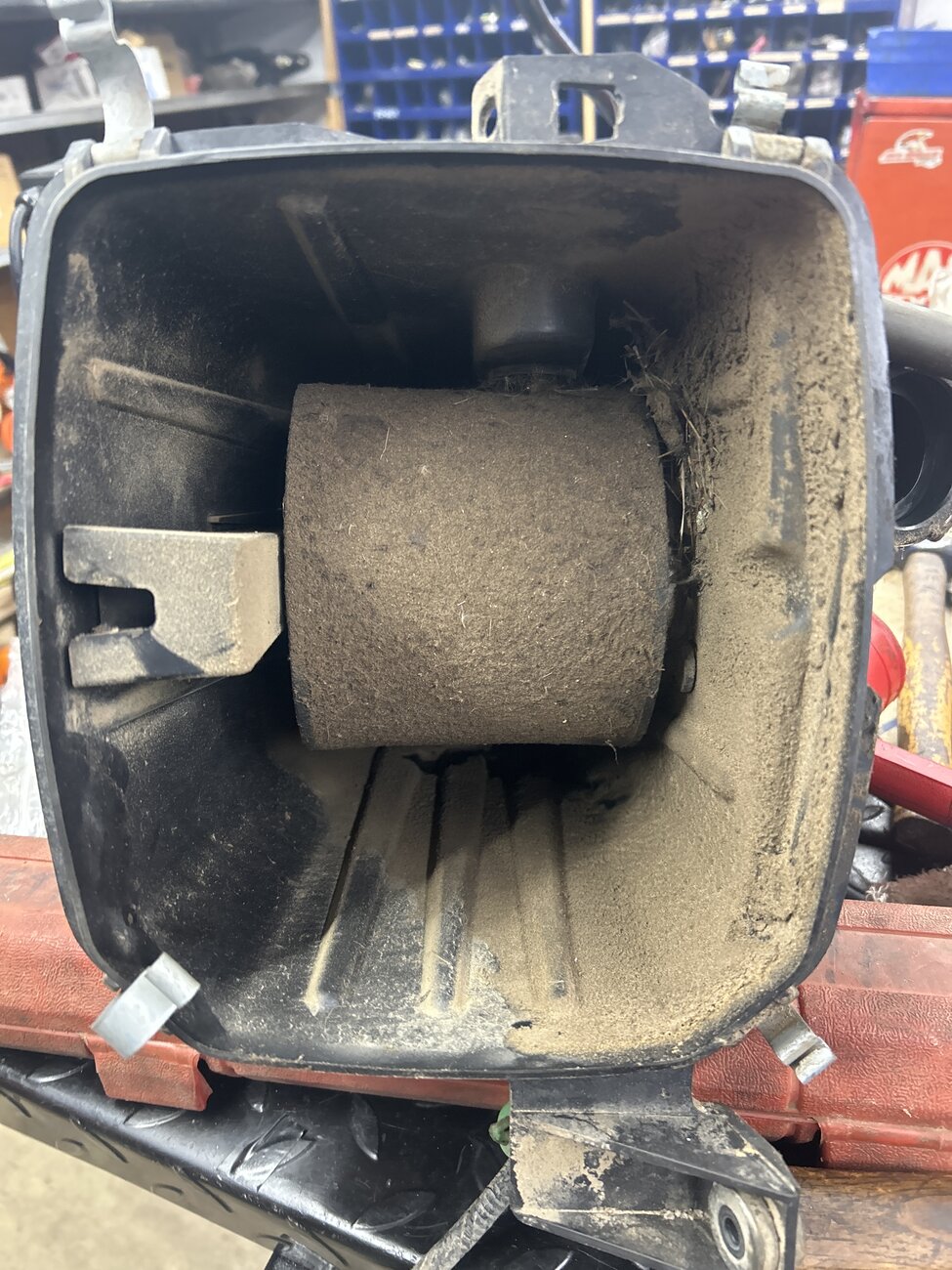

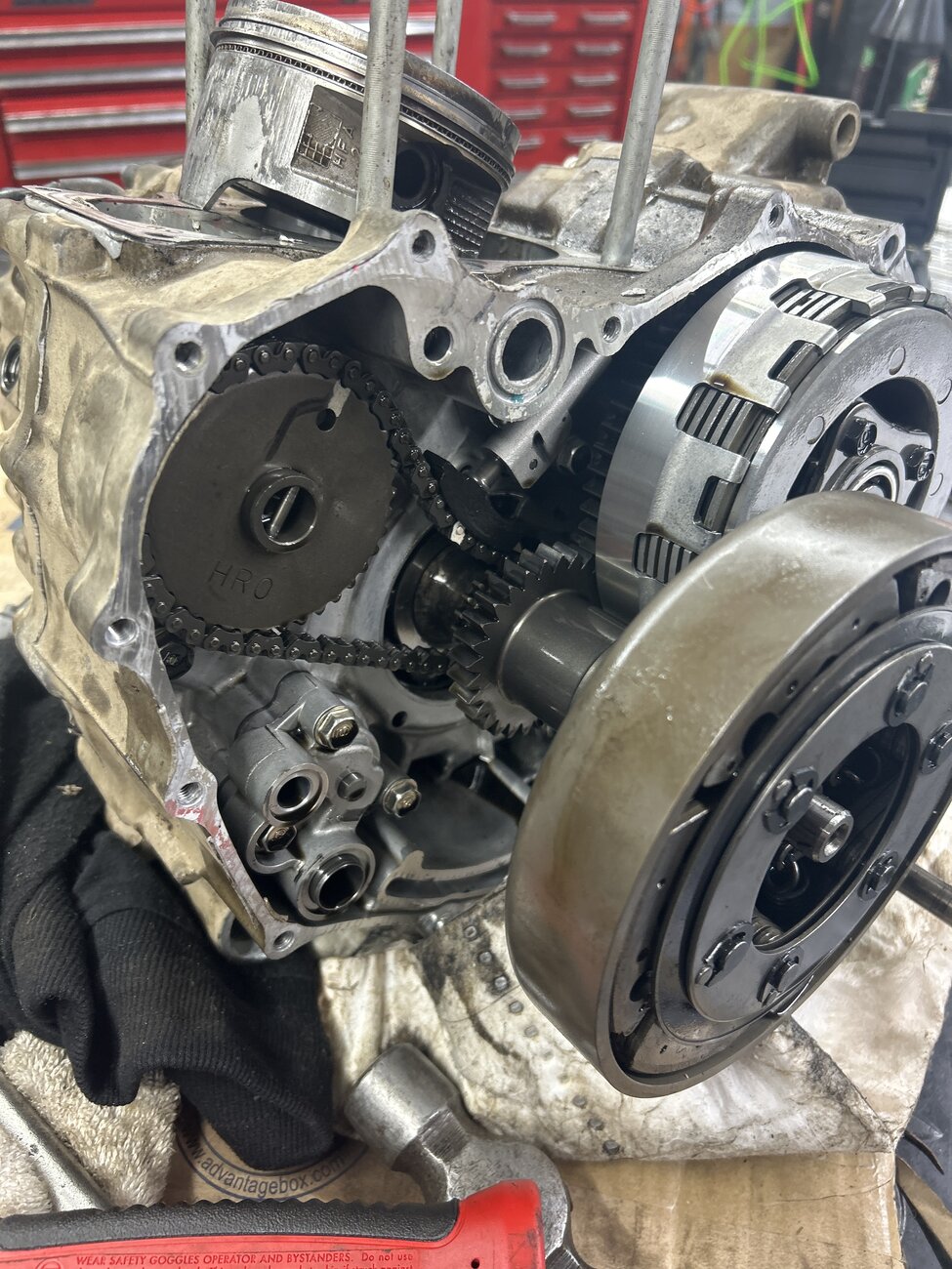

Engine is out. Started to remove and bag and tag inspect. I’m stuck now on the front with removing the cluch basket waiting for my 35x1 puller, trying to utilize the pullers I have but not working out. Here’s some pics from behind front cover, closest machine shop is 2.5 hours away. Think I’ll take the crank/rod to them to measure wear. Searching bottom end rebuild kits bearings . Top end jug and slug. Aftermarket or stock what’s your 2 cents?

Wow, that airbox is hit!

I'm leaning towards oil starvation.....pump failure, low oil, deteriorated oil sorta thing. Regardless it'll need a crank, I don't think the rod is a serviceable part, add all bearings due to oil starvation :oops:
Might want to start looking at a reman engine, probably cheaper in the long run

$80 abs 2” pipe, 90’s, couplers for snorkle kit. So this hopefully never happens again. Bring fresher air in then by the tire
