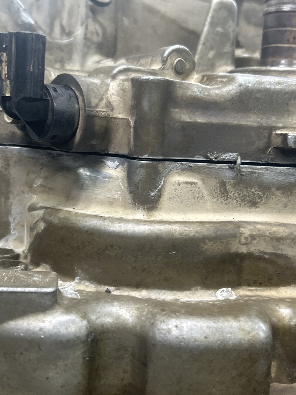

Whoa never seen this before, the area outboard of the crank bearing, oil pump side somthing chowdered this area I’m gunna have to what’s in that area
