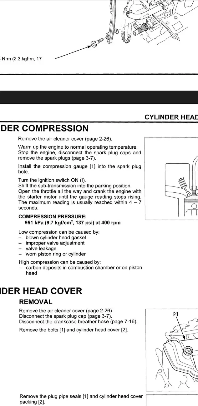

Alright - valve clearance complete. Both intake valves were good and both exhaust valves were tight. I've adjusted these and performed another compression test. With a cold engine the rear cylinder came up to 125 and the forward stayed at 95. I started it up and let it idle for a while but the smoke coming out of the exhaust was too much and I did not let it come to full temp however the engine certainly warmed up. I retested and got 142 on the rear cylinder and about 112 on the forward - I think JMynes might be correct with the fuel washing the oil film.
The plug is wet when I take it out as if its getting TOO MUCH fuel at idle. I checked spark again on both plugs and it looks good.
I tried one other thing that might shed some light on things - as stated, with the engine idling if I pull the rear plug it will sputter a bit and then die but this time I tried giving it just a little gas to bring up the RPMs and pulling the rear plug at the same time. The machine WILL continue to run on the forward cylinder alone if I hold down on the throttle a bit.
Not sure where to go from here...
