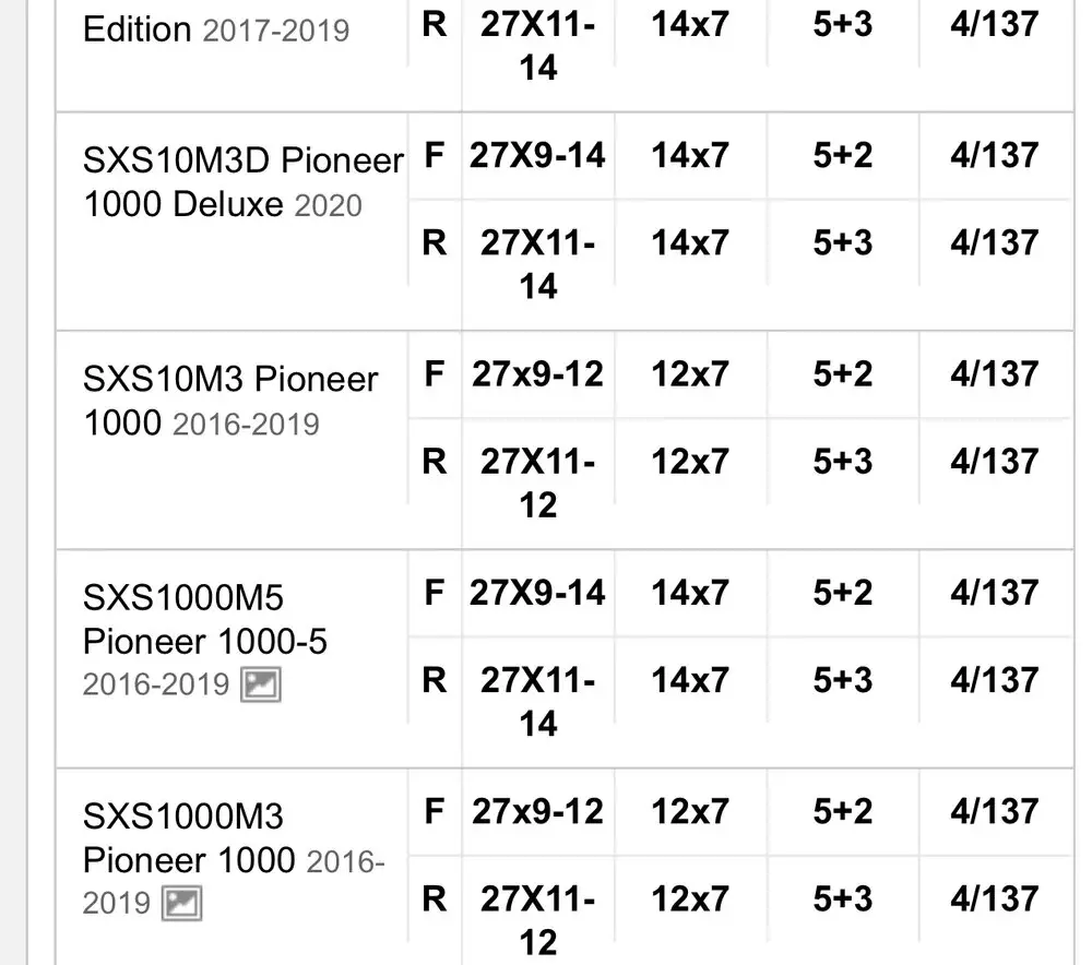

That's all wrong. I cant remember the offset but u have 6.5 inch wide wheels on the front and 8 inch wide wheels on the rear..
Not correct, both rims are 14x7
Now that I look at that chart, I know its wrong because of what it says about the 12 inch wheels. Ive changed them multiple times on 2 machines and almost 10,000 miles between the 2. But I cant state for sure about the 14 inch wheels. I'm 100% sure on the 12s.

Thats just a recommendation chart or something. It's not OEM.
I will know for sure as I just got new tires and will measure the rims once I get tires off. I also found this article about specs on Honda SXS.
That article says the front is 5+2 offset but its a 6.5 inch rim. Math just doesn't work that way. 5+2=7.

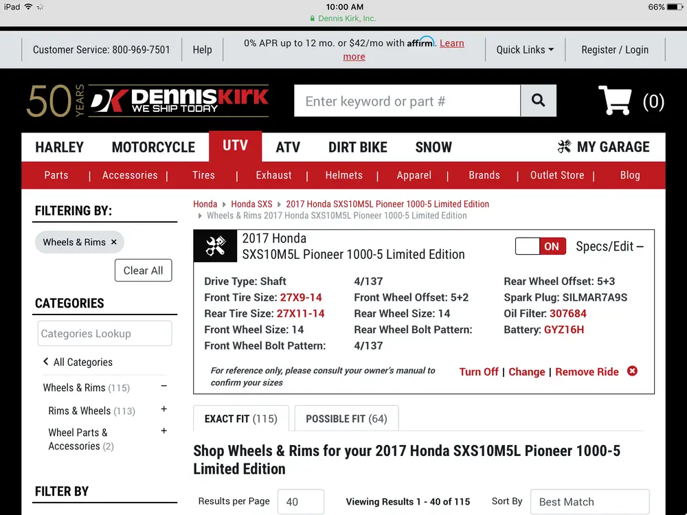

The chart below is my model. This is the stock set up. The LE is different than the other p1000 models.
