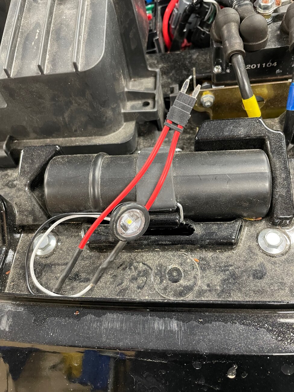

So i thought I would do an update on the headlight situation . I made a "test light" as per Bumperm's Genius idea. Unfortunately i missed the part about using an incandescent bulb. I used an LED which is either always on or always off depending on how you plug it in. so I did it old school with an ohm meter and visual inspection. After reading a post about defective (cheap chinese s***) tail lights I did a closer inspection of the headlight bulbs, sure enough the passenger low beam was shorted! I upgraded to LED headlight bulbs and everything is as it should have been
IMG 8049
8,091
61,024
So i thought I would do an update on the headlight situation . I made a "test light" as per Bumperm's Genius idea. Unfortunately i missed the part about using an incandescent bulb. I used an LED which is either always on or always off depending on how you plug it in. so I did it old school with an ohm meter and visual inspection. After reading a post about defective (cheap chinese s***) tail lights I did a closer inspection of the headlight bulbs, sure enough the passenger low beam was shorted! I upgraded to LED headlight bulbs and everything is as it should have beenView attachment 365477
Glad you got it figured out and posted up the resolution.
Unfortunately, I think we'll see a lot more like this on anything produced in the last couple years.
