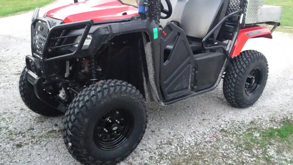

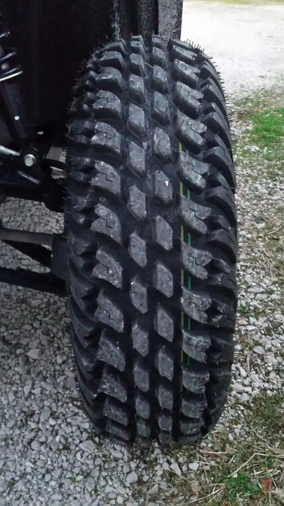

I got the 4-27x9x12 Rage Storm tires on the 500 today. I put them on a set of 5+2 ITP Steel wheels so I can rotate and move to the P700 also.
20170308 190047
20170308 190012
Reactions: trigger

20170308 182335
20170308 182319
I like that setup, however what brand is your bumper/brushguard? Looks like it provides a lot of protection.
Bison bumper front and rear. Both protect well. Front bumper limits you to winch in lower position. I would never be without the rear one. Every 500 needs the rear one and it's that good for 209. I think the rears could use a 1 inch spacer on the rims. Hope this helps
