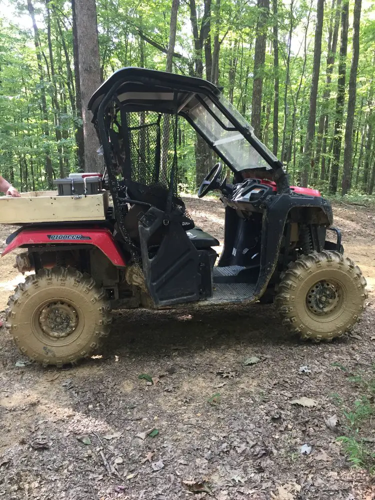

They are @ 28” inflated to 6-7psi.
FYI in your pic of the red 500 the tire tread is backwards. Swap your tires from left to right side. The tread swoops forward for more bite.
I still need to turn my right rear around . The other three are right now. My neighbor mounted these for me. LOL
Cool deal, I didn’t want to sound like a jerk but you’d get a ton more performance out of the tires.
