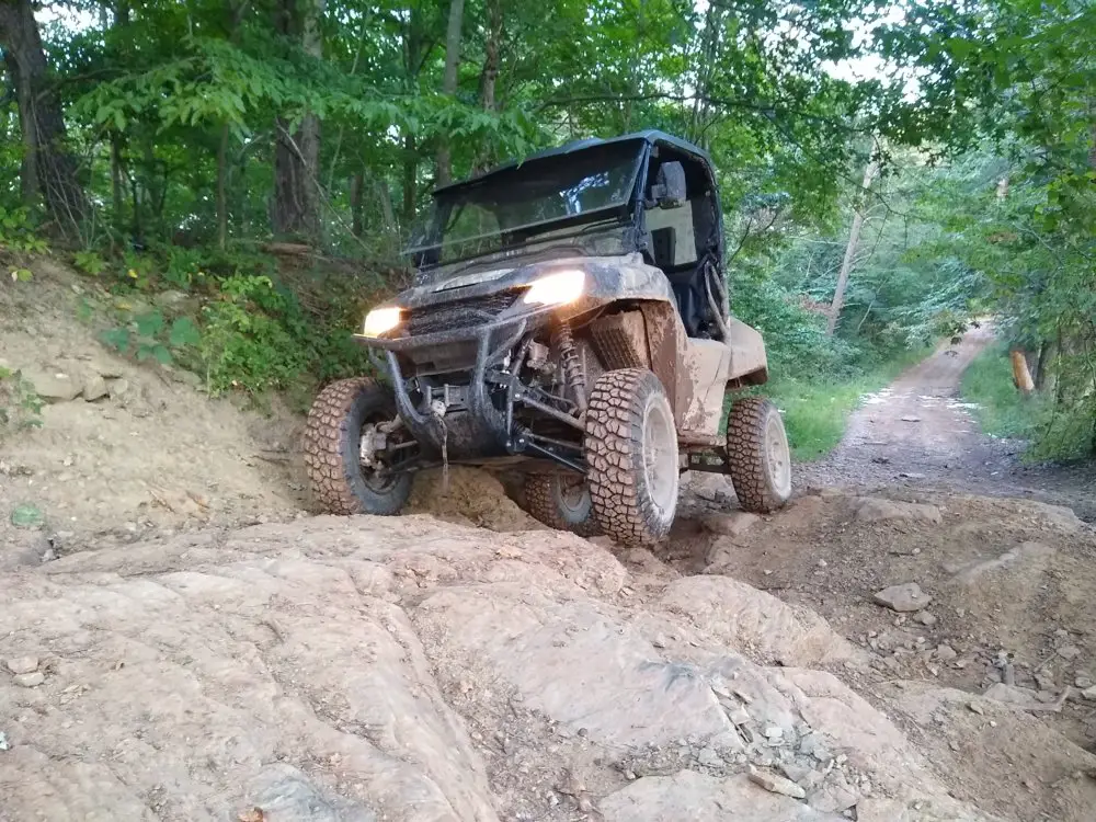

28in BF Goodrich Mud Terrains are awesome! Goes just as good as ever in slop and pavement too

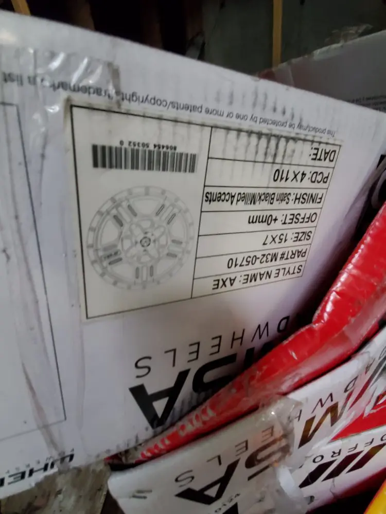

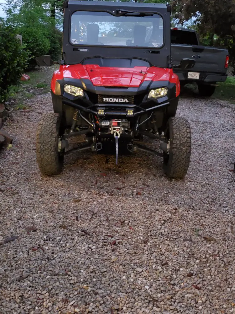

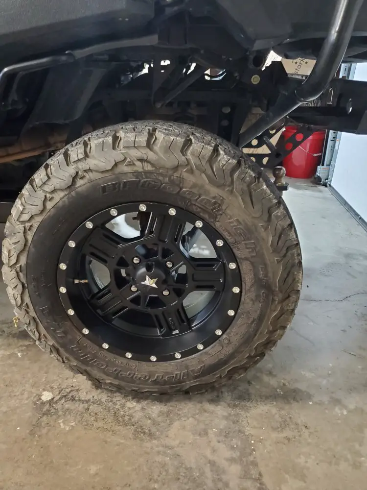

Got the 215/75r15 on tonight. Really like the look but not sure about the performance yet. They're very heavy, I was still able to hit 45 MPH, but also just installed Dobbecks EJK tuner. Without the tuner I'm not sure it would make it to the limiter.
I asked the shop that mounted them to put about 15 pounds in them however I think they're lower- probably less than 10 so thats robbing a little power too. Gonna air them up some tomorrow and see how it goes.....

So just took the 700 for a spin after evening out all the tire pressures and set them all at 20 psi. Its a little higher than I wanted but I just went with what took the majority of sag out of the sidewall and did decent going down blacktop. At the speed limiter it holds right at 46 mph and just guessing the RPM's sound noticeably lower. The speedo reads 42-43 MPH.
