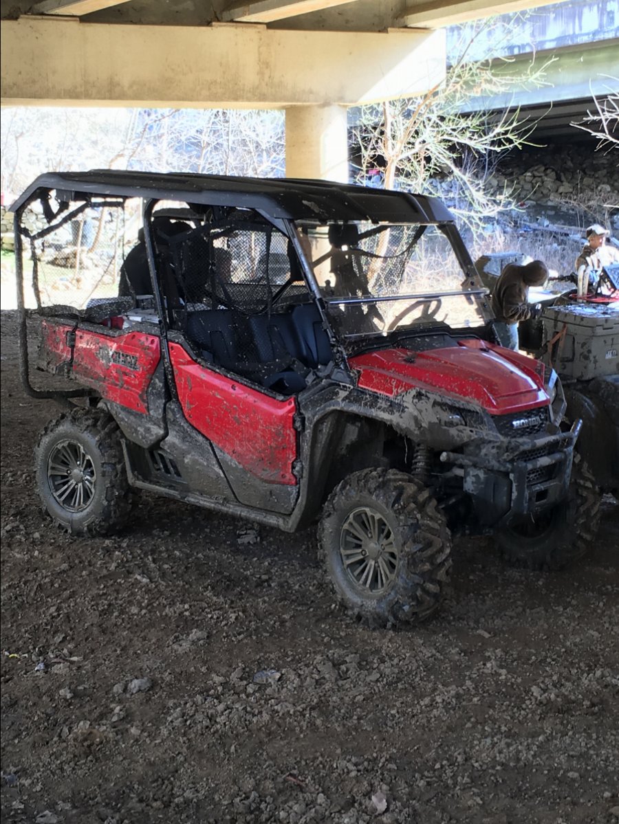

I have 28x10 moto mtcs now and I love them however after this past weekend ride, 30" tall tires are the standard where I am and it's not a matter of keeping up with the jones' and having a monster rig but now a days it seems like you need a taller tire but not necessarily an extreme aggressive tire to cross places that the big boys have trenched out.

I agree 100%. More clearance is typically good. Although the flip side is that taller tires also raise the center of gravity.
If you got stuck, I hope you're sharing pictures... (=
