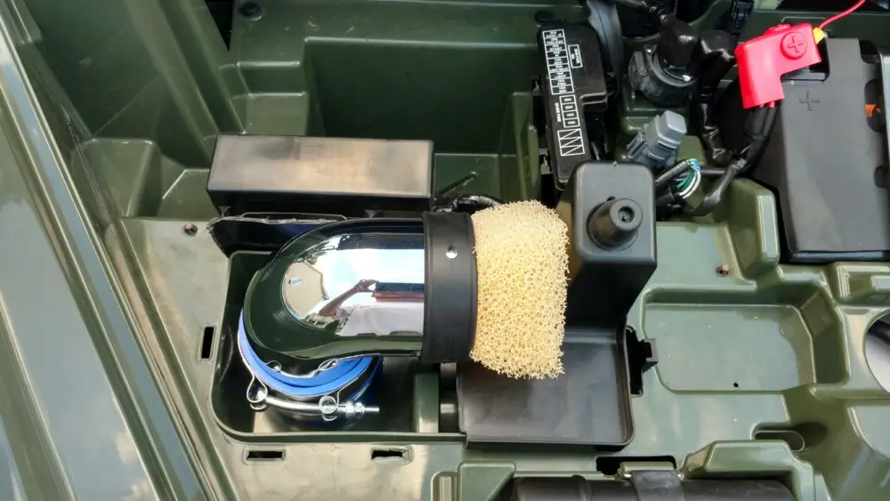

Spectre 3" to 2.5" coupling (Autozone)
Spectre 3" 90 pipe (Autozone)
Standard hose clamps for 3" piping
Retained the pre-filter, hood support, and relay cover. Cut out center portion where coupler and 90 are located.
Used a rubber gasket to slip over the end of the 3" 90 pipe so that I could run screws through it into the pre-filter to keep it vacuum resistant.
